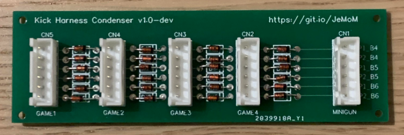

I'm using the Mingun as part of a custom built arcade cabinet and just ordered the 6 board Jamma switcher from RiddledTV to make the world a little easier. In it's final version, the cabinet will house various 1990-era JAMMA cards in addition to a PC with J-PAC card.
Instead of just buying a Mortal Kombat Kick Harness Condenser from RiddledTV I decided to have some fun and built a kick harness condenser based on the same JST-XH connectors (B6B-XH-A(LF)(SN)) as the Minigun. The RiddledTV stuff is priced premium so the cost savings basically let me do a complete test production with parts to spare, and as a bonus this also let me reuse all the adapters I've already created for the Minigun.
I've uploaded the schematics to GitHub if anyone else is interested:
https://github.com/vidarw/open-arcade/tree/master/kick-harness-condenser
My lack of experience with electronics/PCB design has left the following issues unresolved for the moment:
  • Even though the current EDA files works - it uses the wrong package in the specs (a randomly chosen zener diode instead of the intended diode PH1N4148TB)
  • Design reports continuity errors on Gerbern export. Need to get a better understanding of EasyEDA to fix this.
  • BOM needs to be created (basically: 24*PH1N4148TB + 5*B6B-XH-A(LF)(SN))
  • I have not received the Jamma switcher yet, so the design is not battle tested with multiple boards connected.
