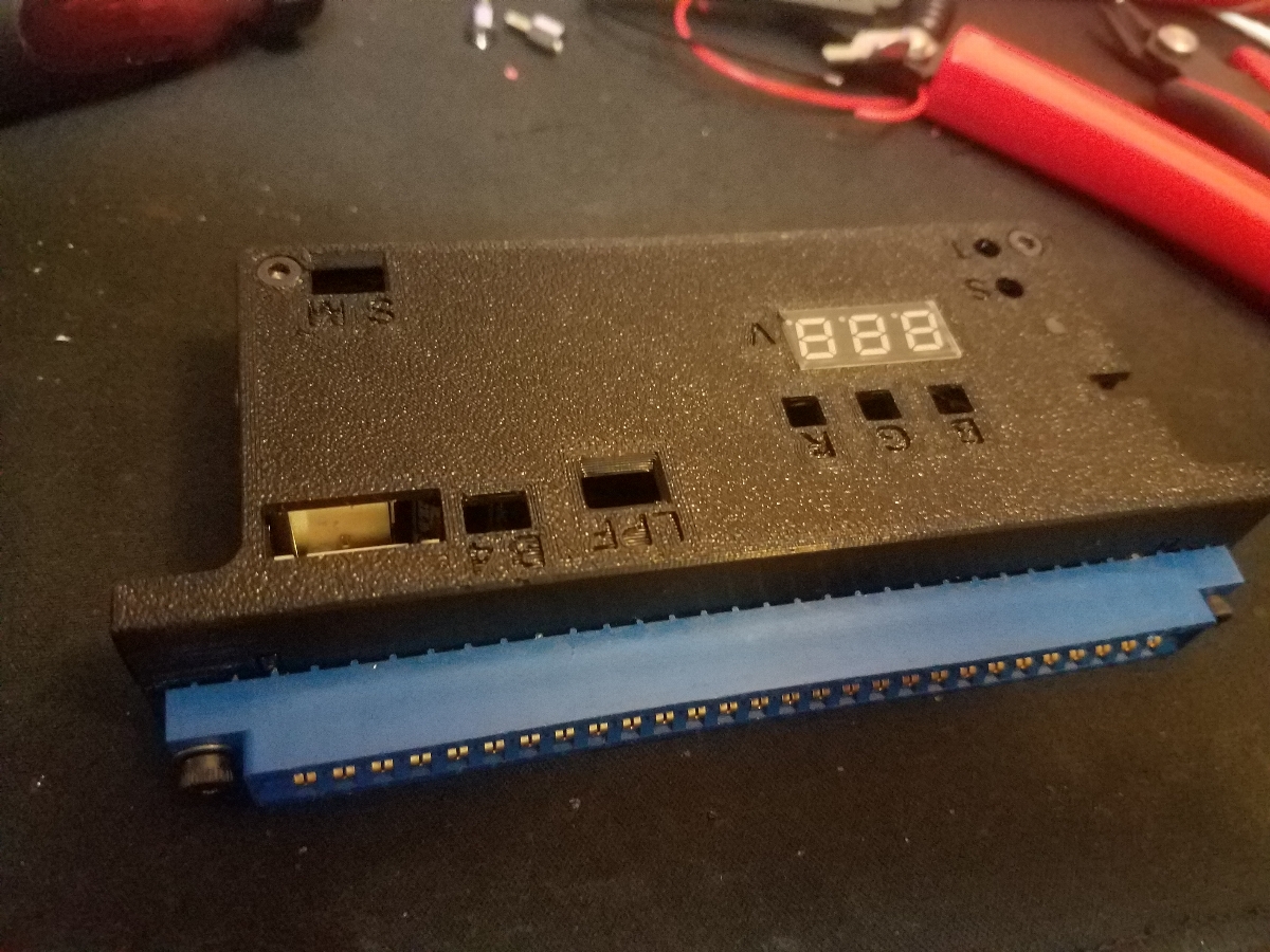

Check out the 3D printed case options. It makes this thing feel solid enough to bludgeon someone with. Chuck it like a ninja star. And it doesn't hurt the hands when inserting it!!
Oooh thanks for the tip! I didn't realize the design had been updated for the current revision.
So I did end up 3D printing a case and you are right. You could club a baby seal with this thing.
