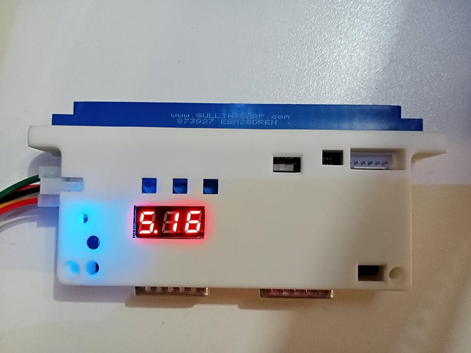

Here is my masterpiece in its bare form. What are capacitors c6 and c7 for, its possible I put them in backwards thats all I can think of.
Every function works fine, sound is great all the buttons work. Just a bit bright. Any ideas?

I guess I am just to impatient and wrote them off too fast. I spent that last 20 min turning them slowly on the mk3 test screen and now it looks pretty decent haha. Thanks for the help guys, it turns out nothing was wrong.
This supergun makes my old one look like a joke it is so tiny and the sound is awesome. My old one didn't have color adjustment I just did that on the monitor.

Edit.. Got the printed case
@Elfoam Might I ask where did you get this case? I’m in need of one for my minigun.
Yes the "no text" one is the case I used. Also I got it printed at JLCPCB, in 6060 resin which is why it turned out so much nicer than a home grade printer.
