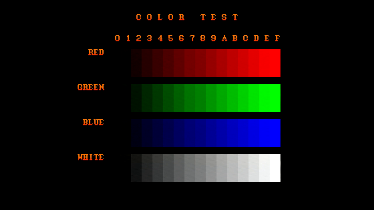

Well that's the thing, possibly because of how it's running to HDMI via the OSSC the colors look great. It's just white that gets washed out. But I'll experiment with the RGB pots.
I use an ossc myself for testing miniguns and can confirm, every time, without fail, powering on for the first time without any adjustments results in too much "brightness"/intensity. The "default" positions fresh out the box have never been good on any of my builds, but heading to color bars and doing some quick tweaking always does the usual magic.

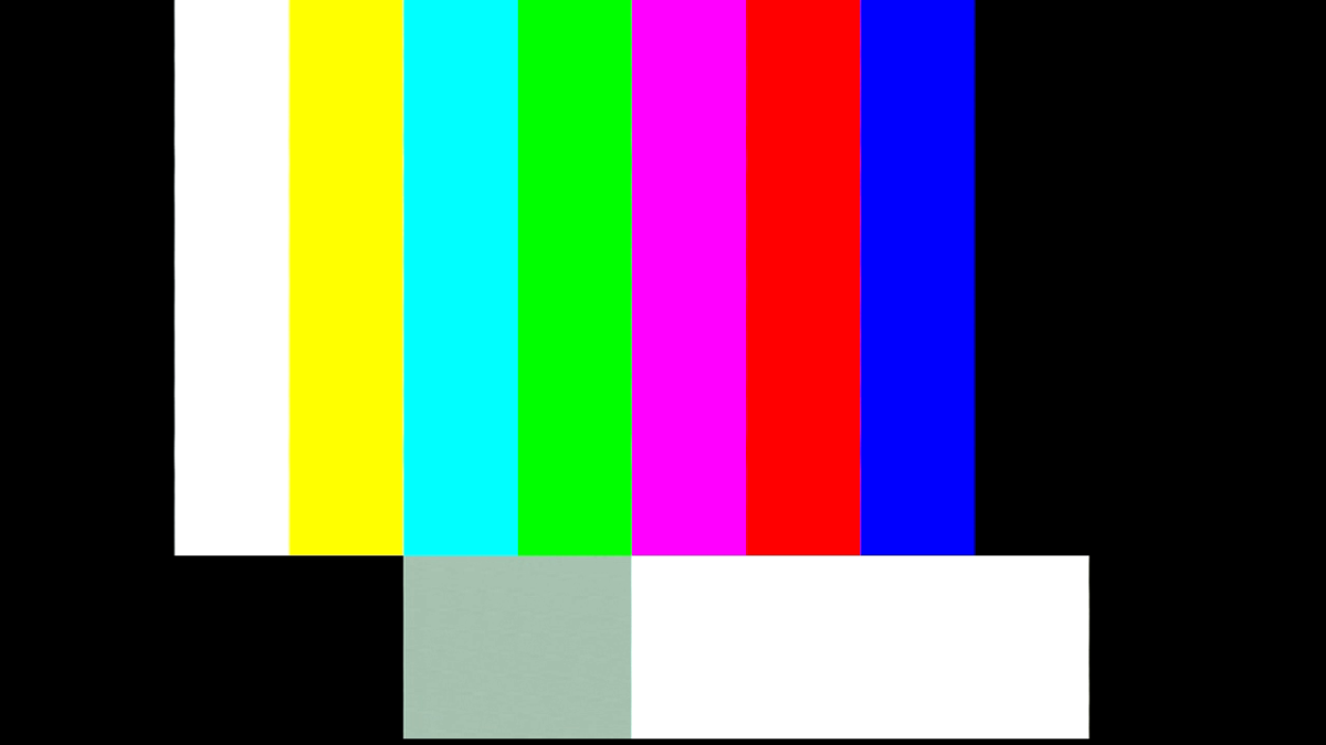

Color bars look OK to me.

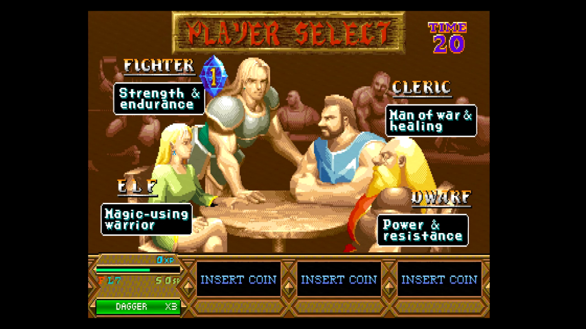

It is very possible that I'm just being overly picky... I only see the problem when there is a LOT of white on screen (opening title for Street Fighter II as an example).
White (brightness) is handled by BLUE and a bit of green. Take your time messing with potentiometers, you will understand.

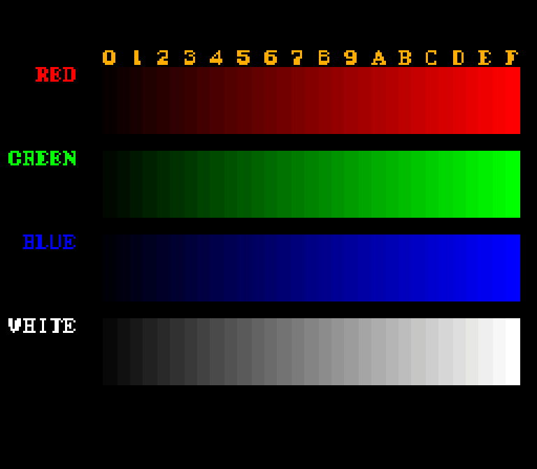

(not my pic just snagged it off google real quick for the example)

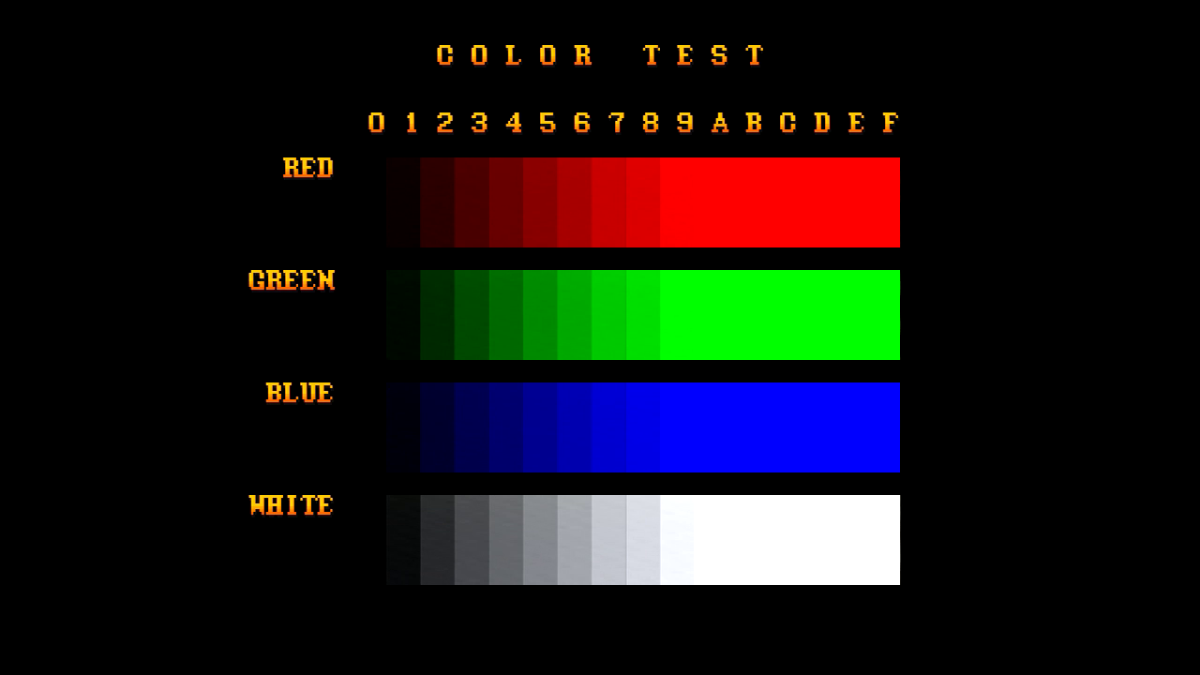

I usually prefer using the color bars found in boards like the cps2/3 where there's a very clear "opacity" scale. On a fresh-install minigun, most of the entire bar(s) will be a solid color; the entire scale appearing how this images rightmost sections are, but after tweaking, the differences between contrasts will be much more clear between every step of the scale (and by extension, "correct").
I was using a dedicated test board, but I'll hook up my CPS2 or CPS3 and see how they look.
Edit: OK, so checked my CPS2 and there is definitely less definition of the colors at the higher values compared to the reference.
Also managed to capture the washed out effect, so I know it's not the LCD. Will work on tweaking the potentiometers this weekend.
For my own reference, current values in kOhms.
R: 0.971
G: 0.943
B: 0.985
Will try turning down to around 0.75kOhms
And fixed: thanks @GeeDee & @Raph_friend
