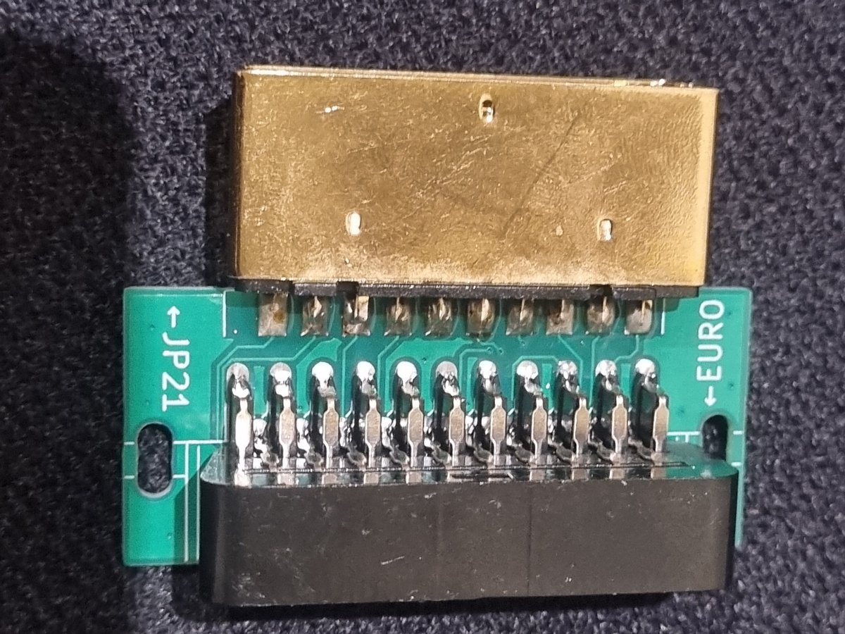

After that last post and a few PMs, an md8 to JP21 was needed. I have had this a few times from people with the minigun, I think one of the upscalers uses JP21. I made a few bidirectional Euro SCART to JP21 adapters and a few of @Frank_fjs md8 to scart adapters. So if anyone is needing one hit me up.

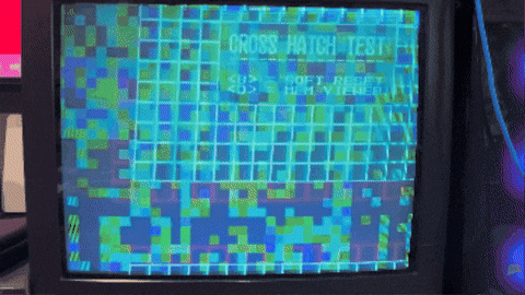

Hi, I've set up the minigun and it's giving me this image. Does anyone know what's wrong? Did I put something wrong? Thanks.
It has no game installed, I turned it on without a game, I have tried it on two mvs and they do the same thing.
I've solved it now. I've put a 150-ohm resistor between the SYNC cable and the SCART connector. Thanks for your time.
That should not be necessary. Which minigun version are you using? What AV cable are you using? What video monitor are you using?
I'm using version 2.5 final minidin 8, the cable I'm using is from a specialist cable store in Spain, I'm using it on an old tube TV, not one of the newer flat-screen TVs.
