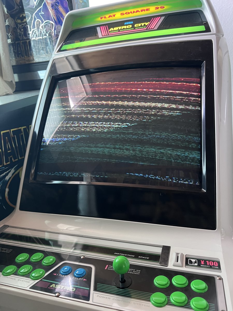

I cant get any type of usable picture from the JT18 core. On my Astro City -> MS-9 29 S.
Tried the core and pressing “+ and -” per the GitHub thread with no change. Might be doing that part wrong.

You got the core that is compiled to support using +/-?
I recall reading it was +/- on a Spanish keyboard. Not sure how that impacts things.
I believe so. I grabbed from the GITHUB page for this issue. I tried shift and non shift to get those characters on my wireless kb. Then plugged into my PC to make sure it was making + -
Didn't seem to change anything for me.
I think he was specific to say the keys at a specific location and he showed where they were on the keyboard.
I might be reading too much into it but odd for him to mention if it's really just plain plus and minus.

I have the wireless keyboard from mister add-ons if that sheds any light into my situation

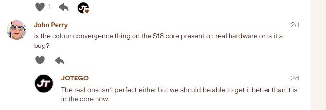

Has anyone seen a solution to fix this System 18 convergence issue?
Was really excited to see the Jotego Moonwalker beta available, played through it today and it's fantastic but I still have this convergence issue going on. Makes the game a bit blurry.
I don't think it's even been acknowledged as a problem.
You can always enable the scaler for analog output and that should allow it to sync. But then it's not like the "real thing". Although (I believe) Jotego thinks the current implementation is how the "real thing" behaves.
Yeah I the games syncing thankfully so they do display and play, Just the convergence itself is a bit off which creates a bit of a hazy effect. I have the same thing happening with all the System-18 games.
They're playable and it's just a niggle really.
Had a bit of a look over on Patreon and it seems he's aware of it so fingers crossed something is amended at some point.

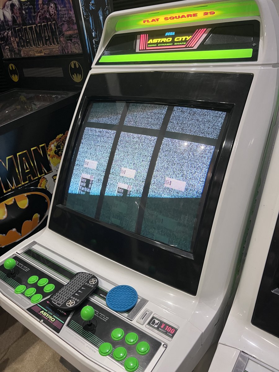

I just got a Mistercade v2 and setup everything and tested on my Astro City but I am getting this image. I tried the same SD card on my Astro City 2 (Mistercade v1) and had no issues.
I’m confused if my Astro city Ms-9 29s supports
15k and I am using the 15khz ini file what am I not doing right?
I always use the horizontal 15khz mister ini file.
Edit : Dropped a Mistercade v2 specific 15khz file on and it worked. Oops.
