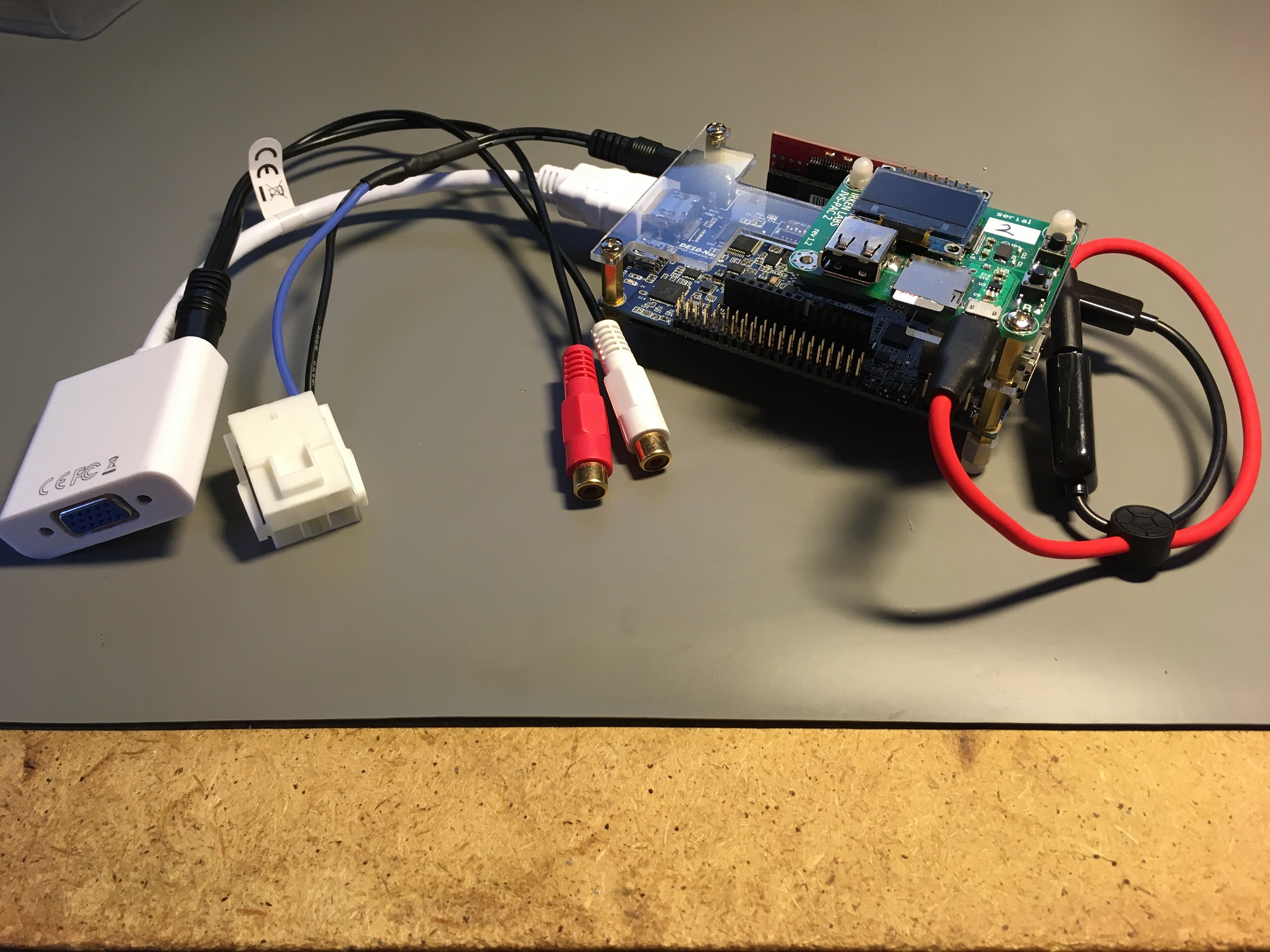

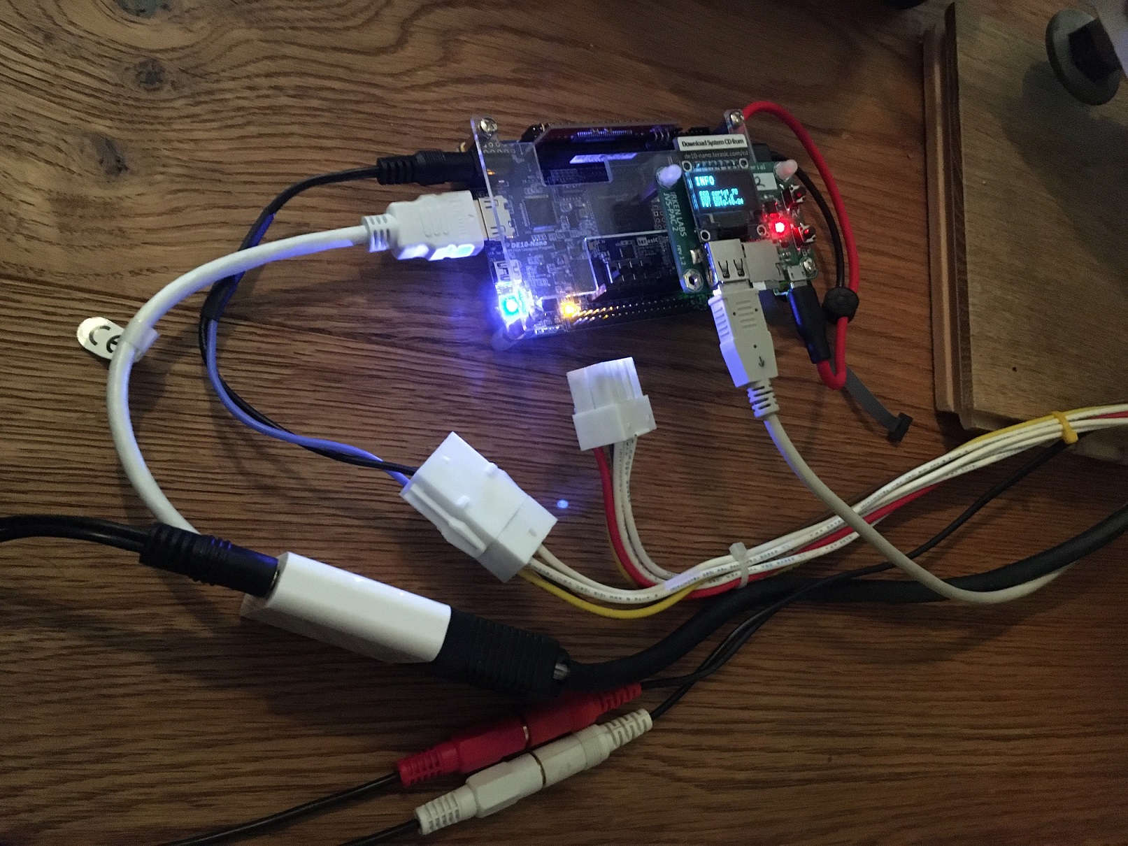

First mister in JVS cab?
Got some parts, fired her up - and it worked :) With current JVS-PAC 2 software, I can select games at boot and as long as the core keys are like MAME it seemed to work ok.
Going to update the firmware on the Mister to see if I can get Street Fighter up and running to test concurrent inputs and stuff like that.
Part numbers for power adapter is
VLR-06V
SVM-61T-P2.0
I didn't have a solder type barrel-jack, so hacked something from the scrap bin.
Glad to see you got it working with the JVS-PAC 2. I tried a few weeks ago and couldn’t get it to work. I’ll give it another shot.

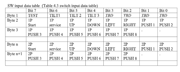

I may be missing some stuff, finally got SF2 up and running - with a normal keyboard at my desk. Buttons 4,5 &6 are not mame defaults it seems, when I go F12 to define buttons, I'm only asked about player 1...?!
Edit: think I'm putting the mister back in the box again :)
The input system of Mister seems inherently broken for arcade boards, there is a hack in place for arcadeSD that does something based on USB-ID.
MY advice to clean up all this would be to ditch the 'virtual game-pad' idea with some physical input device -> game-pad emulation -> translate that to whatever the fpga core wants and rather learn from JVS, which should support pretty much every odd arcade scenario when it comes to input (rotary, analog, keyboard etc etc).
Please correct me if I got it wrong
edit again: OR just make it behave like MAME in the first place.
This is perhaps a MiSTer issue then as I had the same issue with a Jpac only seeing player 1
I guess its looking for 2 usb devices being plugged in for 2 players.
