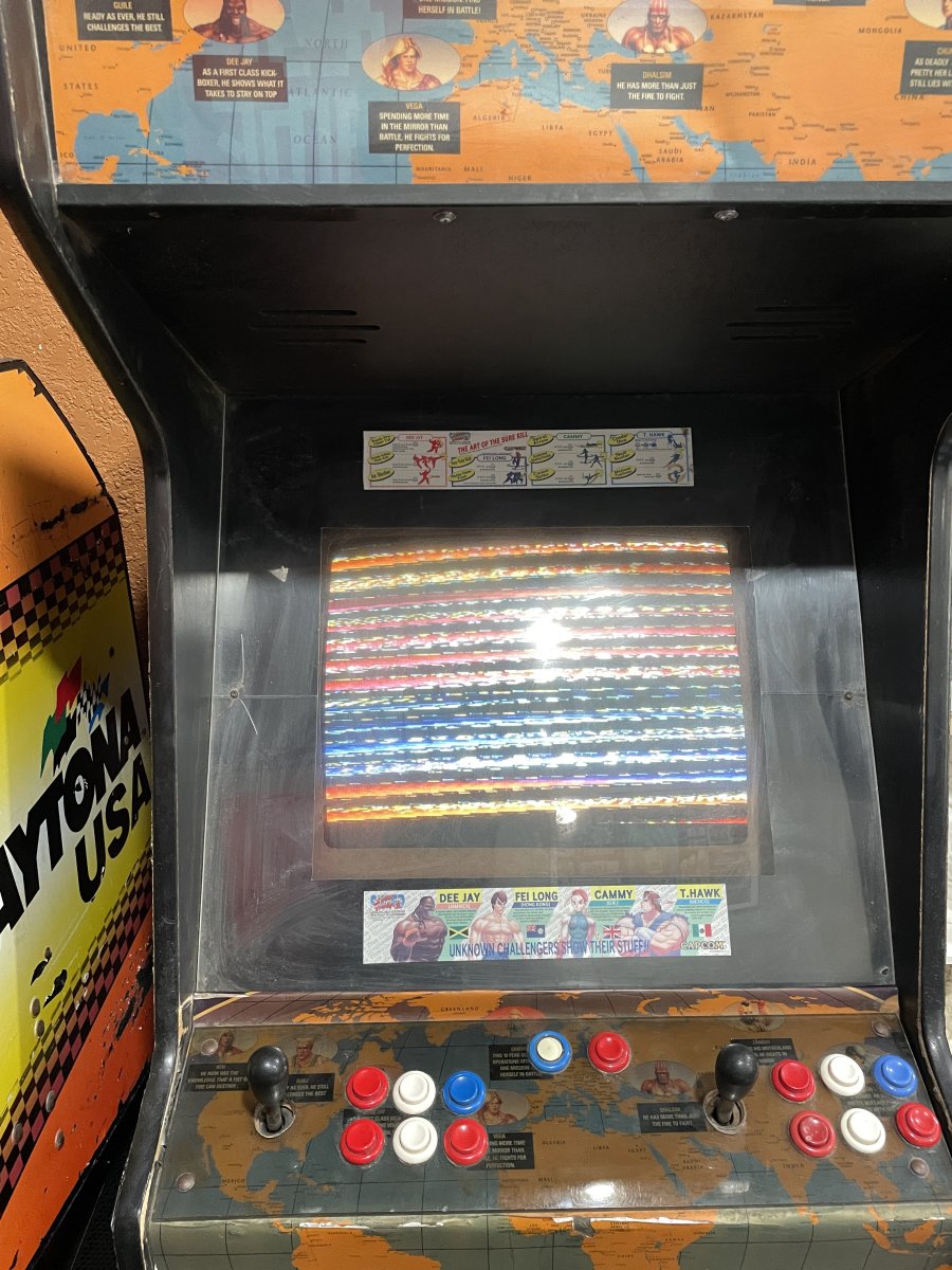

Not sure if this is the place for this. But anytime I run any Cave game, my monitor goes distorted and I only see lines, sound is fine, i can kind of make out enough to bring up the OSD and exit. But it seems to be only the cave core. any ideas?
Analog video or HDMI? I found that if I change the core settings to run vertical on a horizontal monitor the analog video becomes distorted (but appears correctly with HDMI).
Can you post a photo of what it looks like?
Never had any issues running the Cave cores through Mistercade. What monitor is it?
Monitor is a WG 19 K7000 (19k7610)
Okay, so this part
sounds like your problem. Those lines are evidence of a sync issue, you're trying to run the game in a way that monitor doesn't support. Stop trying to rotate it and I'm sure it will look fine, just sideways.
