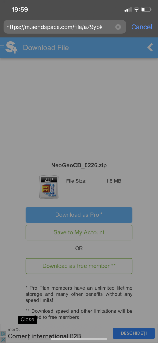

Rbf + MiSTer ini are here : https://www.sendspace.com/file/a79ybk
Bios is here : https://github.com/Abdess/retroarch_system/blob/libretro/SNK - NeoGeo CD/top-sp1.bin

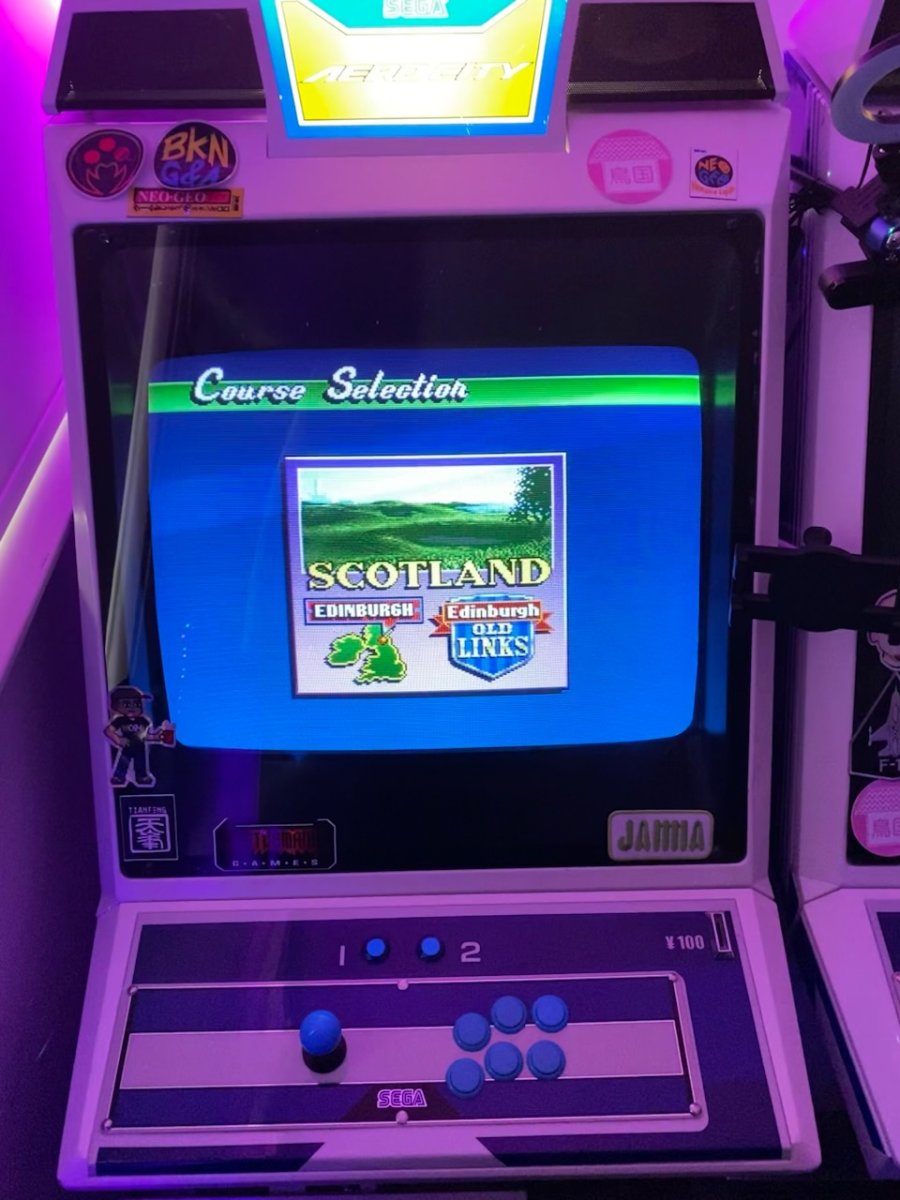

Thanks for the heads-up! I was able to get this going. Finally able to play Scotland in Neo Turf Masters!

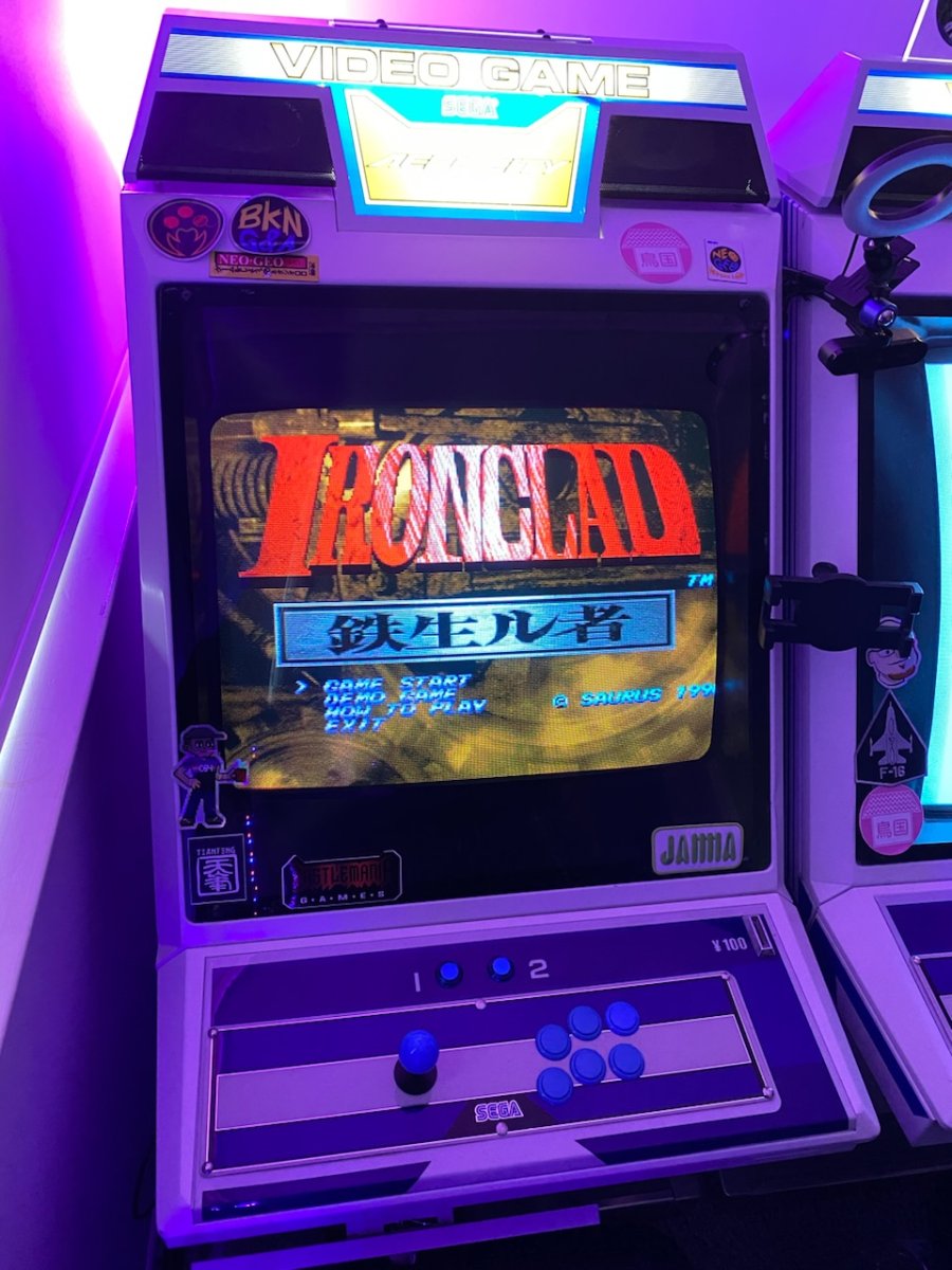

Also first time playing Ironclad.
