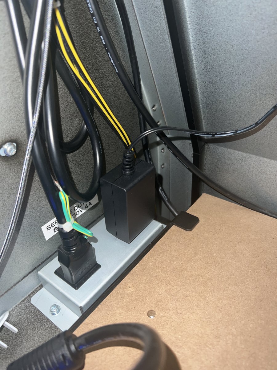

Does the mister accept 100 volts?
Im putting a mister on my vewlix which has a step down so the vewlix is running japan 100Volt. if i plug in the mister power supply inside the vewlix is that safe?
