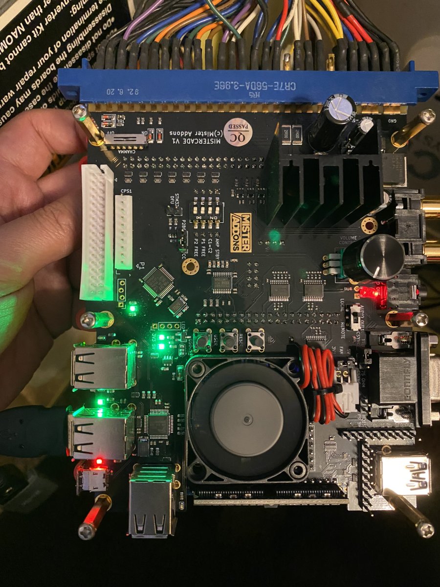

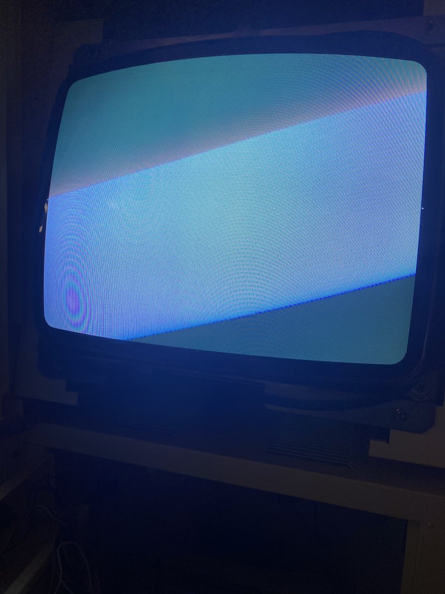

Finally had time to setup my second Mistercade. Second one is getting a blank white screen on bootup when connected to Jamma.
M1 = Mistercade 1
M2 = Mistercade 2
Using only one cab. 15khz Yoko
Everything is identical on the Mister SD Card setup
M1 = Works flawlessly
M2 = White screen on bootup. Noticed a couple LED lights on board are not lit.
M1 and M2 both work with Standard Mister ini file via HDMI
M1: FUNCTIONAL
M2: NOT FUNCTIONAL. Notice the following lights not lit up. What is the expected behavior these two led indicators are telling us?
EDIT: Left LED's correspond to USB and the right red LED is the optical indicator.
Any ideas? @misteraddons
EDIT: Tried on a HAS 4.1 Supergun sa well with the same results.
-RESOLVED- See Link: https://www.arcade-projects.com/thr...e-mister-for-jamma-cabinets.19382/post-309911

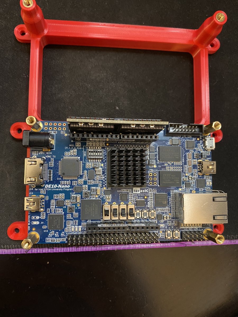

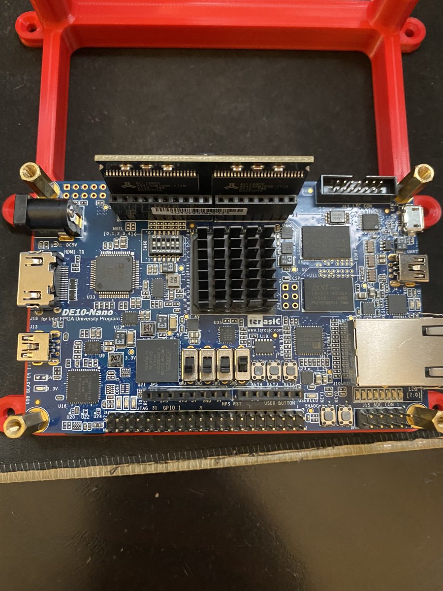

UPDATE!
She works! Thanks to @misteraddons for taking time to walk me through a few things.
Basic troubleshooting we took was swapping out SD cards, DE10Nano, and check switches. My issue was a bonehead move on my part. i had the wrong switch enabled on my DE10Nano...
Which switch was it!?!
It was this: I had the left switch flipped causing a white screen on my cab. DONT DO THIS! 🤣
It should be this: The correct switch to flip is the right switch for analog audio.
