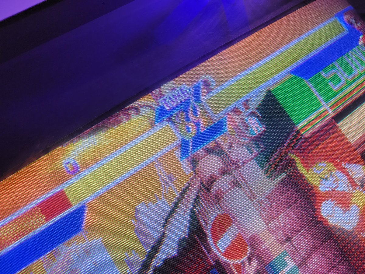

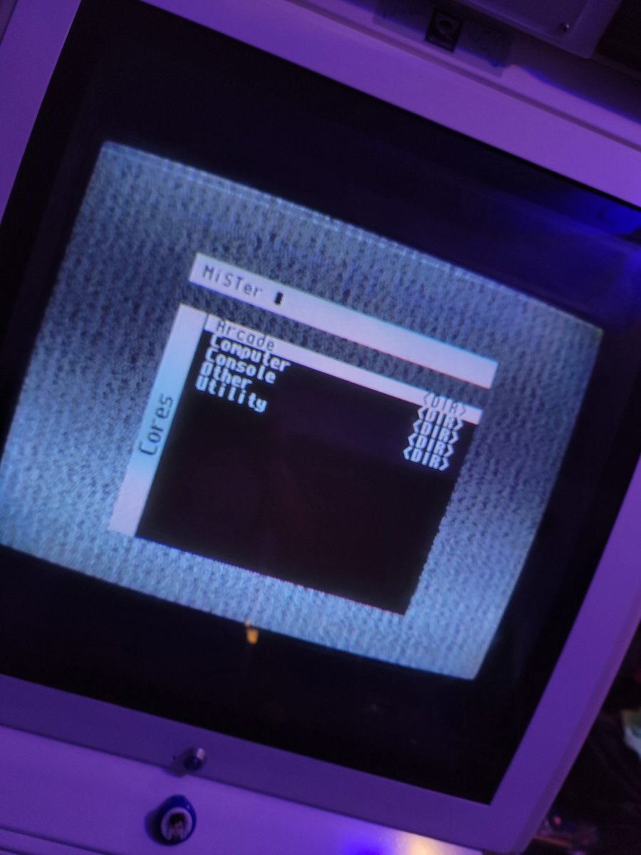

I'm having a similar issue with the Mistercade. When I run it on my Astro City, I have no issues but when I run in on my Capcom Q25, then colors and brightness are off and whenever I try to load a game the Mister resets back to the menus screen.
Mainly got the mister to run in my Q25 so I'm pretty bummed tbh.

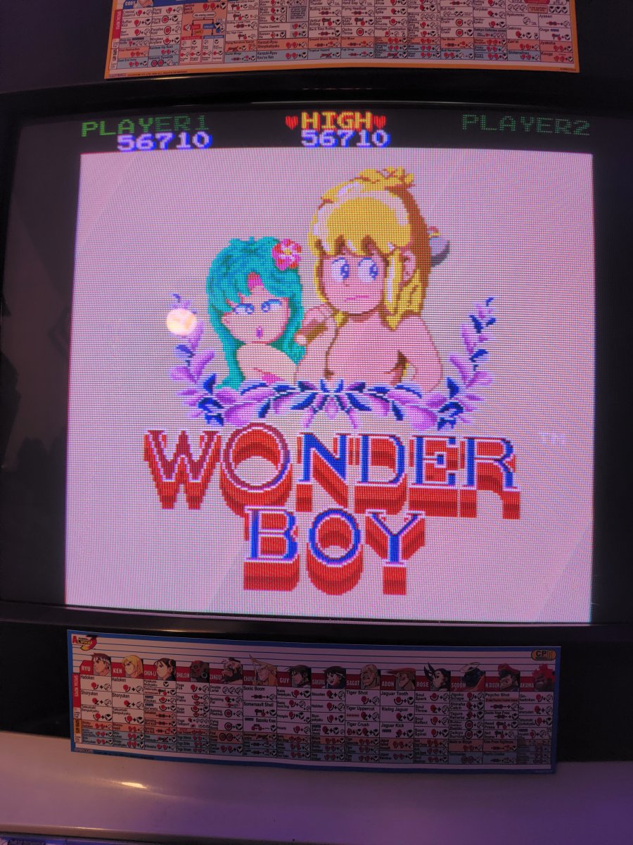

Alright so my voltages look good. 5v give or take .1 or .2 and same with the 12v. Pretty normal so I'm almost certain it's not the power supply (but I could be wrong).
I'm thinking it might be a monitor issue. I've attached some pics. The main thing is that the whites "flicker" as in they get bright as heck then back to normal then bright as heck then back to normal really quickly.
Also, I don't think the games are actually resetting... It seems like the video signal just gets lost from the mistercade to the monitor after being on for more than like 4/5 minutes.
Finally, I hear a high pitched whine when I plug in the mistercade to my q25.
On a positive note, the q works perfectly fine when I plug up any original hardware cps2 game afterward. Also, the mistercade works perfectly on my AstrobCity (See Wonder Boy pic).
Sorry for the long post and any advice is appreciated!
Do you still get sound when that happens?
When I was having reset issues it was literally resetting, if you watched the 12v it would drop to 0 briefly and the core would reboot.
Ahhh!!! I actually get no sound on my Q! I got lazy and just tested the voltage the the mister are unplugged. I'll check again.
