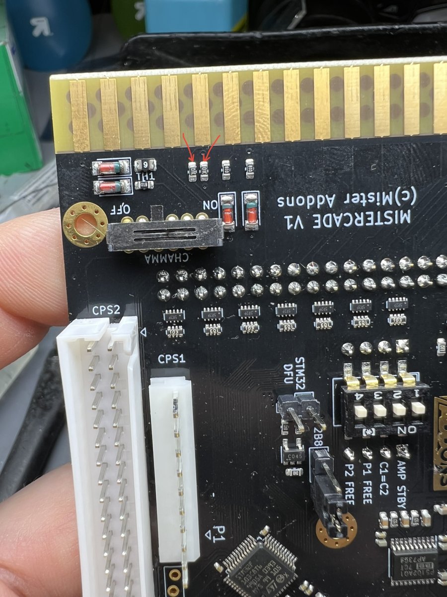

PSA: If you want to run the MiSTercade in a switcher, you may need to replace 2 resistors for the controls to work. I added protection for users who plug in their JAMMA adapter backwards, but that puts extra attenuation on P1B3 and P2B3 lines. I'm attaching a pic of the 0603 package resistors (red arrows) that need to be replaced with lower value ones. You can try slightly lower values or go whole hog with 0 ohm resistors/wire. The user would be responsible for this mod and it's consequences (especially if they subsequently plug in the JAMMA harness upside-down :)
