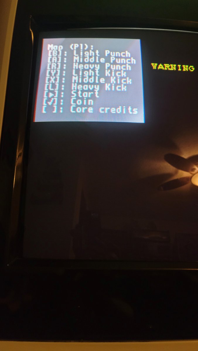

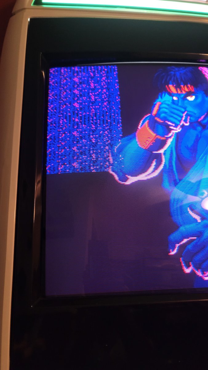

Just got this mistercade 1.1 version second hand and it works great, however I noticed super turbo has this strange graphic glitch that stays throughout the game. It doesn't go away. I've tried several versions/regions of ST. I feel like I've read about this before but I couldn't find any info on it.
Also when loading a core it shows a button mapping overlay. Picture attached. How do I stop it from showing up?

Are you booting to Super Turbo as soon as you bootup the MisterCade and/or using the bootcore/lastcore function? I ran into the same issue when using lastcore and having the timeout set to the default. Setting it to 30 seconds fixed it. For whatever reason Mister seems to need a little time to "warm up" before loading the Super Turbo core. If you haven't, try waiting a good 30 seconds before loading the ST core.
