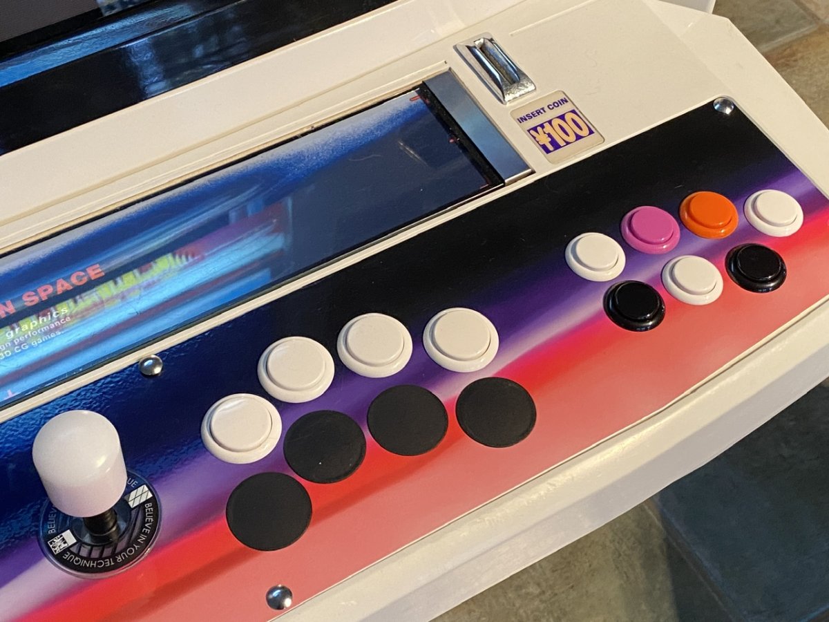

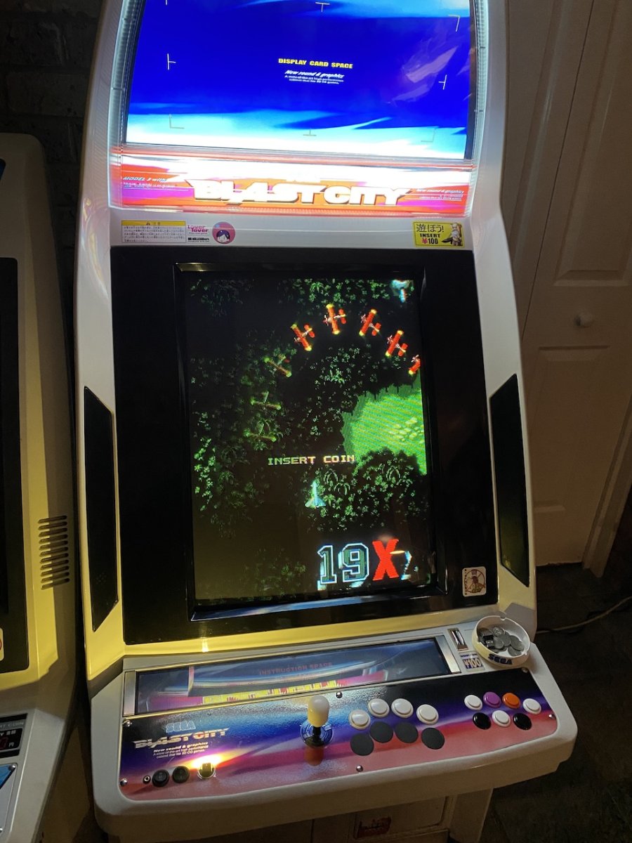

I’ve already posted details in the projects thread but just a quick couple of pics here to show a use case for the @misteraddons admin board. I repurposed a versus city board by adding extra button holes. The admin board supports menu (OSD), pause, core reset and reset. They’re the 24mm buttons on the top. Then using the available player two buttons (as it’s a one player panel) I am able to assign P1 start, coin and P2 start on the bottom three 24mm buttons. It’s really easy to use when setup. I also have a remote board on another machine which is great, but the admin board is a very tidy solution if you don’t mind making a custom panel which might be too jarring for some peoples OCD. I also wired in a headphone jack to the panel that goes into the Mistercade. When you plug in headphones the Blast City audio cuts out by about 95% and the stereo and more modern games with decent audio sound great. My only suggestion for @misteraddons would be to make v2 with a coin terminal as well and if possible a few spare terminals. I guess it doesn’t really matter on a one player panel - especially if you have a kick harness connected to the Mistercade - as you can take quite a few buttons to assign from that.
