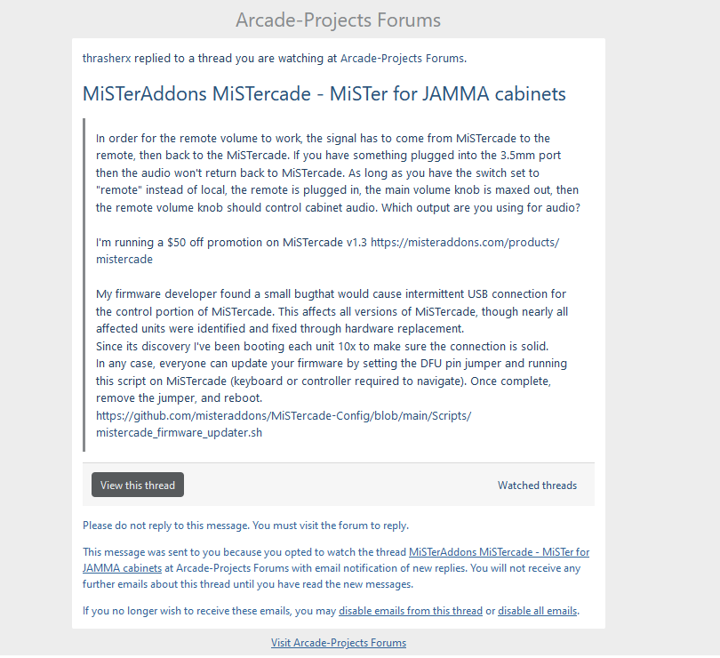

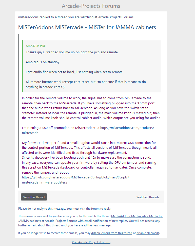

Am I losing my shit or was this exact post originally posted by a different account @thrasherx ?
You're not crazy. I noticed the same thing.
I went back in my e-mail and have a notification for the original post and the new post. Alt account maybe, I don't know I'm paranoid now.
