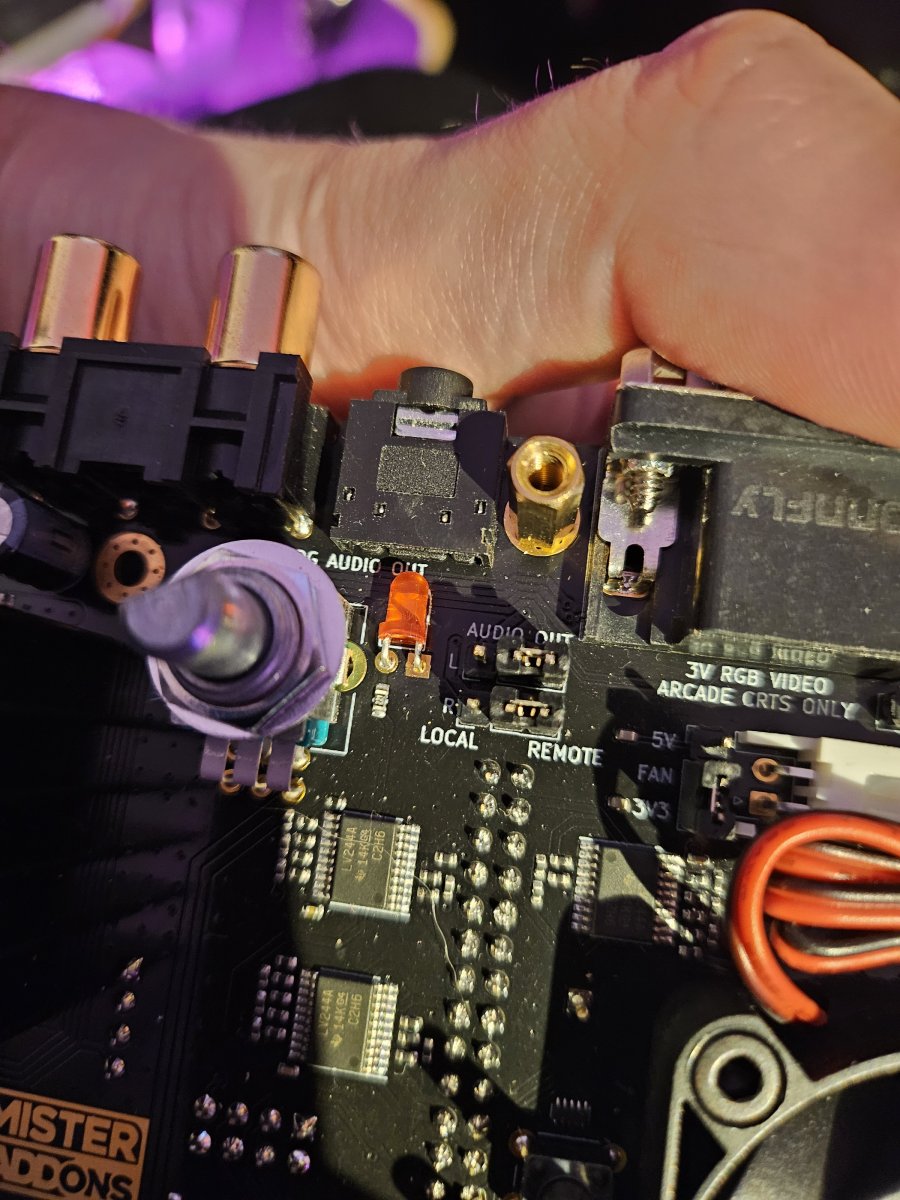

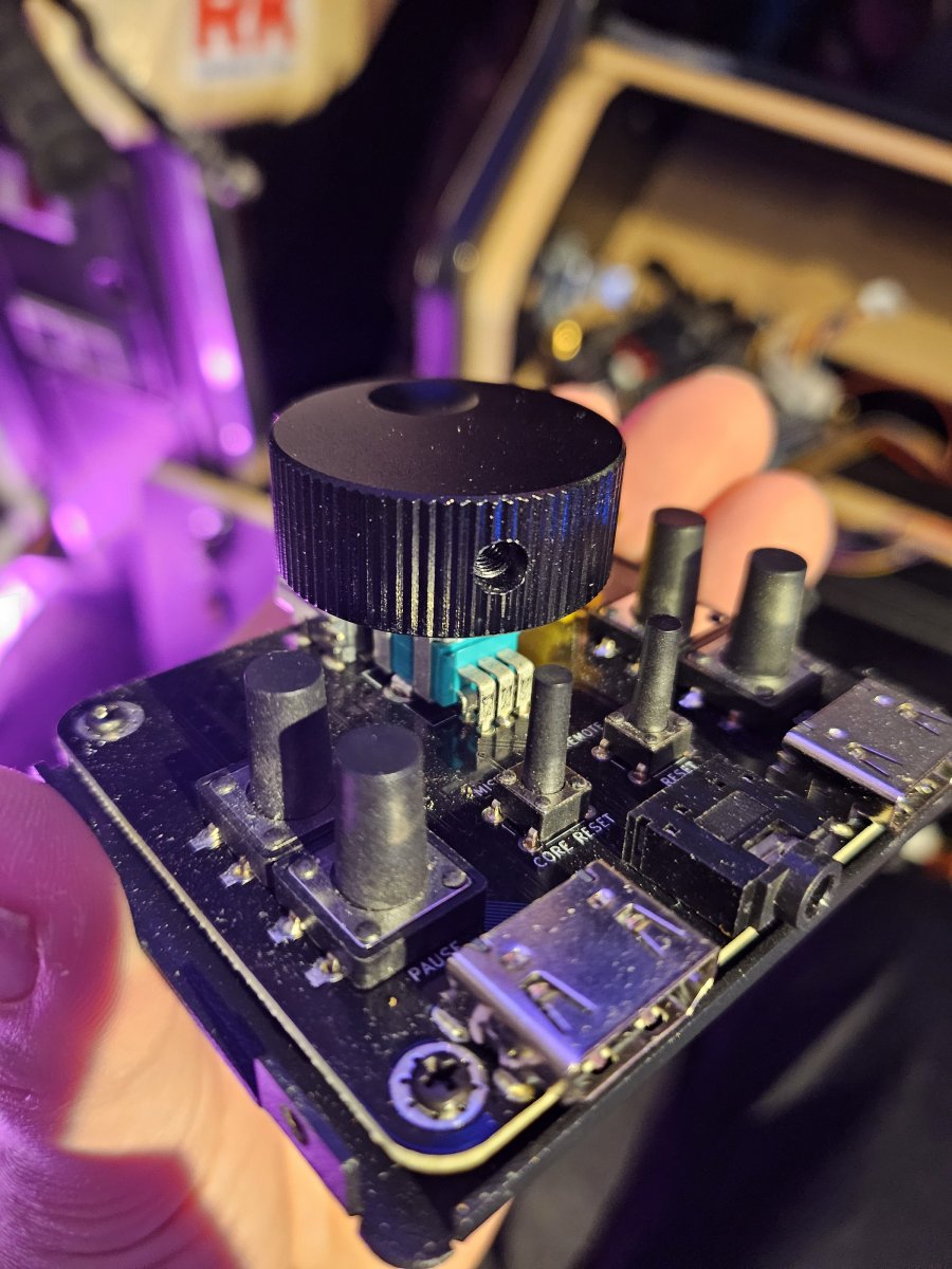

Hi Guys, recently bought a mistercade V1.2 with V2 remote. Works a dream in my jamma cab, only thing I can't get working is the external volume control on the remote.
I moved the L&R jumpers on the top board from local to remote (moved one step to right), but then I get no audio at all.
I use Audio out via jamma connection.
Any idea why this might be? Rest of remote functions work fine.

Make sure the volume knob on the mistercade PCB is all the way up
Thanks buddy, just tried that, but still no sound unfortunately . Are my jumpers correct?

Did you try using the 3.5mm jack to see if any audio is coming through there?
I haven't yet. The documentation wasn't clear. I don't want audio out from the remote.. Only volume control.
Am I misunderstanding the purpose of volume knob?

If audio is coming out of the 3.5mm that will at least tell us audio is making it to the remote. Jumpers look ok.
Which part of the documentation is unclear?
no worries. I think it's some form of hardware/firmware bug.. I can just use in game global sound instead of the remote. Not end of world as I don't need to open my cab to do it.
