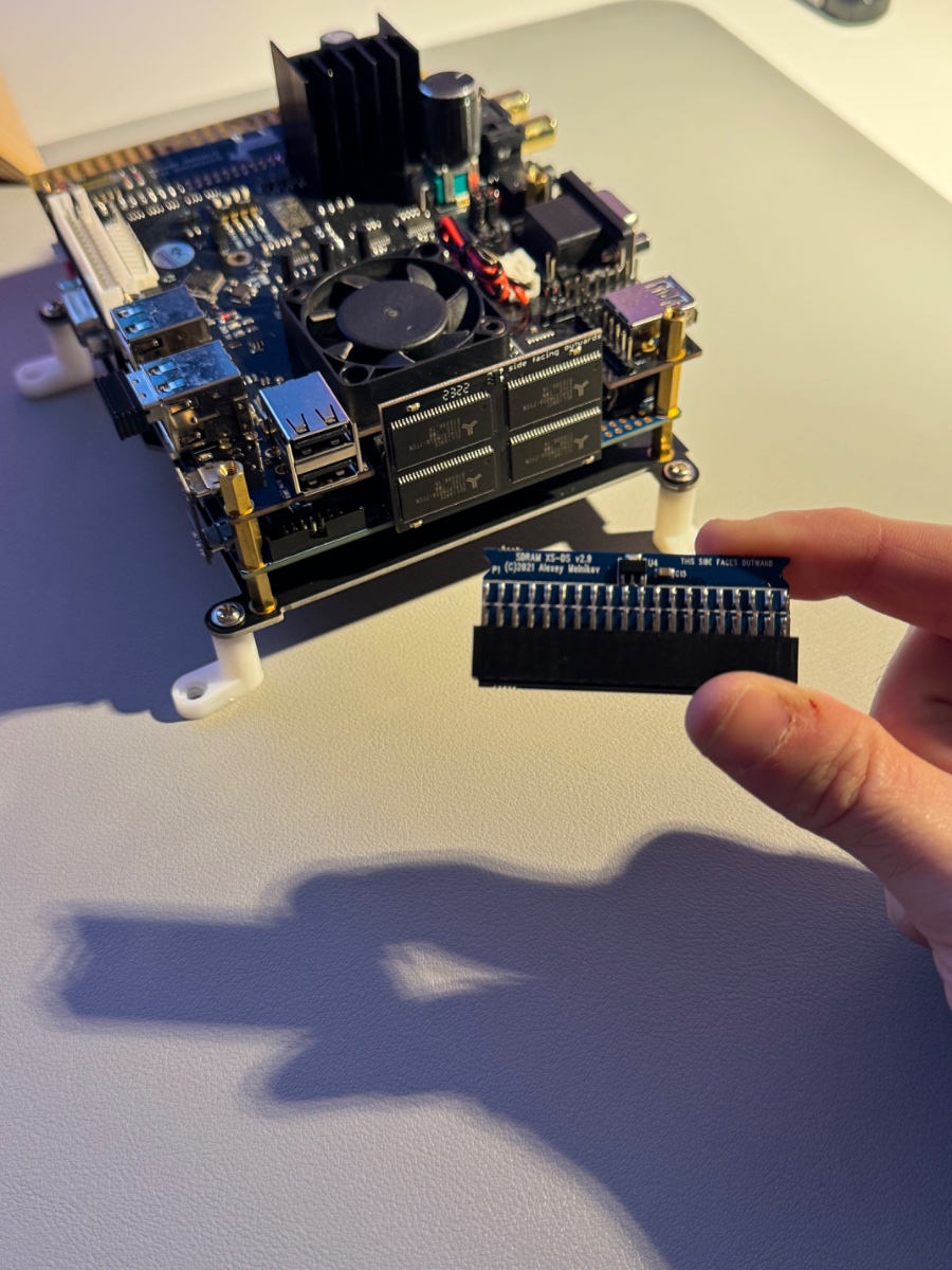

Are you sure that’s not a SDRAM or sdcard issue? The RAIZING cores push the SDRAM pretty hard. When I had issues with my SDRAM those were the cores that would crash on me the most.
just ordered a new ram just in case....
Try joining the Coin Op Coalition Discord and mention it to them. They wrote and maintain the Raizing MiSTer cores.
I could be wrong, but I think it stresses the RAM - so if you don't have latest MiSTer RAM setup then may not work for you.
This little one made the right call

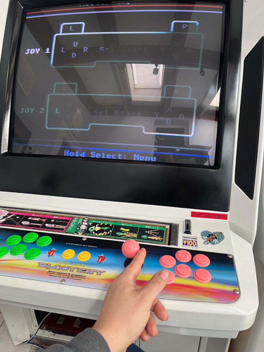

So I’m having a weird problem. When I’m playing any Cps2 games on the mister, if I play 2 player my 2p joystick also inputs on the 1p side. Only the joystick does it and only if I move it left. I have attatched a picture. Any help appreciated.93E92113-D271-427D-9118-F795A5BDBD63.jpeg
Tried to remap didn’t work same outcome. What is rebinding? Sorry if it’s a silly question.
so each core u need to set the keybinds for player 1 and player 2. i am not sure how it works on a mistercade yet as mine will be here tomorrow but whatever key combo you use to bring up the menu u need to hit right to go into core options and it'll say remap or something i forget the terminology but in there is wherr you'd hit up left down right l punch m punch h punch, l kick m kick h kick, start, coin and core credits whcih i skip. you need to do that for both p1 and p2 but if p2 is activating p1 commands i have no idea what the cause would be., but try this first.

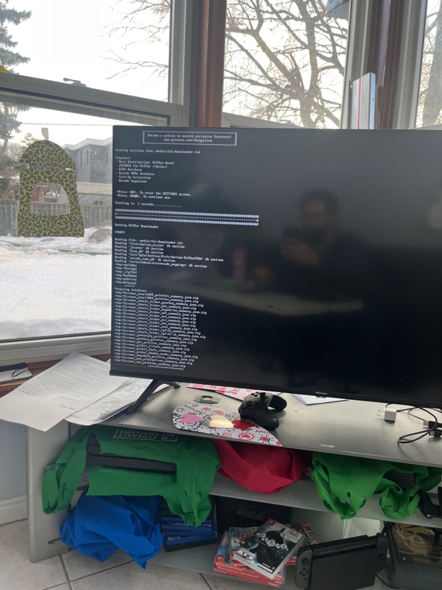

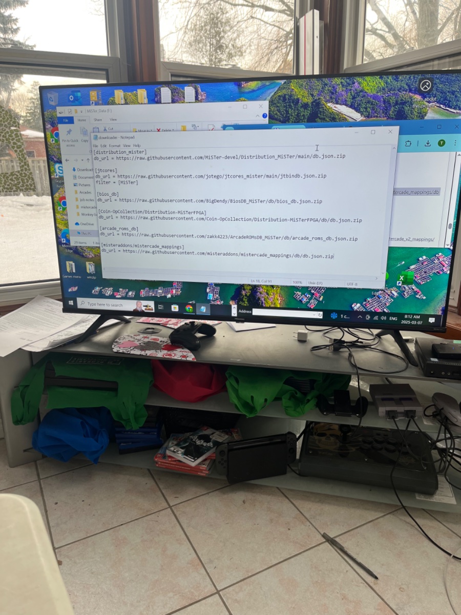

Add this to downloader.ini for Mistercade v1
[misteraddons/mistercade_mappings]
db_url = https://raw.githubusercontent.com/misteraddons/mistercade_mappings/db/db.json.zip
For Mistercade v2 add this instead
[misteraddons/mistercade_v2_mappings]
db_url = https://raw.githubusercontent.com/misteraddons/mistercade_v2_mappings/db/db.json.zip
Then run the update_all script (get it from here if you don't have it https://github.com/theypsilon/Update_All_MiSTer). It'll update all the mappings for your mistercade so you don't have to map anything (except for beta cores and things like that not yet fully released).
Was just about to say, adding key mapping to your Update_all .ini is the way to go, never have to worry about mapping the public release cores ever again. ^^
I think I did it correctly. Still having the same problem

Input test from mister. If you cant make it out the pic isnt great. When i move the 2p joystick the 1p side is not affected. only the JT cores are giving me this problem.
