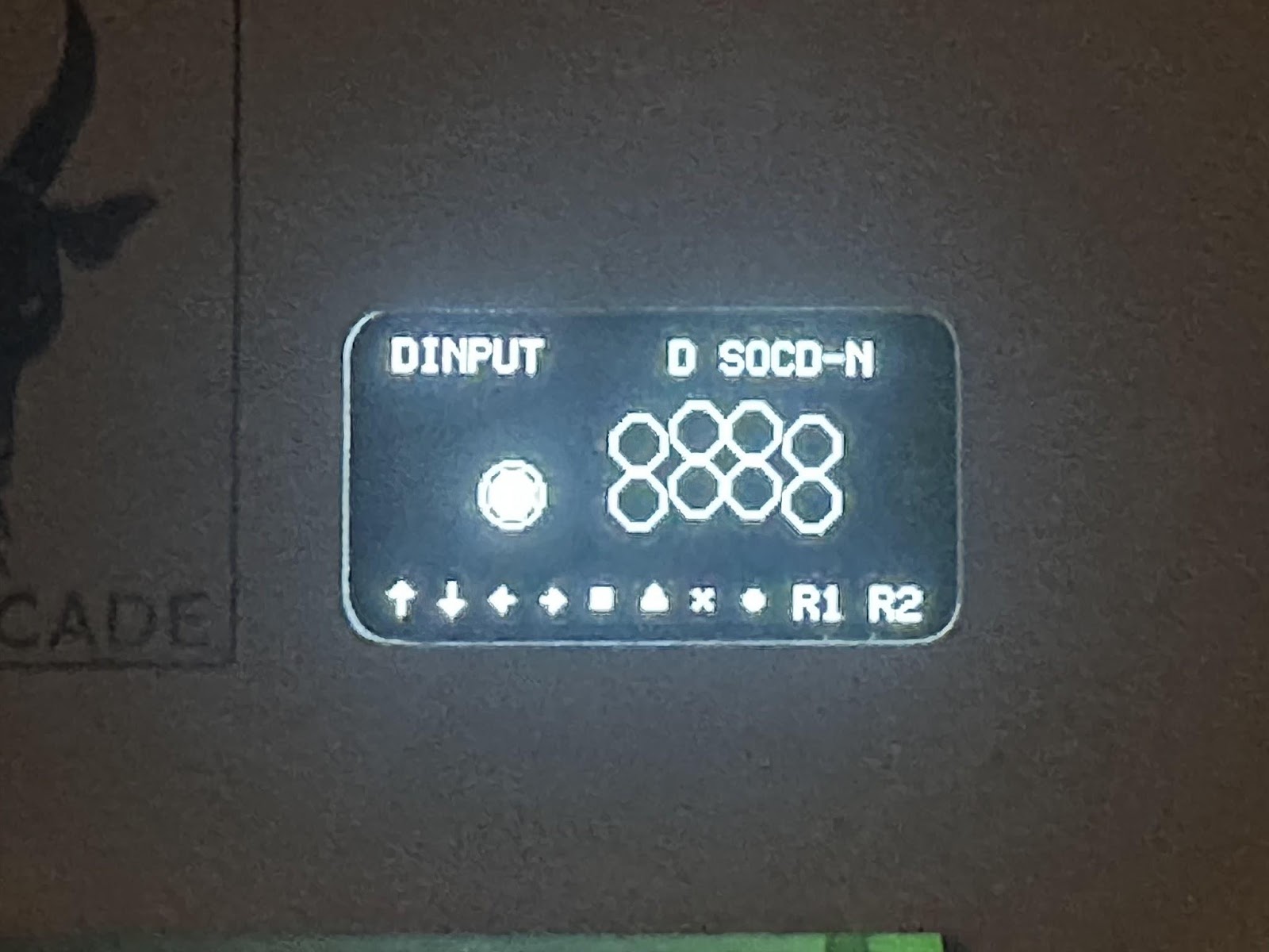

Do you have the control files for the MiSTercade installed on your SD card from https://github.com/misteraddons/mistercade_v2_mappings
Also, does your MiSTercade V2 have the OLED display? If so, does it show Button 1 being pressed on the display?

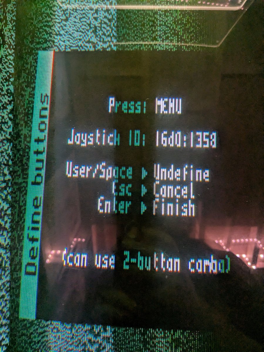

and I did talk to the support of mistercade and we are troubleshooting for 3 days and still did not find solution so that's why I try to ask here.
On my v1 mistercade my b4 on player 1 stopped working entirely. Turns out the little microcontroller(?) died on the pcb. Porkchop fixed it and I'm still using it. Might not be anything you're doing or a configuration thing.
