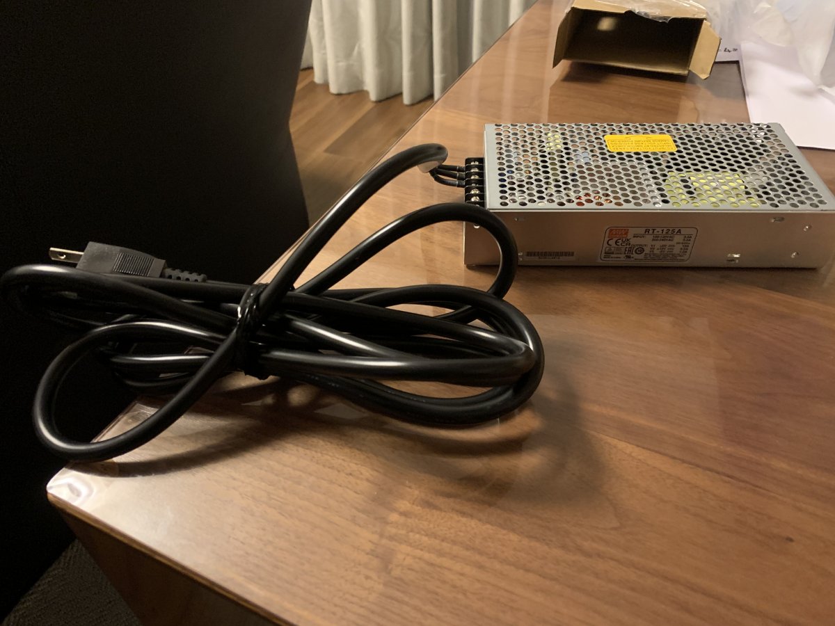

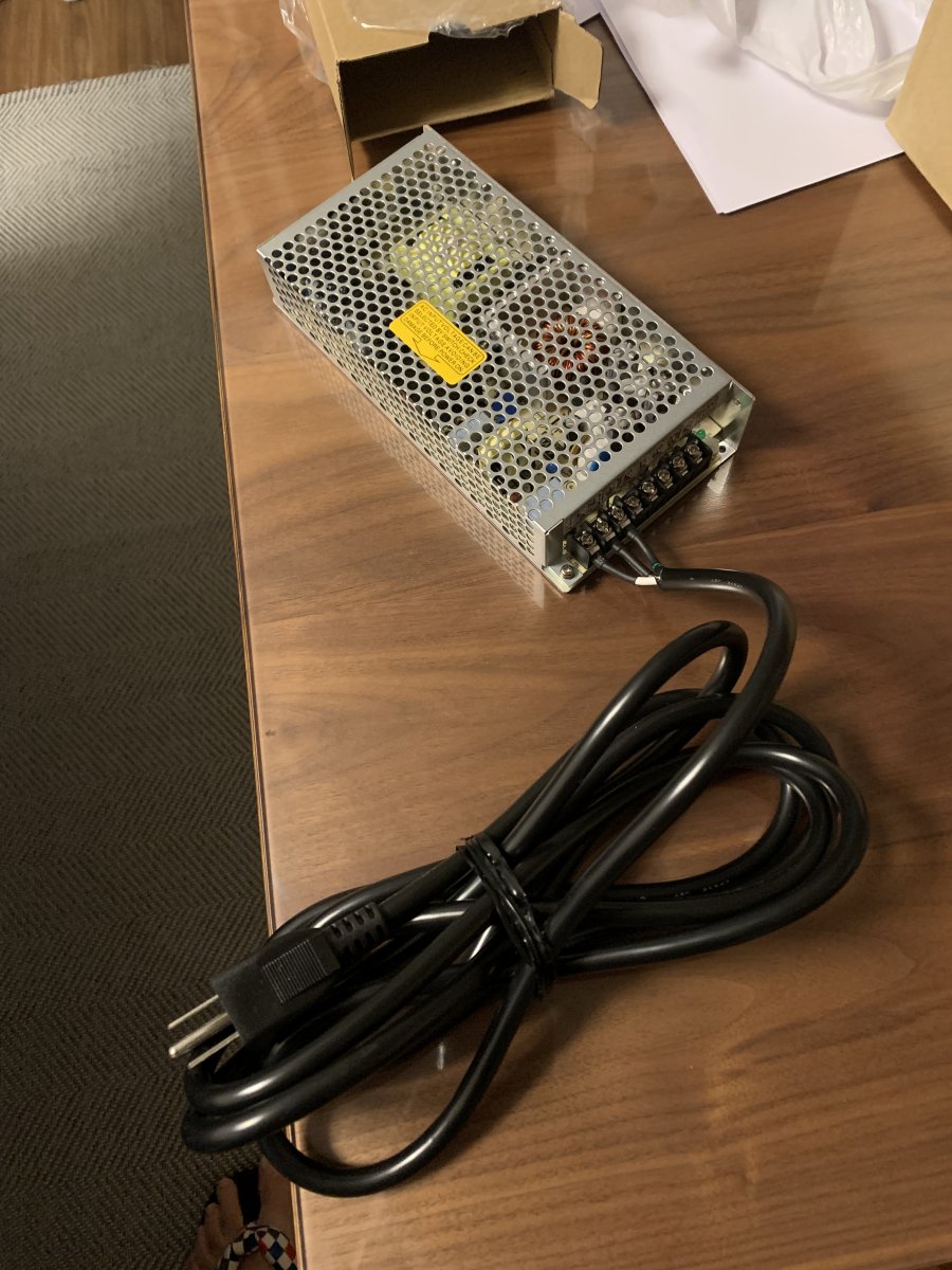

How are you powering the HAS ?
How are you powering the HAS ? Pictures please ?
Thanks, so your HAS has GND connected to your 110V PSU cable but your SIGMA does not. However your HAS does not properly as well.
Have you done any voltage measurements ? I.e. what is the voltage on 1P B1 on the JAMMA connector when the switch is open and when it is closed ?
What switch ?
1P P1 = 1 Player Button 1 , measure the voltage on pin 22.
Ground and pin 22 ok . I might try it Wednesday or later on the week end

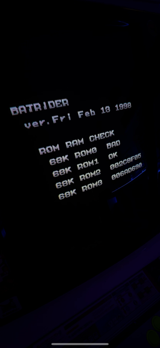

Hello! There seems to be something wrong in my Mistercade v1.1 because all my RAIZING Japanese cores get stuck on the ROM/RAM check screen and they don’t even boot. Is there any solution for this? Here’s the error I get on the initial ROM check screen
Are you sure that’s not a SDRAM or sdcard issue? The RAIZING cores push the SDRAM pretty hard. When I had issues with my SDRAM those were the cores that would crash on me the most.
