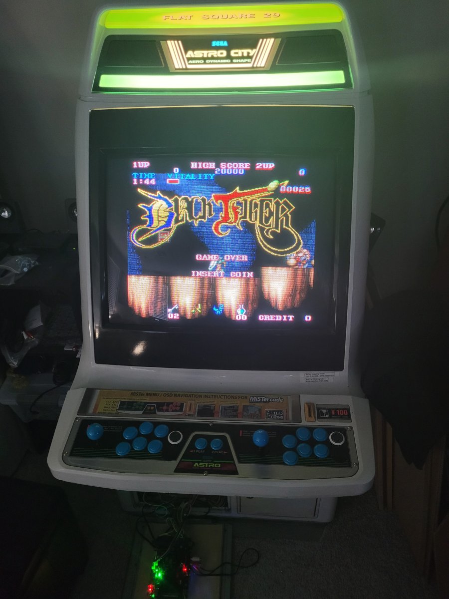

Hi Guys, i seem to have no audio coming out of my mistercade - i followed the setup guide, i get a perfect picture and everything is playable but no sound. I checked the volumes and turning to max on mister, the machine itself and in the OSD does nothing. Any ideas?
If i plug my CPS2 board back in it works fine so it doesn't look like it's the cabinet. It's a Sega new astrocity cab. Trying to get audio via jamma like normal.
Edit: Fixed - dip switch setting on mistercade. It looks like the default settings don't quite match the manual, no biggie.

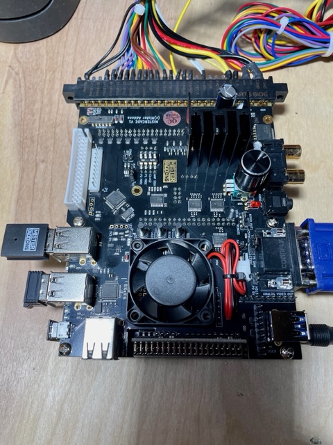

I have a single mono-speaker in what is a new Namco-style cabinet which originally housed an iCade 60-1 board. I’m not getting a sound out of that speaker when connected via JAMMA and connecting to my monitor via analog VGA on the MISTercade. But when I connect to my monitor directly to the DE-10 Nano via HDMI, the sound comes out of my monitor (it’s weak, but you can hear it). The MISTercade volume know is rotated to max. Volume in the MISTer F12 menu is set to 100%.
Right now, I’ve just connected a powered speaker via 3.5mm to carry the sound to my satisfaction, but I’d like to figure out why I’m not getting sound out of my cabinet’s speaker.

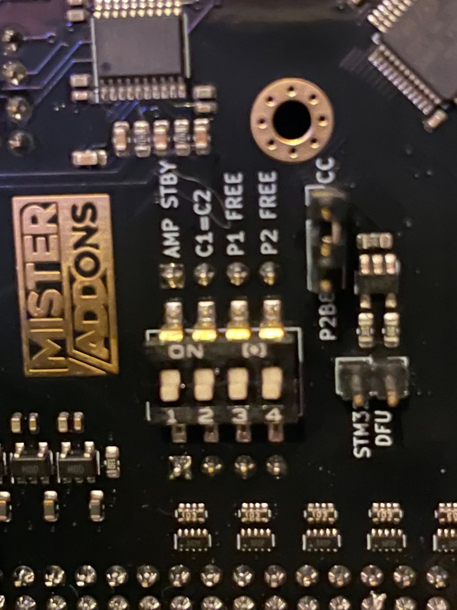

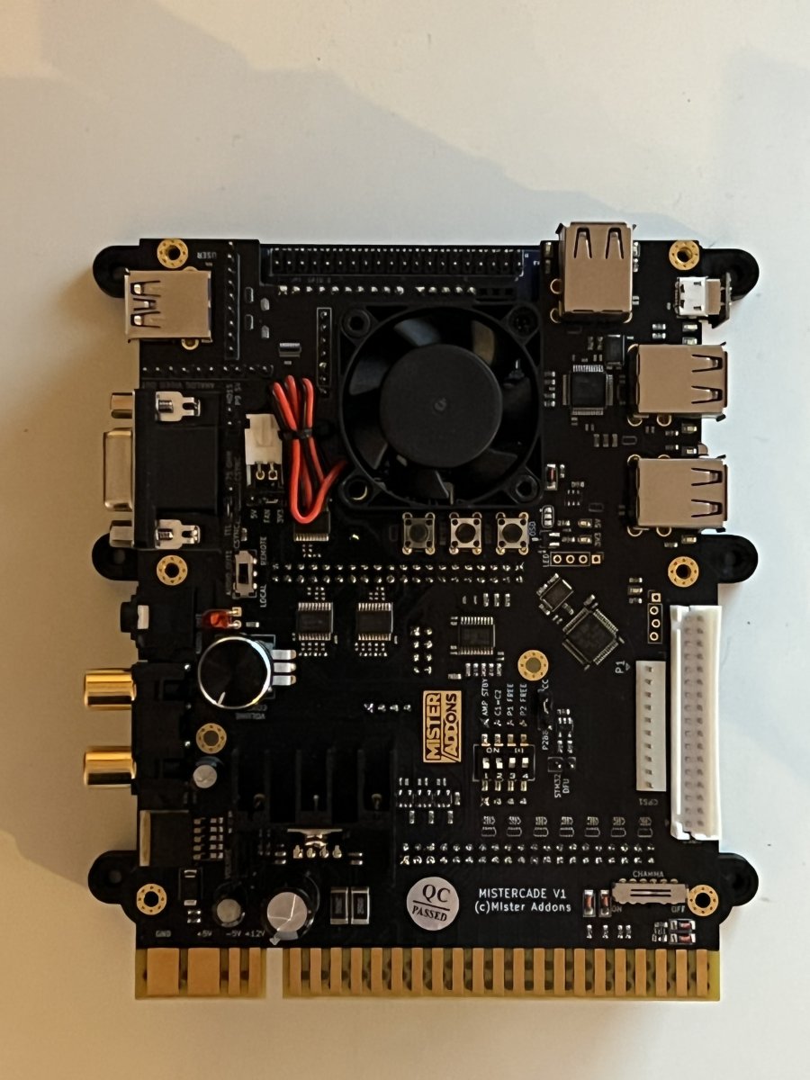

Those dip switches are set exactly as you described. I set SW0 on the DE10 Nano just exactly as you outlined in your YT setup video. And the AMP STBY dip is (as you can see) set to OFF.

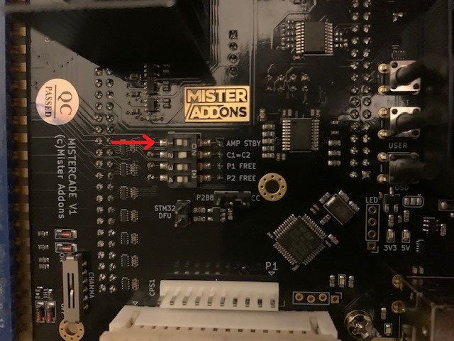

AMP STBY is the dip switch i had to change, but mine looks to be set the same as yours.
Here are my dip settings, however i only changed AMP STBY the rest are as i recieved the board
Also the other thing i did as part of setup was copy the mister.ini and the other config files over from the mistercade github, so i'm not sure if the sound settings are set in one of those files (i just copied them all across). Also i'm using the 15khz mister.ini (renamed to MiSTer.ini and dropped into the root dir of course).

A few questions:
1) The speaker does produce audio with a regular JAMMA board, correct?
2) Do you have a multimeter? If so, check for continuity on the two speaker wires between the speaker terminals to where they connect on the JAMMA harness (Pin 10 topside is speaker positive, and the pin underneath it is speaker negative).
3) Do you have the MiSTercade connected directly to the cabinet's JAMMA harness or are you going through a switcher of some kind?
4) Does the MiSTercade heatsink get warm after the cabinet has been on for 10 - 15 minutes?
A few questions:

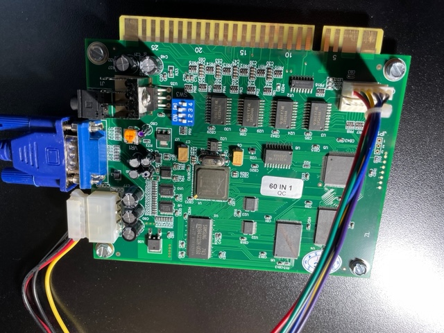

1) My mono speaker produces sound when the JAMMA is connected to the 60-1 board. It does not produce sound when the JAMMA is connected to the MISTercade.
2) Yes, my multimeter shows good continuity from the JAMMA harness (pin 10 + and pin underneath - ) all the way to the mono-speaker behind the marquee.
3) Yes, the JAMMA is connected directly to the cabinet's JAMMA harness, no switcher installed (presently).
4) I also own a MISTer in the aluminum case from MISTer Addons, the heat feels normal and no noticeable changes after 10-15 minutes.

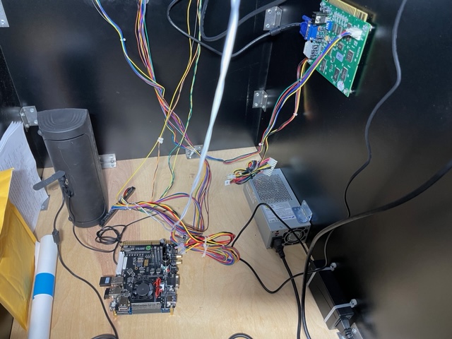

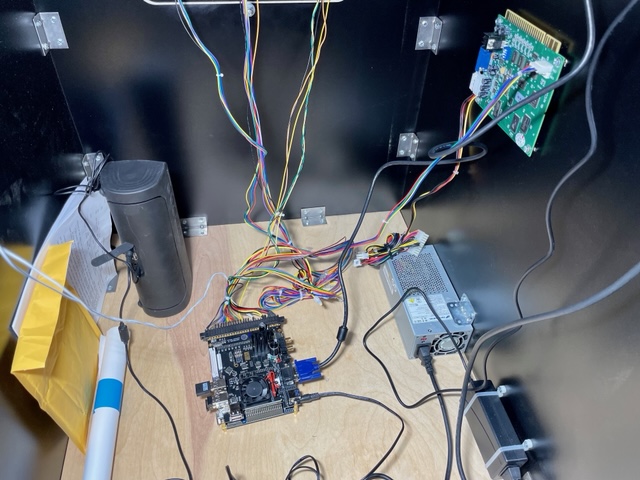

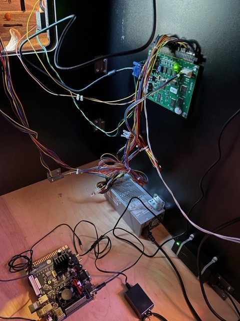

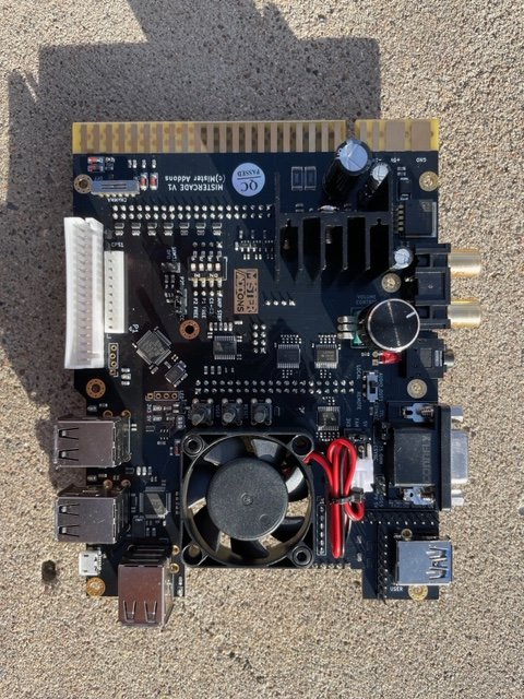

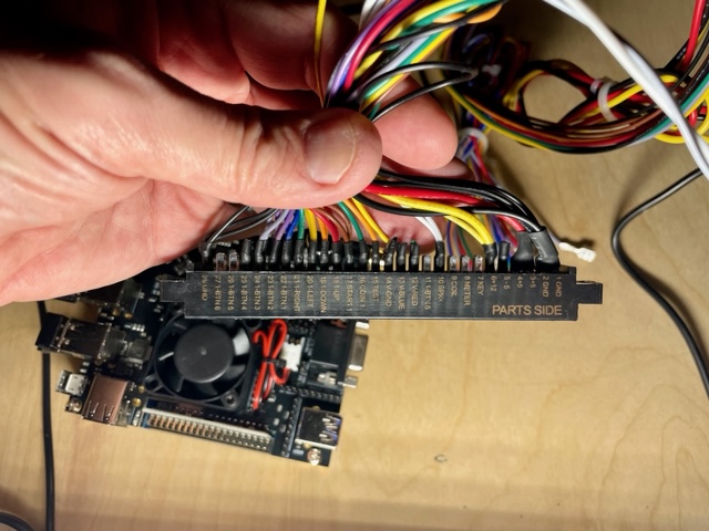

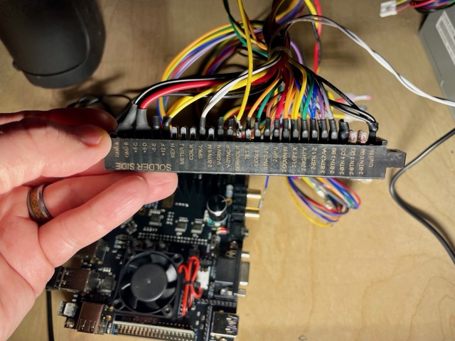

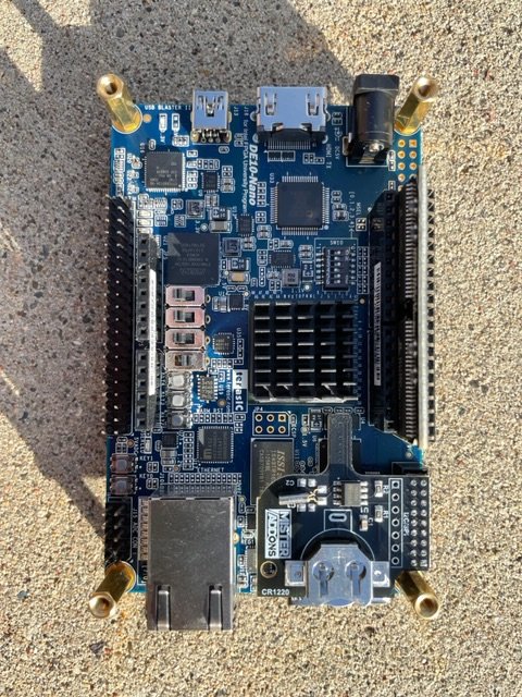

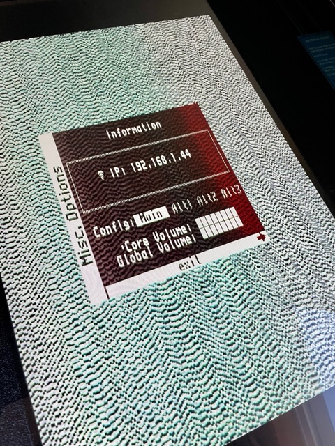

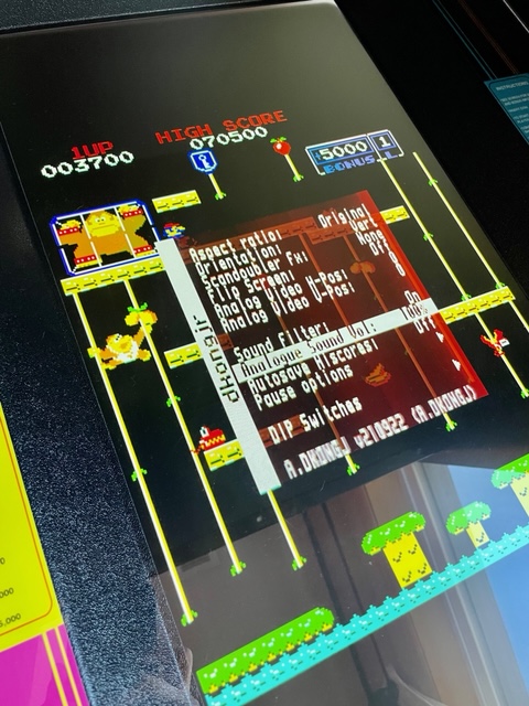

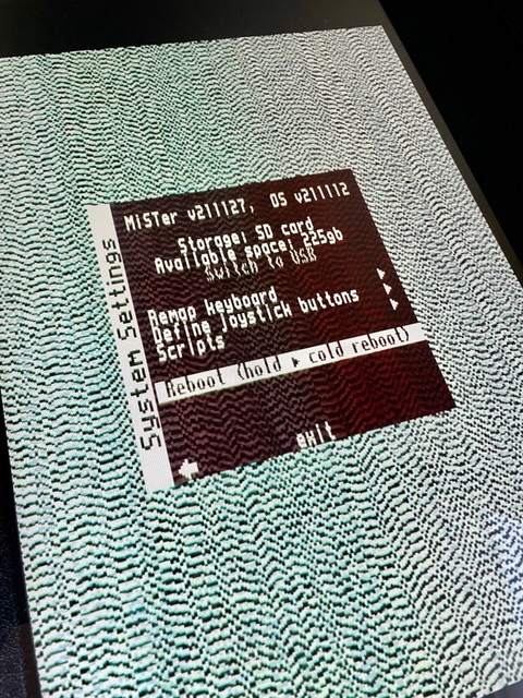

I've added pics to hopefully help me make sense of this problem. NOTE: I can't seem to get them to show in order, but I've taken some pics to show the JAMMA attached to my 60-1 board and then finally attached to my MISTercade. Hopefully, it makes sense. And the Oontz Angle speaker is not connected to the MISTercade or 60-1 in any of these pics. To get some sound, I've been hooking that up to the 3.5mm on the MISTercade and it works for now until I can get this speaker issue sorted out. Also to note, the MISTercade volume knob correctly modulates the loudness of the Oontz angle speaker (when connected via 3.5mm) as intended.

Thanks for the answers and pics. It sounds like everything with your cabinet and speaker are in good working order.
Check and see specifically if the amplifier heatsink on the MiSTercade hat is warming up-it should be warm to the touch after 10-15 minutes. If it’s not then the onboard amplifier likely isn’t functioning and you’ll need to get it exchanged with @misteraddons

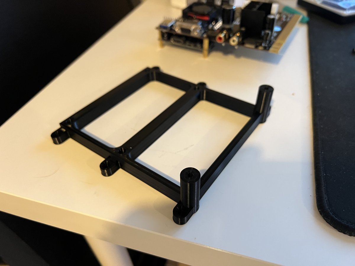

Hey everybody,
This is a bit off-topic to the above discussion but I figured I’d share here:

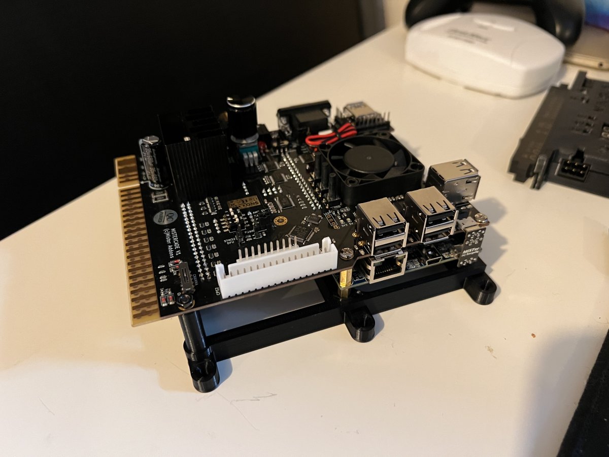

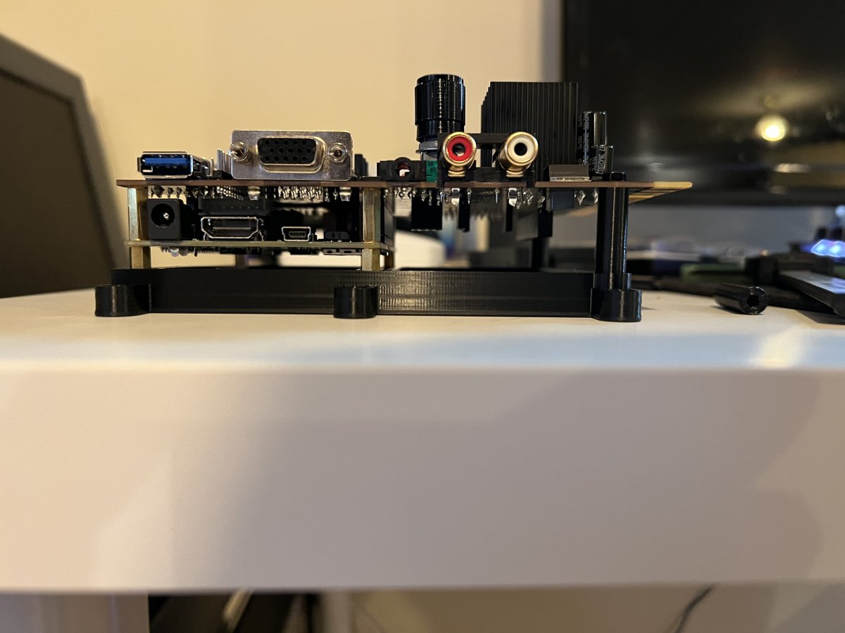

I’m working on a mounting bracket for the mistercade. As I remove and put on the jamma connector I’ve noticed the jamma end can feel a bit flimsy (especially if your jamma connector really likes to bite). I would hate to bend the board and crack it or damage traces over time.
I think I finally got all the right measurements for holes. The hope will be to add rigidity to the board and also make it easy to screw into the plywood inside a cabinet without needing extra PCB feet. I’ll post the results when the print is finished (8 or so hours from now). It’s a first draft, so it may require some additional tooling and bracing. Also this is my first real 3D model, so be gentle 😂
I also will be releasing the model on thingiverse with no strings attached when it’s ready.

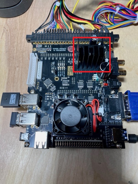

This part is dead cold to the touch and I've had power to it for over an hour...

First print didn’t turn out too bad. Front holes need some adjusting as they’re about 1mm out. The front posts are also a bit too thick and hit the legs from the chamma switch. Should be easy enough to trim a bit of fat.

Second draft looks good! Feels very rigid. I’ll be heading to Home Depot today to grab some #4 screws and test attaching it to some plywood. As long as that goes ok, I’ll put it on thingiverse.
