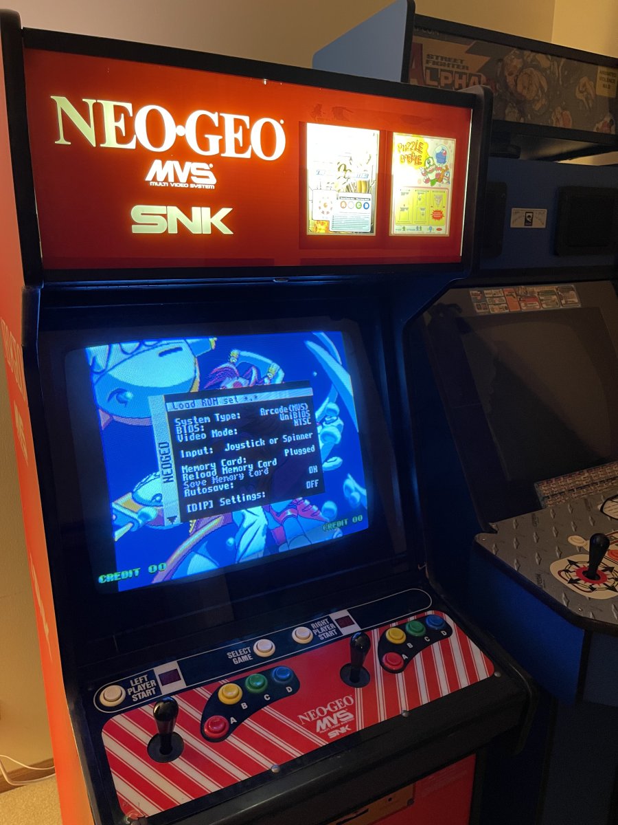

If it’s MVS wiring then looks like it should be: “Select Up” = P1B5 and “Select Down” = P2B5. Flip the CHAMMA switch to on and give it a shot. https://wiki.neogeodev.org/index.php?title=JAMMA_connector_pinout
Thanks @misteraddons! Yes, flipping the CHAMMA switch did the trick, pressing SELECT now brings up the menu. Everything is working perfectly now and my Neo Geo dreams have become a reality!

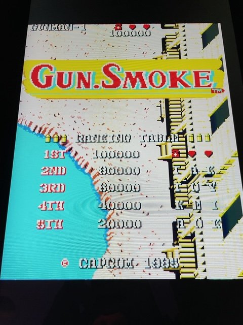

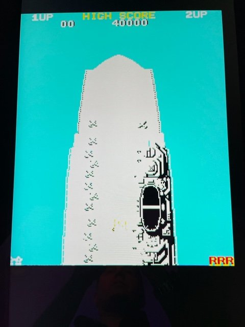

I just received my MISTercade and I'm having a little bit of trouble getting the display to work correctly. I’ve been reading thru this thread and I’m wondering if I’m experiencing similar color washout issues previously reported…
I have reviewed the MISTercade online manual at: https://docs.google.com/document/d/1Ujk ... QNcuI/edit#
I replaced my 60-1 board with my MISTercade in a generic Namco style arcade cabinet (JAMMA). My monitor is connected via VGA and not thru the JAMMA.
I'm using the MISTer-31kHz-TATE_CW ini on my MISTercade setup and I'm getting a lot of color washout on my display.
Games like 1942 are completely washed out in brightness/saturation and I can't even make out the F12 overlay menu while in-core.
I moved that MISTer-31kHz-TATE_CW .ini file to the root of the SD card and have renamed it to “mister.ini” as instructed. My arcade monitor is connected to my MISTercade via VGA. I swapped VGA monitors and the problem persisted. The main F12 menu (w/ black/white noise) screen is over saturated in white. Referencing the MISTcade manual online, I ensured that my CSYNC jumper from 75 ohm in on TTL. The various scanline options are barely distinguishable from each other.
NOTE: the 15kHz .ini causes the MISTercade to not even boot the the F12 core selection menu (black screen) so I assumed the 31kHz is the only option.
Any idea what I'm doing wrong? If not here, where should I ask for help? Thanks.
Are you using a PC CRT? If so you'll need external attenuation. Read some of the above posts.
