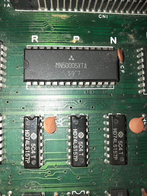

The Mitsubishi 'MN50005XTA' is a DIP28 .600mil plastic part :

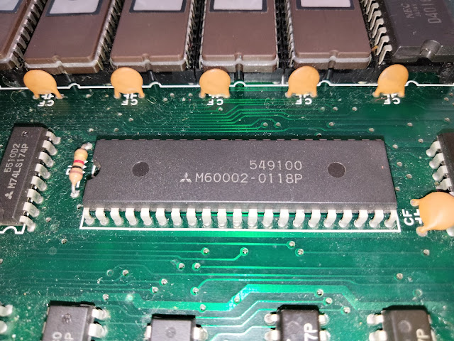

Whereas the 'M60002-0118P' is DIP42 .600mil (always with plastic case)

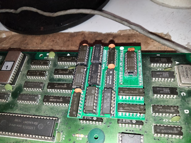

'MN50005XTA' reproduction :

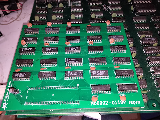

'M60002-0118P' reproduction :
Both replacements worked at first try when tested on my boards (Rygar and Silk Worm)
Since the designs have been validated a CPLD version of the TTL reproductions will follow later.
