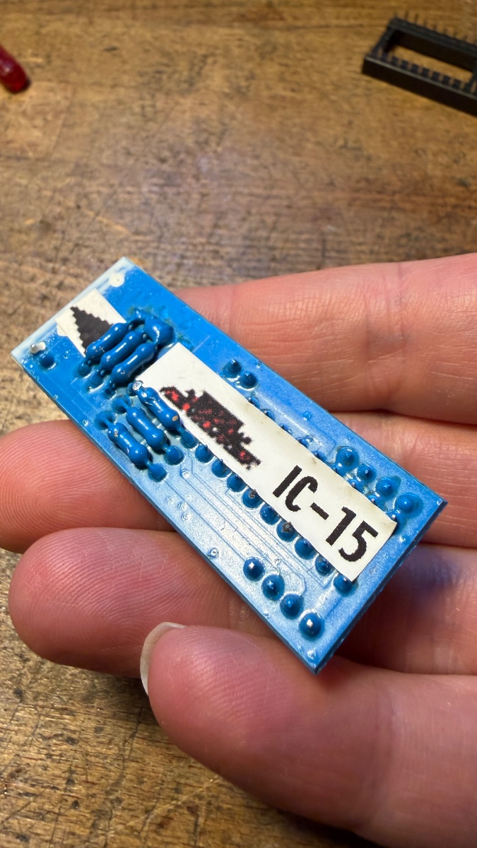

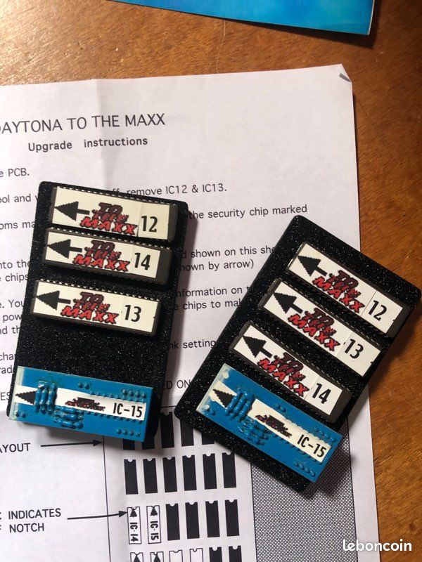

Does anyone have any information on Daytona to the MAXX upgrade for Daytona USA (model 2), ro have you got a kit in your game that runs??
I have 2 original kits for this and i have also been trying to remake the security kit so more people could run it. But i am having various problems. History here
https://www.ukvac.com/forum/threads/daytona-to-the-maxx-recreating.89238
Basically the roms and the security kits i have seem to work as per MAMES checks at initial boot, but the game on my real hardware doesnt run attract it just stays on the config screen.

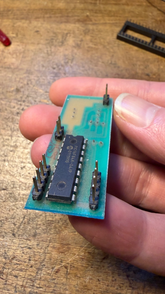

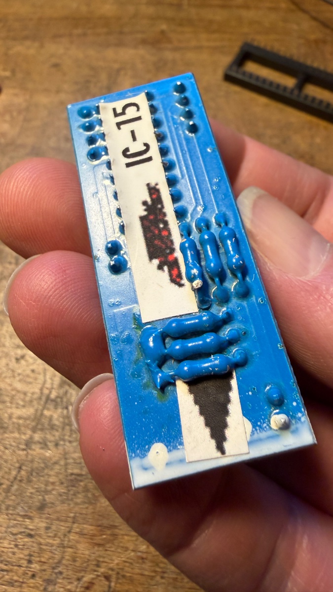

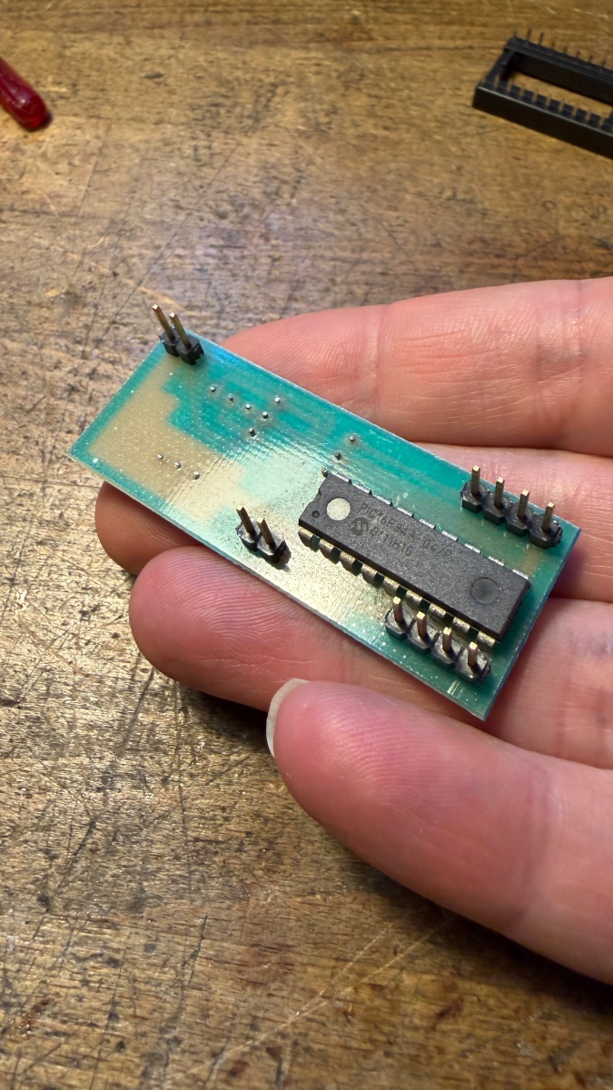

This is what my original kit looks like, so it would be interesting to see anyone else's kit to and what the game hardware you have it running in.
Interesting. Since it's just in a rom socket I'd bet it changes up the data output on multiple reads. You'd probably be able to reverse engineering it from the emulated output of that address space in mame
@mypinballs why does your repro has a clock if the blue original doesn't have it? Also I see several resistors that your clone does not have. Are these pull-ups?
Do I understand right that you are "reversing" the PIC based on what's in MAME? I have a better idea, why don't extract the code of the PIC?
Yeah, i'm wanting to know if anyone else has an original kit running as these original kits do not work in my original upright.
I know i have some changes to make on my version boards, now i have an original one to look at, as I started my project before i thought i would ever find an original kit (using MAME source as a guide), but if the originals can't be proved to work fine on original hardware, then i'm a bit screwed as to whats verified correct. Getting the pic code off the original is certainly an option to investigate if i can get them to work.
