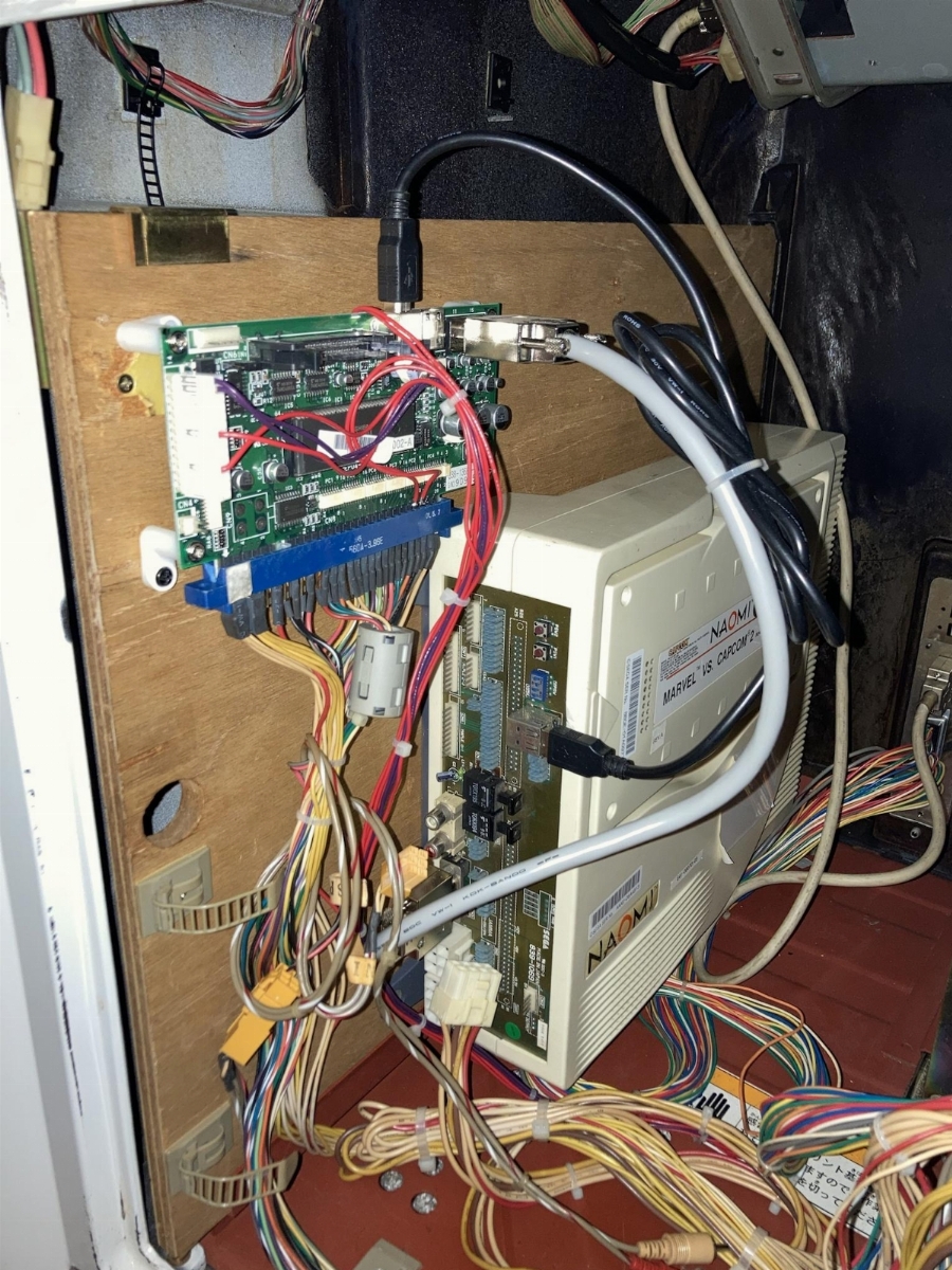

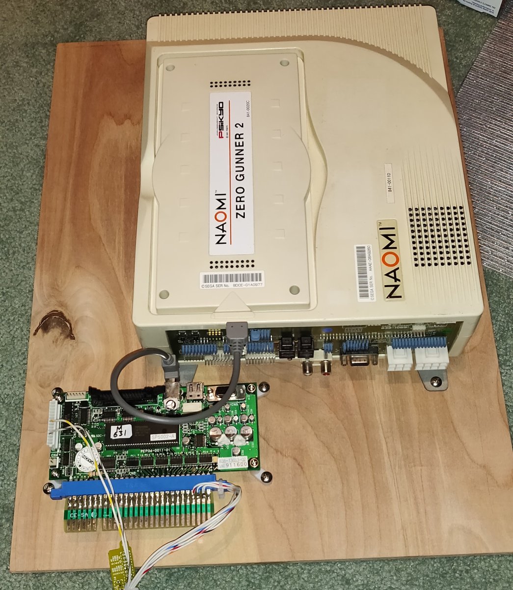

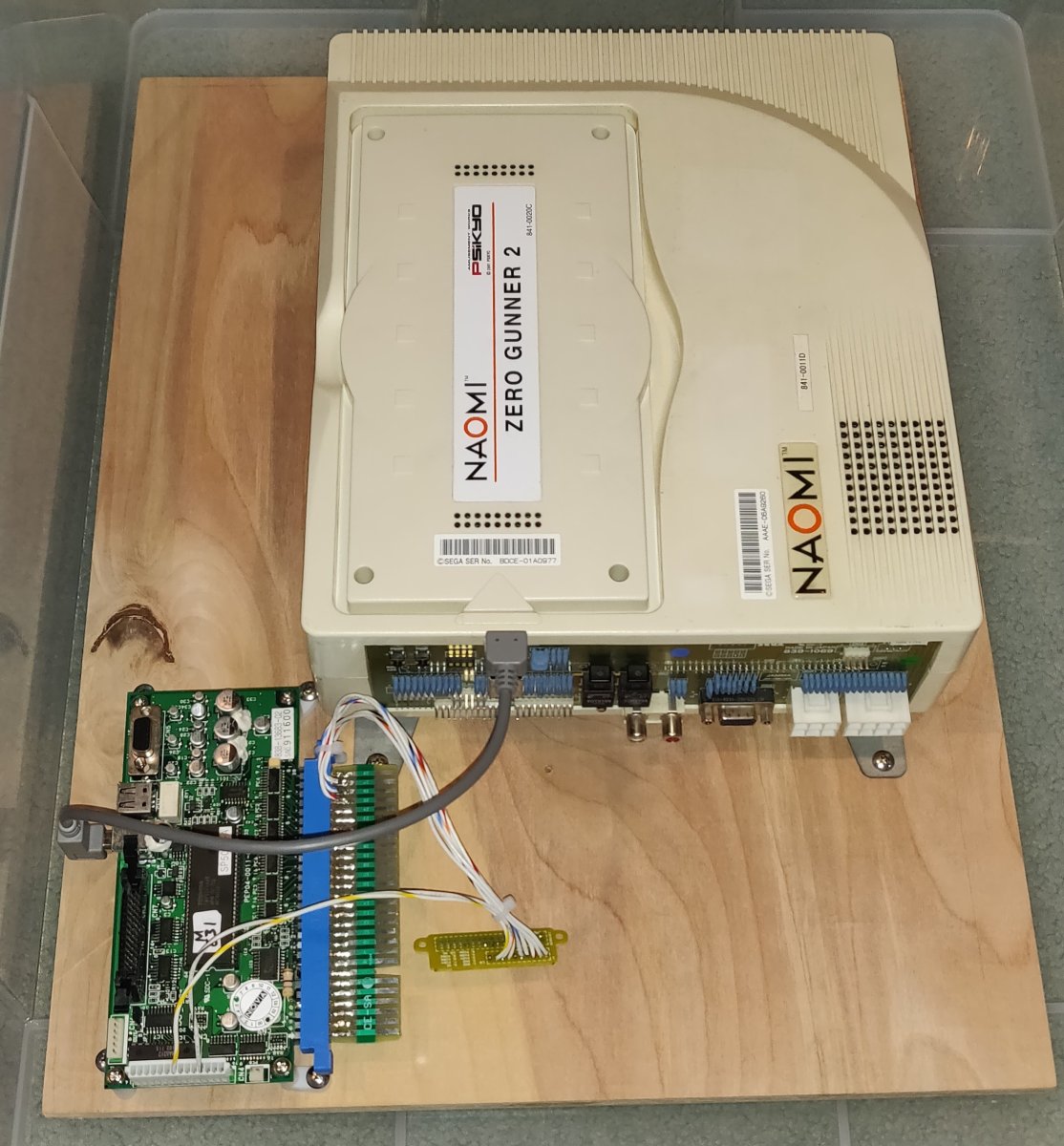

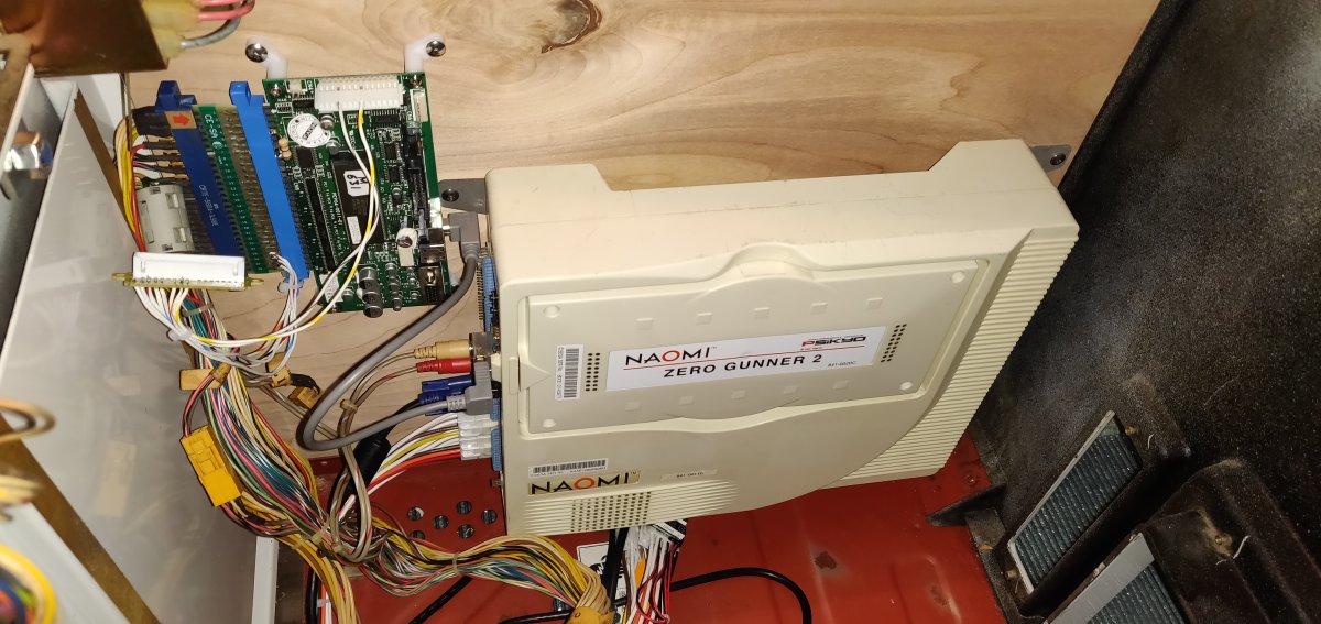

It's a bit tight, but I was able to mount both a CPS2 with a Darksoft multi and a Naomi 1 with Sega IO and @Lemony Vengeance 's CPS2-Sega IO adapter on their own wooden boards and fit them (individually) in my Blast City. Figured I'd post some details here if anyone's ever looking for resources.
Materials:
The piece of wood included in my Blast measured 15 3/4" x 20 7/8" by 1/2". I picked the straightest looking board with as few filled-in knots as possible. Had it cut in the store. I used a small plane to file the top down a little bit more at home after testing in the cab, especially the back corner. After getting the right fit, I traced the bottom and back rails and top front mounting slot clearances onto the boards so I knew how much room I had to work with. I'd be happy to provide measurements if anyone needs them, but drawing the lines on the boards yourself is probably the easiest way to do it. As for mounting, I lined up the PCBs on the wood outside the cabinet, marked the holes, then drilled small pilot holes.

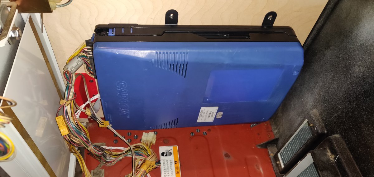

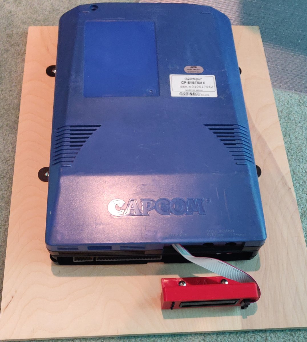

I tried to leave a little bit of space in the back of the CPS2 for the fan exhaust. I can get the kick harness and JAMMA adapter in behind the LCD screen no problem, and it's easy to pop the LCD 3D print off the 3D print mounted to the wood if I need extra room.

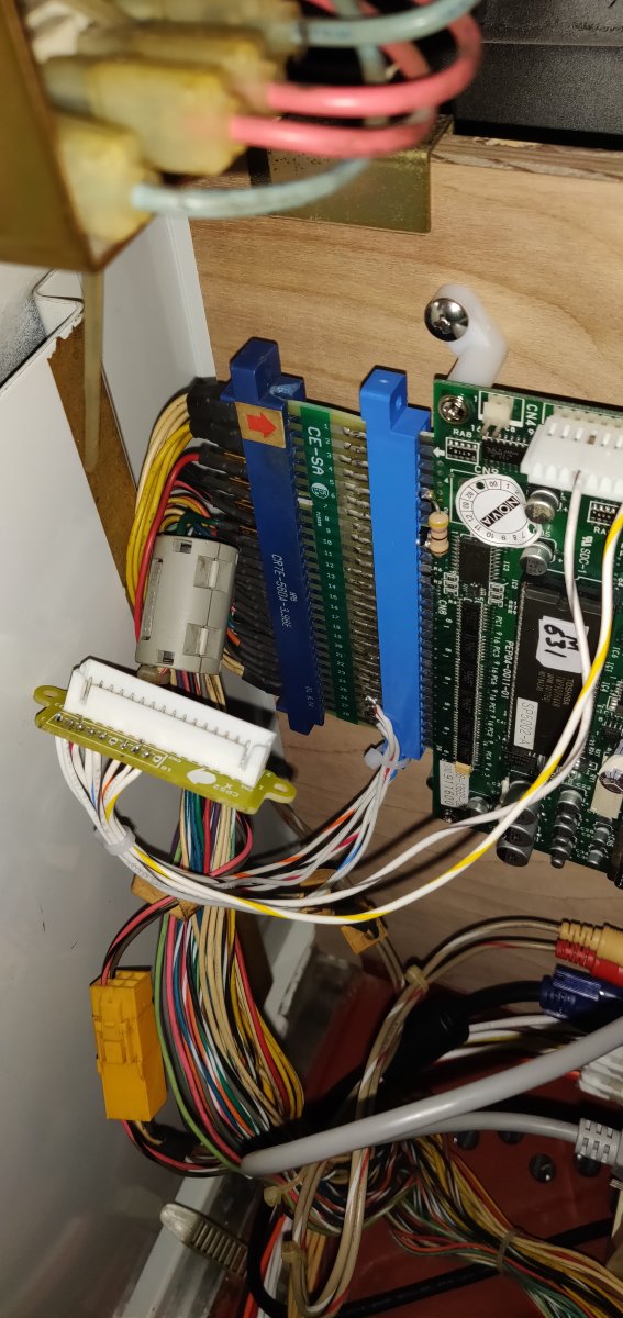

The Naomi was a bit tighter. Even with the back of the Sega IO's angled USB cable nearly touching the Naomi and the Naomi as far back as I could put it, the door presses against the JAMMA adapter's wires when I close it. Maybe I'll look for an alternative CPS2 kick converter, but I think it's good enough.

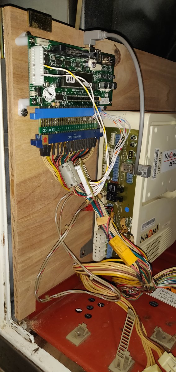

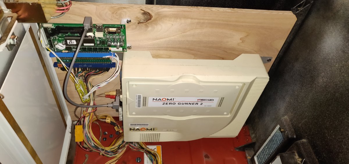

If you mount the SEGA IO horizontally above the namoi you won't be pinching the jamma harness with the service door.
Yeah, good call @BlinG . Sega IO fits horizontally, plenty of room for the JAMMA harness even with the CPS2 kick adapter. I didn't think it would when I measured a while back, but having the Naomi in place helped a lot; probably would have been best to mount the Naomi first, then go back for the Sega IO.

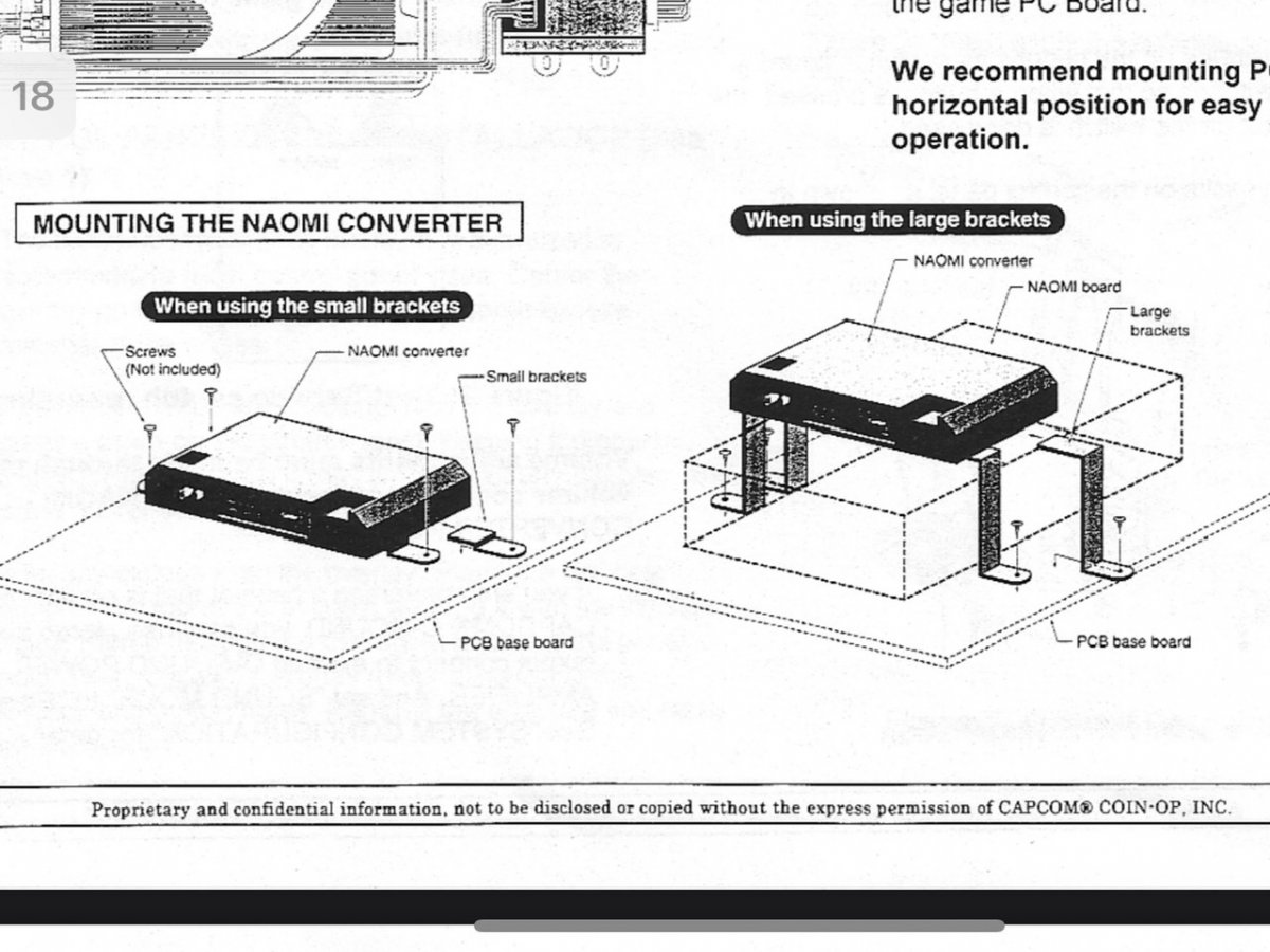

You could use the large mounting brackets of a Capcom Converter IO Board, they are specifically designed to mound a Capcom Converter on top of a Naomi, and it's the exact same fit than a CPS2.
Or I imagine they can be 3D printed quite easily.
