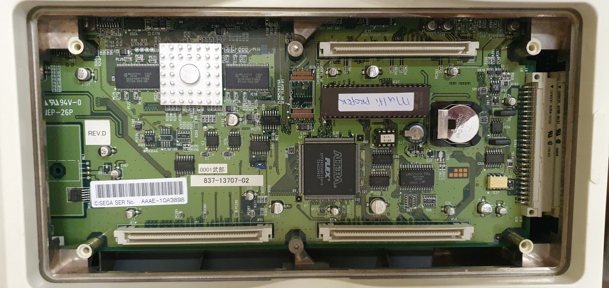

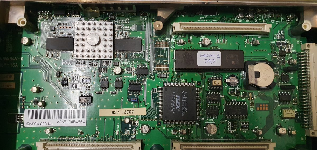

Okay, so we have been doing some testing (@PascalP and myself) yesterday evening. We have 2 Naomi's and 1 is working, the other 1 isn't.
We have exchanged everything, bios, cartridge, wiring, cabs, etc. and what we have found is the following:
Working Naomi:
- 99/12 (assuming this is december 1999)
- 837-13707 on mainboard
Non-working Naomi:
- 00/12 (assuming this is december 2000)
- 837-13707-02 on mainboard (also a sticker with Rev. D present, not on the other one)
@Kitinota does this align with your findings? Please let me know so we can post some of these findings on GitHub.
Thanks.

Yes I think we can point to @Sp33dFr34k 's Naomi that is the culprit, my Naomi system worked 11 out of 10 times :P
And his was very picky, and just didn't work at all when we tested yesterday, also not on different 5v voltages like he got it working earlier.
Also to exclude anything else we swapped carts, bios (JAP and multi), cables, PSU's, 2 different IONA's and tried different 5v settings and mine just worked with every combination of parts.
Wondering if @Kitinota can confirm which Naomi revisions work for him and which don't as that is the only obvious difference we saw between our units.
Now that just leaves us to solve the non-working PS3/PS4/Switch/Xbox360 controllers... Will try again later at my place when I've had some more time, but my plan is to use the IONA on my System 369 with TTT2U on the big screen projector and would be cool to just sit back on the couch and use a wireless PS4/Xbox controller for it ;)
