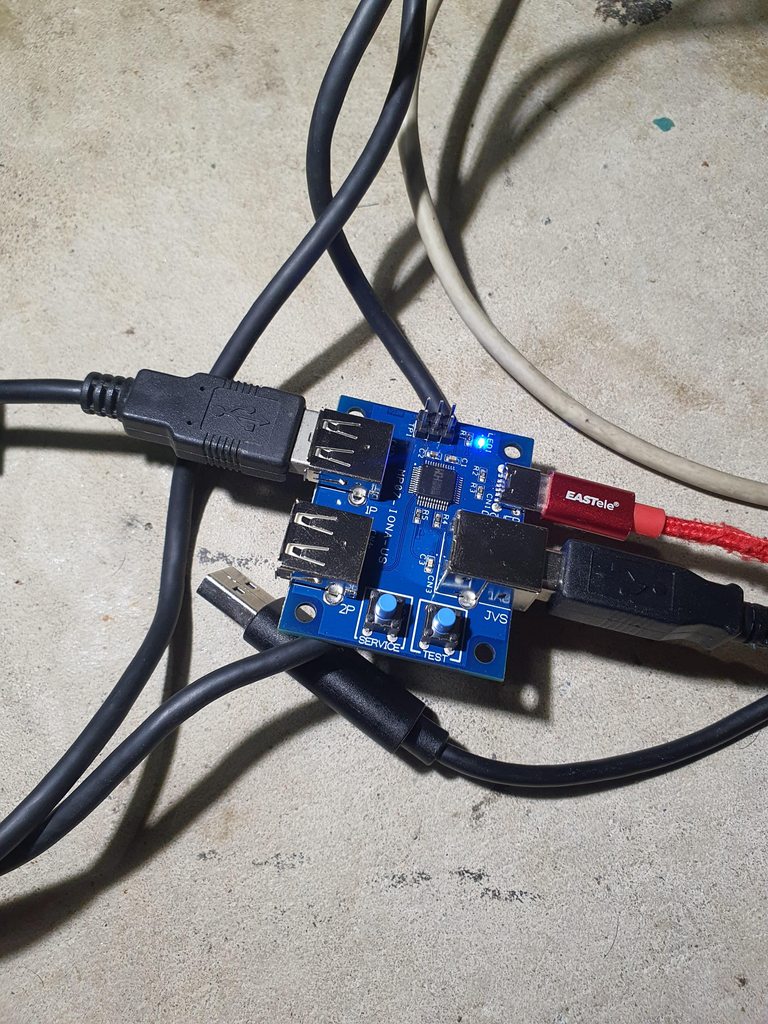

I have no idea what I'm doing wrong, but I can't get this to work for the life of me - multiple different USB fight sticks, but still nothing.
Naomi won't boot as it doesn't detect an I/O.
I've installed some headers so I can jump to get into the firmware mode, but I can't get it to detect in windows.
I'll have to read through the thread/manual again to see what I'm doing wrong.
It's definitely a finnicky device... maybe you also have one of those incompatible Naomi's @mR_CaESaR. I was waiting for @Kitinota to provide his feedback before submitting to GitHub, maybe he missed it so will wait a bit longer.
As for the firmware update issue, try another machine/USB cable/USB port to rule the simple stuff out. For me personally it worked on the first try but I have seen people having issues.

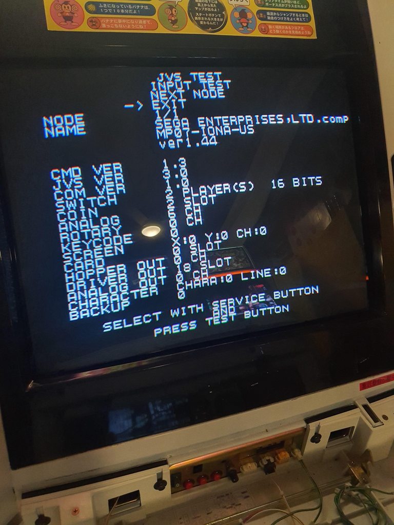

So I finally got this working on my naomi 1! :D :D (what a finicky little thing it is)
I've basically read through the thread a couple of times and tried what a number of users have said as a trial and error.
Things I did:
  1. Installed headers so I can get into firmware mode
  2. Updated the firmware to 1.44 as per Shin's post
  3. Program my Virtua Stick High Grade stick via layout config mode (TEST+SERVICE > TEST> Select > Start > B1 > B2 > B3 > B4 > B5 > B6 > TEST)

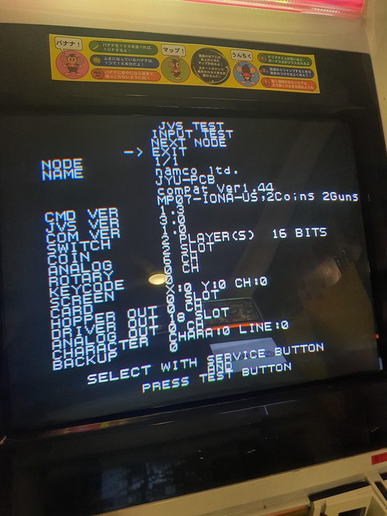

  4. Since I updated to 1.44, I was able to toggle between "JVS data signal level adjustment" when pressing TEST while plugging in the power
I noticed when it works, the MP07 LED flashes quite quickly and then it'll be come solid when the Naomi logo loads up. If it's just blinking like in normal mode, then it never works, I simply unplug power and reconnect using the TEST mode and restart the Naomi.
I've currently got the MP07 plugged into a mobile phone charger, but I will look at looking for another 5v location as the normal CN12 is already being used for either my Pi or a CF card reader.
I actually don't know how to "enable or disable" the options I think I fluked it as I was able to cycle through Sega JVS and Namco JYU jvs
I haven't tested it any further on my Naomi 2 and/or with other devices as I'm still trying to digest what it was that I did to make it work and hopefully it keeps working :D
All those guys having issues with Naomi's, please see how you go with updating the F/W and seeing what behaviour the PCB does when turn on the naomi - remember, if it's fast blinking - it should get a steady led once the Naomi load screen shows up and it'll show up in the JVS test menu. If it's just normal blinking, unplug the power, hold test when you plug power in and reboot the naomi (this is of course if you're on 1.43+)

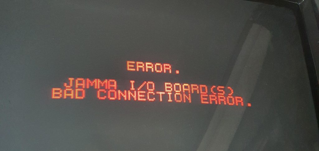

  7. Loaded MVC2 to play with 2x VSHG's in P1 and P2 - this has been tested operational in the JVS test menu
    • Added credit with select on P1 with the VSHG, pressed start to initiate the game and selected characters
    • Added credit with select on P2 with the VSHG but couldn't press start for a P2 match, couldn't get P2 to work
    • After 30 seconds playing the game received this error
At this point I gave up. I was using a power brick so the power was constant, I was using the shortest JVS cable I had and the unit was secured and stationary. I wasn't up for re configuring again things again. I've spent way too much time on this device that I was expecting to be a plug and play type of device. I may revisit at another time. OpenJVS is working better for me albeit you require a pi for it.
Have you tried the device with the suggested supported controls. Such as a Xbox 360 pad?
It’s also a somewhat known anomaly that some Naomi systems aren’t compatible with the device it seems.
This issue and requests for certain stick / adapter support should be sent to Toyoshim via GitHub.
Yeah ok. I guess Hori fighting edge isn't a compatible stick - i'll submit it to Toyoshim.
360 pad worked but has to be reconfigured and it did the same thing to me like the fighting edge. It got all confused, button mapping was all over the shop .
Compatibility to the all my naomis seem to be functional during jvs testing, it's just all the fluffing around with the different sticks - I would expect once a particular stick is configured, that's it and there's nothing further.
I will force the brook UFB to 360 mode and see how it goes. Losing the config of a previously working stick is what's really annoying.
