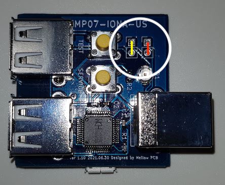

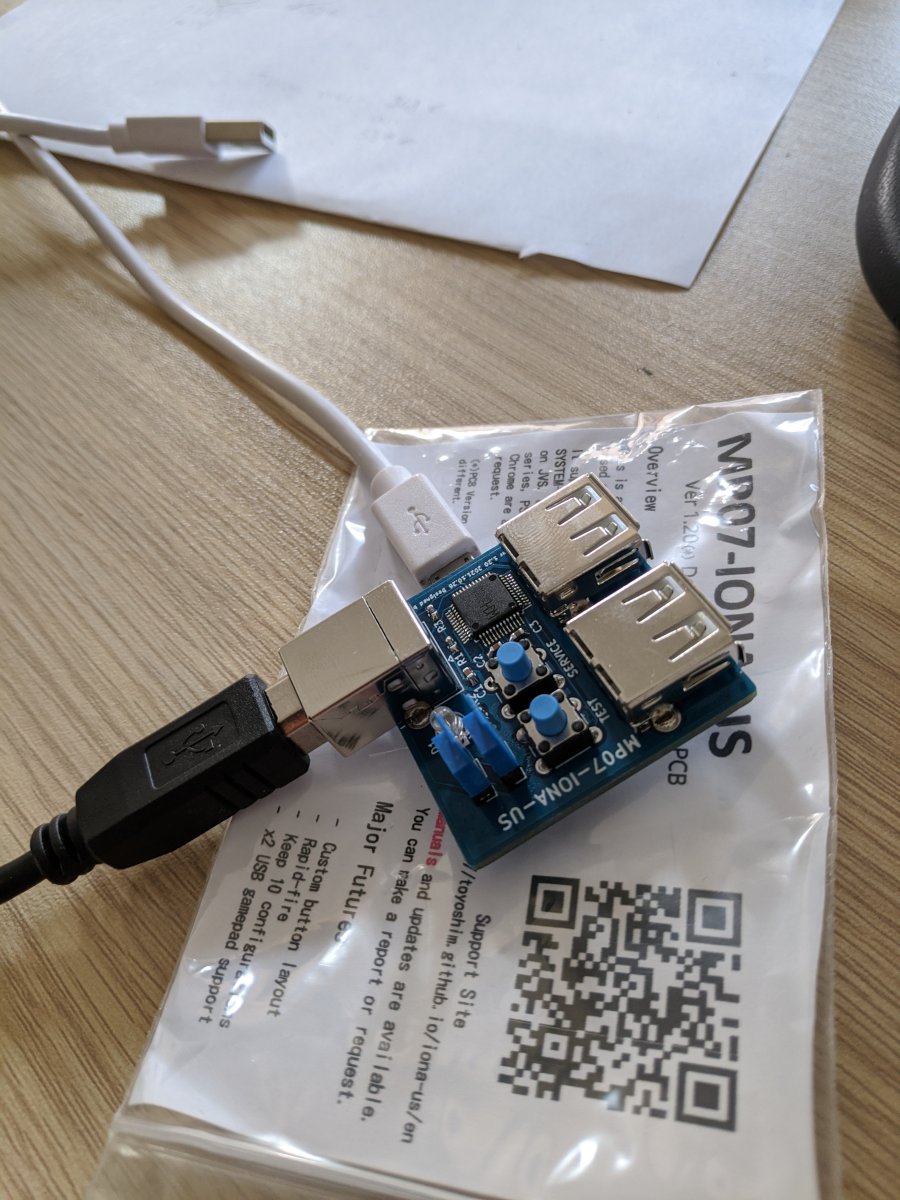

to be frank I read the fw update process 3 times, I don't understand what I'm supposed to do or plug... (so I plugged held service button, plugged jvs (usb data when jumpers?) then micro usb (power?)
I have my pc open on the flashing page and the device manager and get nothing at all.
(just micro usb without jumpers plugged in gives me a blinking blue led so I guess I didn't fry it at least)
don't want to sound entitled or anything but I don't get why there's no jumper pins in there in the first place, with a couple jumpers (because you can just do all this without this and use a A to A usb cable I guess? no super clear either, a picture or video would be useful)

got the updating part to work partly thanks to @ShootTheCore (thanks man deeply appreciated!) and partly due to using a different pc and holding the service button for the whole process of plugging both usb cables to the computer, also for some reason I still can't see the device in windows device manager in the first computer I tried, so you might be SOL like I was before and I still don't know why...
Any how, I will try to make a quick tutorial on how to do a FIRST TIME fw update :
(after that you'll only need to bother with the windows device manager and choosing drivers if you use a different computer or windows install, to update the fw of the board)

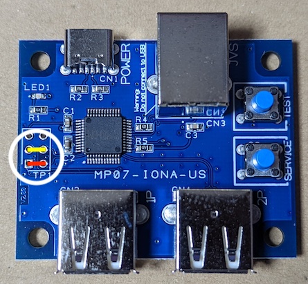

1) bridge/ use jumpers there :
3) on a windows computer open : https://toyoshim.github.io/iona-us/firmware_en in CHROME (make sure you didn't block chrome notification windows service if issue) also,
open Windows Device Manager (right click on the windows flag on the lower left corner by default>Device Manager) (collapse everything in Windows Device Manager if needed to see the bottom of the list)
4) HOLD SERVICE button one the MP07-IONA-US JVS/USB I/O Board
5) plug the micro usb (or type-c if you have the newer model) cable to a usb2.0 or lower port on your computer (alternatively, you can use a beefy enough charger here)
6) KEEP HOLDING SERVICE button
7) plug the JVS port (USB type B) to a usb2.0 or lower port on your computer with a usb cable known to have the data wires (not only the vcc and gnd wires))
8 ) IT WORKED ! you can now let go of the service button because you just heard windows notification sounds (I heard a set of 2 I think) that are usual with plugging/unplugging usb stuff

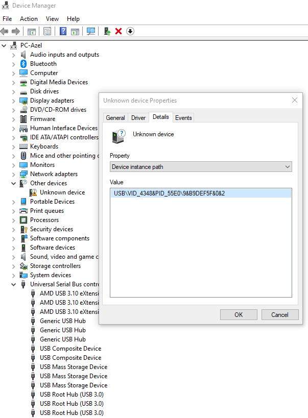

9) in Windows Device Manager, right click on the new unknown device that just popped up, right click, go to the details tab and check that the property of "device instance path" has the same VID/PID as on this picture (if it's not, you are looking at another device inside or outside your computer but plugged in and not working, so something else completely)

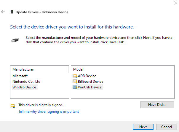

10) if your VID/PID matches, hit cancel, and right click again on the same item but choose Update Drivers, then :
  1. In the wizard, select Browse my computer for driver software.
  2. Select Let me pick from a list of device drivers on my computer.
  3. From the list of device classes, select Universal Serial Bus devices.
  4. The wizard displays WinUsb Device. Select it to load the driver. (Hit next)

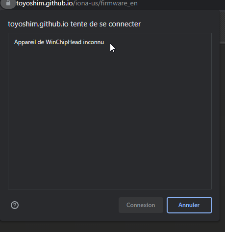

13) you should see something like this in the top left corner of your Chrome window Unknown device from WinChipHead
(sorry for the french, running an english install of win10pro, everything should be set in eng...anyhow.)
14) click on Unknown device from WinChipHead

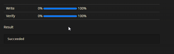

15) hit Connection button, and you device should flash :)

17) REMOVE THE JUMPERS
18 ) I'M NOT KIDDING, DO IT BEFORE YOU FORGET

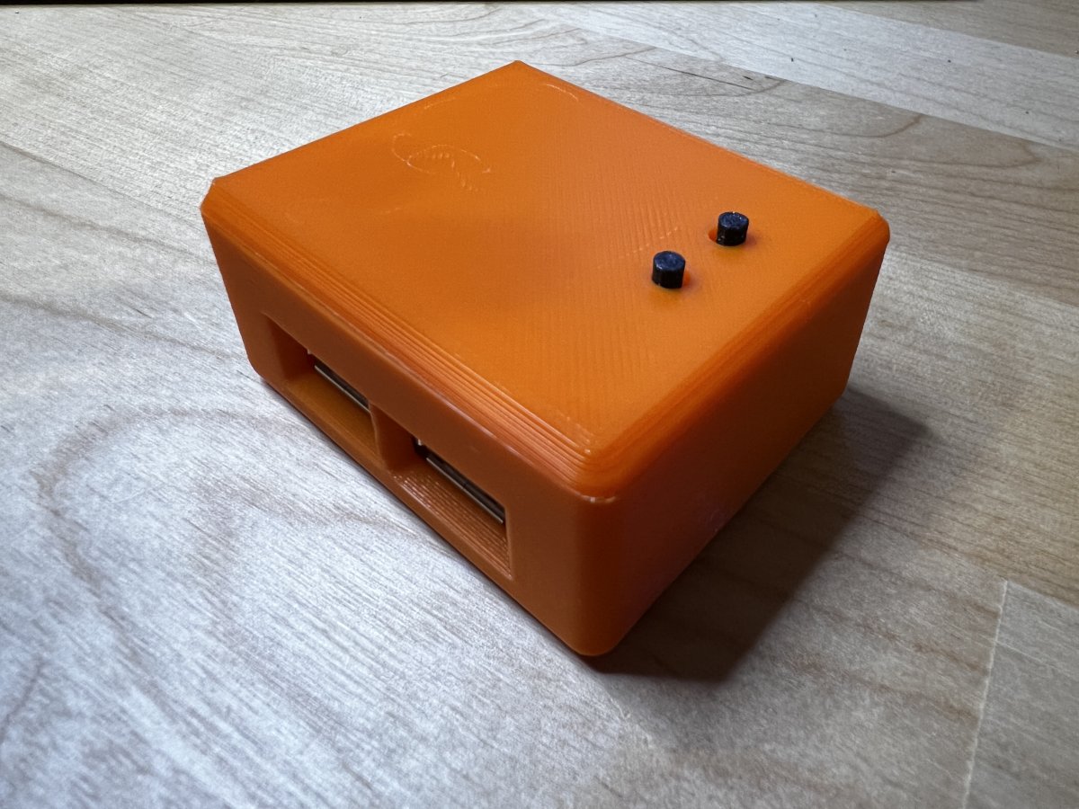

I don't wanna derail the thread too much, but... anyone willing to print a case for a V1? If so please shoot me a PM.
Thanks!
I printed mine at https://printathing.com/
Surely if you can get someone to help it would come out less expensive. I personally thought that price was fair all things considered.
Eeeek! That's too much imo. Did you want ABS in particular?

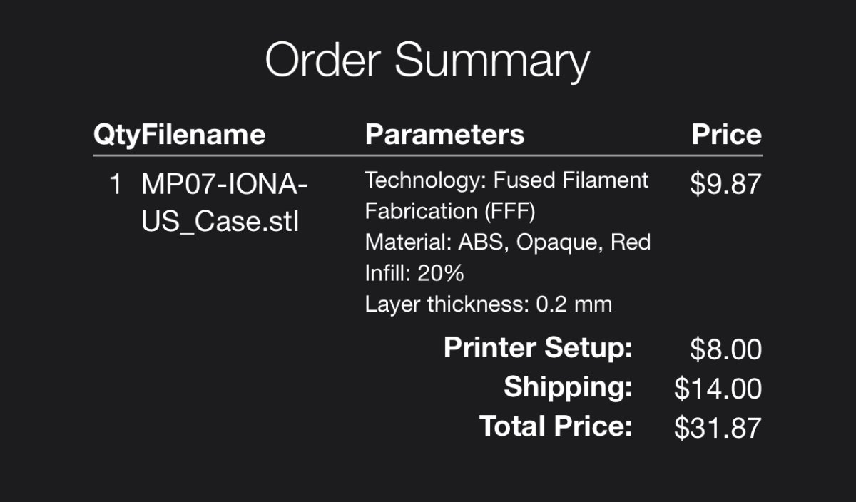

Here's my receipt for 5 prints from craftcloud, just one of them was the MP07 case. $22.72 shipped for everything.
That's an even better deal. Print a Thing didn't have PETG as an option actually. LOL. I'm also not well versed with 3DPrinting. PETG was the recommended filament from Zephrino's instructions. I'll take a look at CraftCloud for next projects.
TBH it didnt really dent my wallet, i agree better more cost effective places to print :D
Right on. I shopped around a bit because I don't have the space or desire to own my own 3D printer, and I looked through several different services. I like this one because you pick materials and it gives you a list of companies and their prices to print it. Kinda a middle man situation but a good one; you can pick any plastic/color/etc and see your options. Honestly, with it like that, I have little desire to own my own printer right now.... I would go crazy on accessories and stuff lol.
Thanks for the recommend on CraftCloud @skate323k137 . I just ordered a V1 case through them with PETG material and the total was $12.34 after shipping.
Yea this is awesome! Thank you again. Looking forward to V2 print now

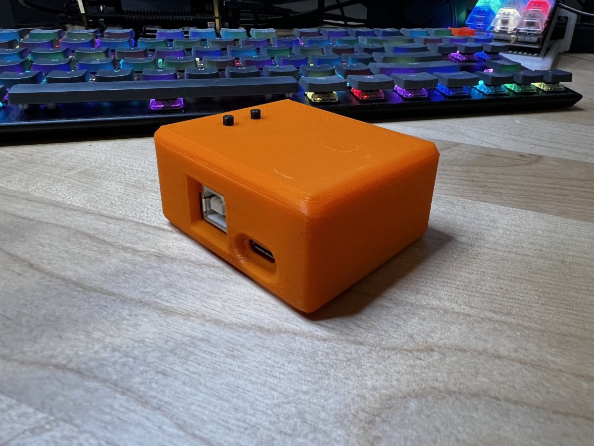

I was inspired by an earlier post and made a case for the USB-C version of the board. It is very BETA. I need to make some minor adjustments and there are some features I would like to add (lightpipe for the LED and a better top). I put the files online for any one to use.
https://www.printables.com/model/159069-mp07-iona-us-usb-c-case

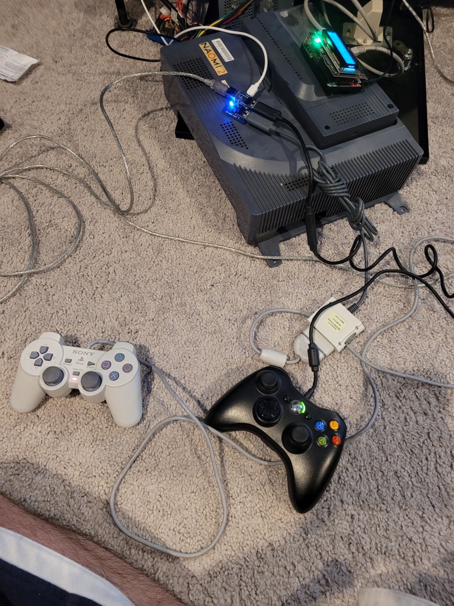

Finally got around to testing very briefly the v1 board I recently received. Only had a chance to try it on Naomi 2 and even then, just some digital control games. Works perfectly with the two controller options I quickly had on hand:
  • PSOne OEM pad via Xbox 360 converter dongle
  • Xbox 360 OEM wired pad
Tested on Marvel vs Capcom 2 & Capcom vs SNK 2 (the latter of which is a game that seems to be very picky about the IO board connected), results were good. No issues at all detecting the IO board and each digital signal worked. Default button mapping is a bit strange for the action buttons (directions, start and select operate as you would expect, with select = coin) but at least consistent between these two tested controllers. Hopefully it is straight forward to remap buttons as needed.
It's a good start so far, will definitely test further as my availability allows moving forward and I hope to see this product mature over time in both firmware and possible hardware revisions. Not looking forward to the firmware update process based on what I've seen in this thread but on the flip side I'm thankful for the 3D print case ordering info that has been posted. That's the next item on the agenda for this device from my end.
