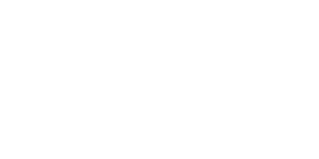

So right after posting this I flashed to 1.41 and used the options mode to set the "Inactivate JVS data signal level adjustment" option. You have to go into the options mode and I had to hold the B/red button on the 360 pad while deactivating the options mode. This apparently was all it needed. JVS Test picked it up and I was able to play Ikaruga and Gigawing 2.
Hello, I have same problem,
Noaomi2 and TTx2 "i/o error".
I have update to 1.41 but I realy don't understand how to reach the good "menu"Inactivate JVS data signal level adjustment".
1-I've pushed Test&service=the led flash FAST (Layout config mode)
2- push test= Led flash Slow (Rapid-fire config mode)
3-, push test= Led flash Slower (Speed config mode)
But how goes to "⑧ Options config mode (LED - blink)" ?
Thanks

I followed the input map for 1.40. I think it is test + service > test > service > test > test.
Thanks, I've done that and pushed "b red button" on x360 gamepad.
Is there an indication if it's on or off ?
Does this setting remain in memory after shutdown?

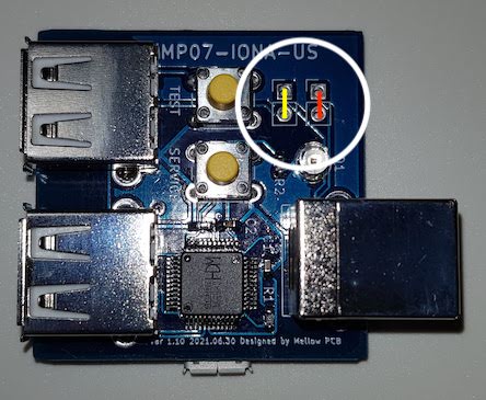

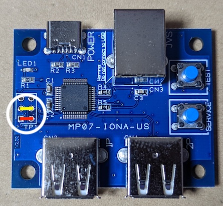

1) bridge/ use jumpers there :

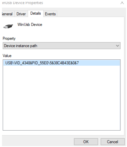

9) in Windows Device Manager, right click on the new unknown device that just popped up, right click, go to the details tab and check that the property of "device instance path" has the same VID/PID as on this picture (if it's not, you are looking a another device inside or outside your computer but plugged in and not working, so something else completely)

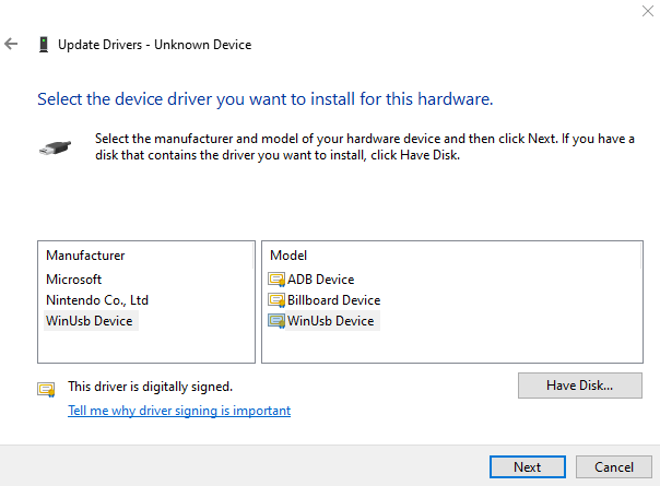

10) if your VID/PID matches, hit cancel, and right click again on the same item but choose Update Drivers, then :
  1. In the wizard, select Browse my computer for driver software.
  2. Select Let me pick from a list of device drivers on my computer.
  3. From the list of device classes, select Universal Serial Bus devices.
  4. The wizard displays WinUsb Device. Select it to load the driver. (Hit next)

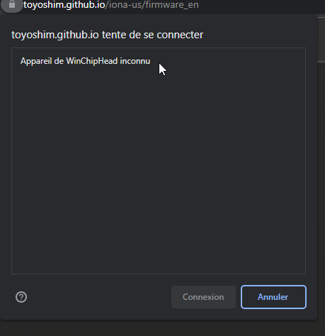

13) you should see something like this in the top left corner of your Chrome window Unknown device from WinChipHead
(sorry for the french, running an english install of win10pro, everything should be set in eng...anyhow.)
14) click on Unknown device from WinChipHead

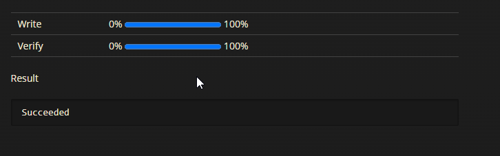

15) hit Connection button, and you device should flash :)

17) REMOVE THE JUMPERS
18 ) I'M NOT KIDDING, DO IT BEFORE YOU FORGET

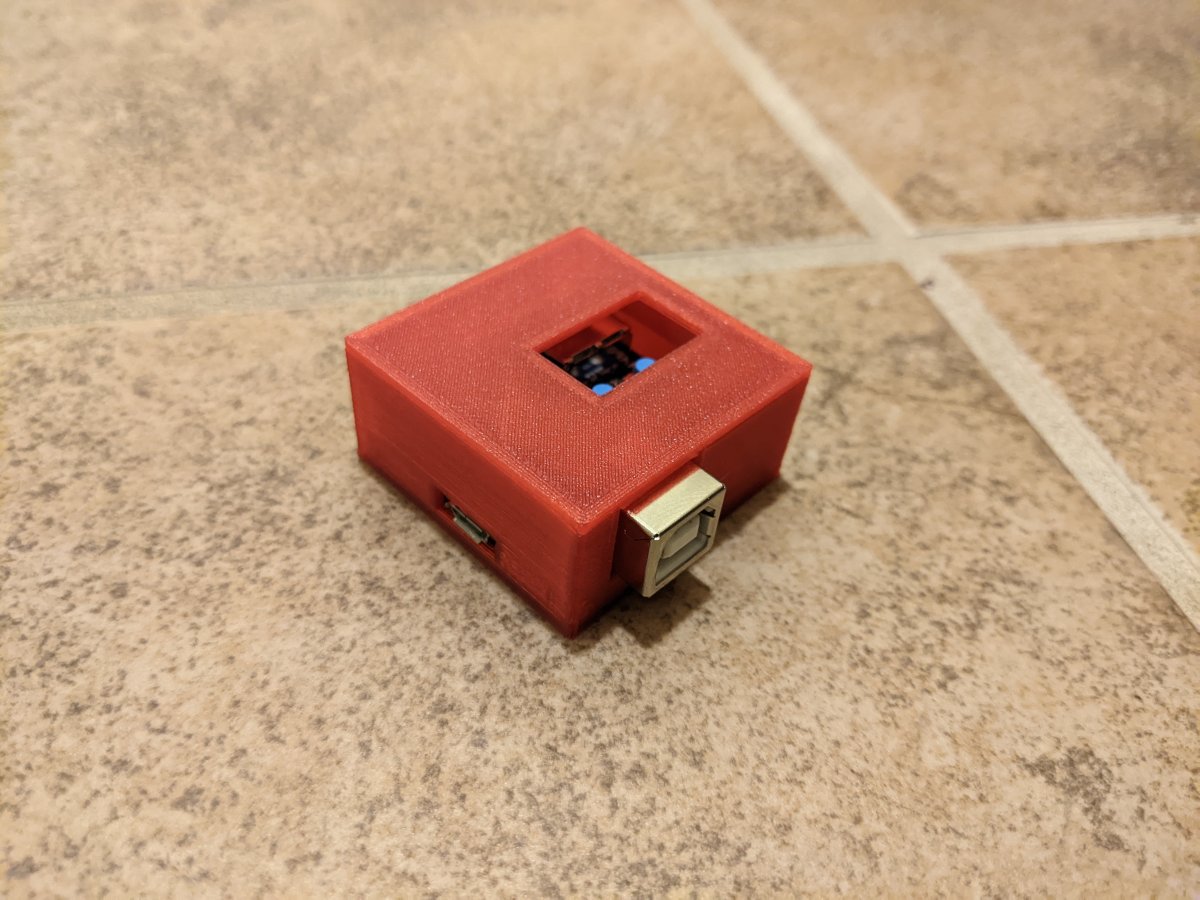

I also got @/buffi's case design printed through Craftcloud! Thanks to @/skate for the reco, printathing was substantially more expensive and the guy answering their support emails is a little condescending. :/ I used a translucent red with 20% infill, I think it came out pretty good. I wanted a different color but I was printing out other stuff and I didn't want to eat the fees to setup and print using multiple colors :P
