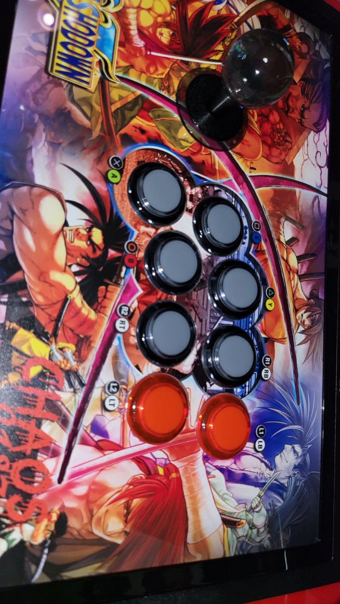

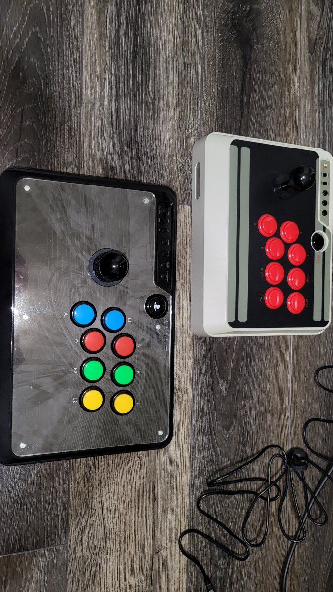

Alright guys. So these two sticks I can confirm are working with no issues. No lag that I can tell. We have a Venom PS3-PS4 and NES30 Arcade stick.

Unfortunately it will not let me map strong kick to the R2/RT button. I can only map it to L1/LB on the Mad Catz XBOX ONE TE2.

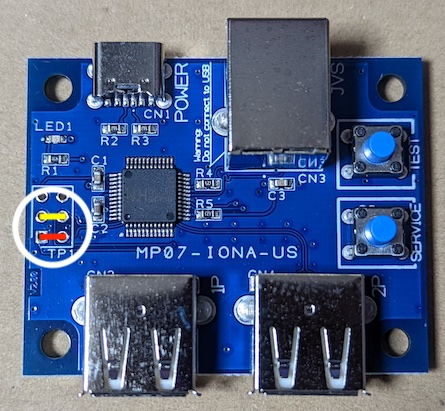

Hello,
I have a problem with my card.
I wanted to update it and I deleted everything.
The card is no longer recognized by my PC and it shows me error 28.
Can someone tell me how to reinject the driver of the card or the procedure so that I can do an update again.
The card is no longer recognized by my naomi and displays error I/O Board
Hello,
When you set it to update mode, did you remove the bridged pins after?
