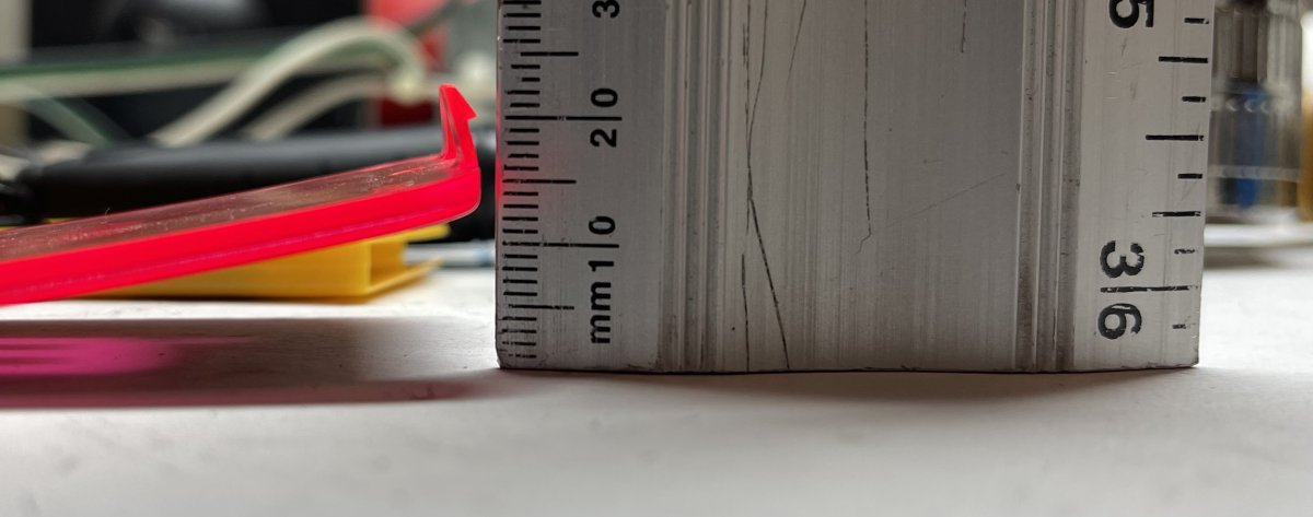

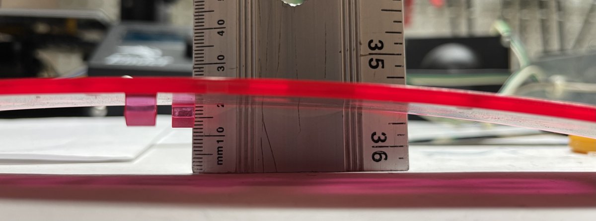

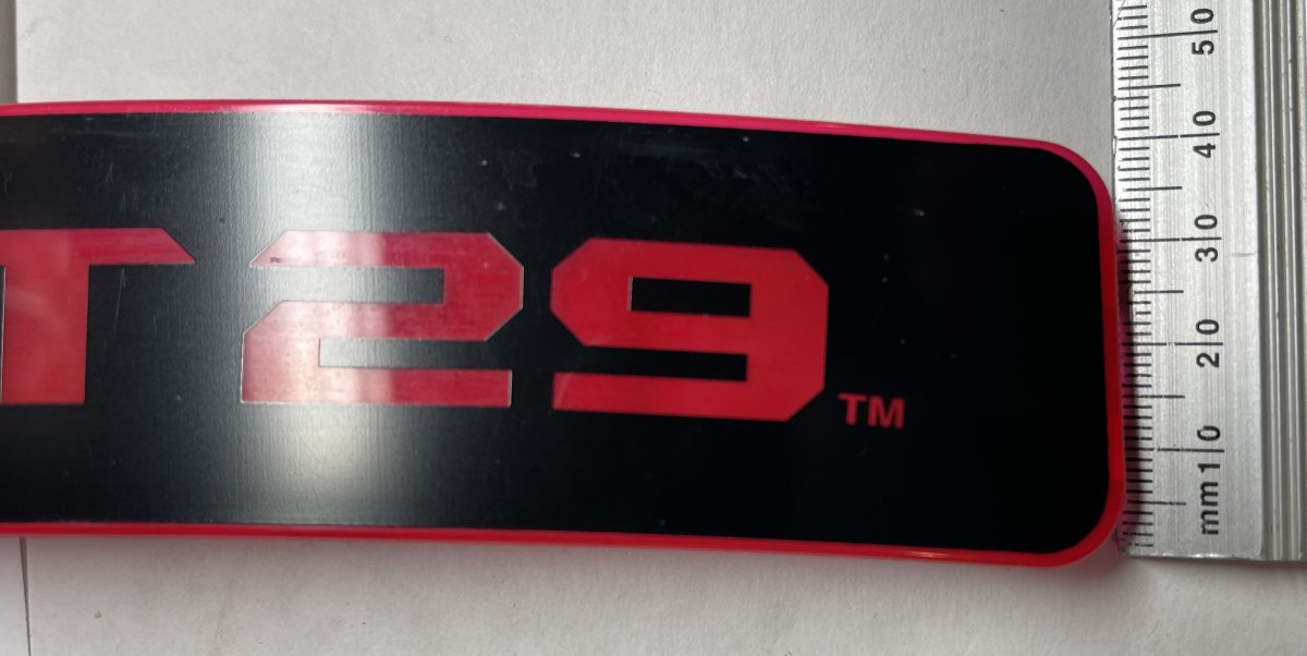

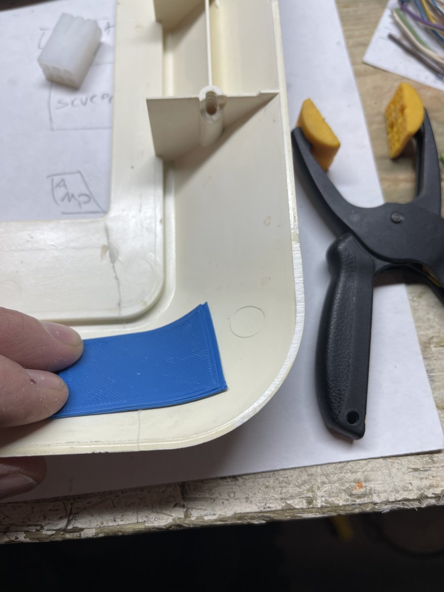

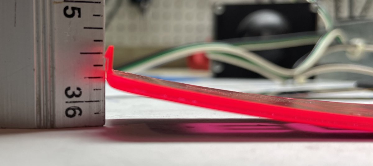

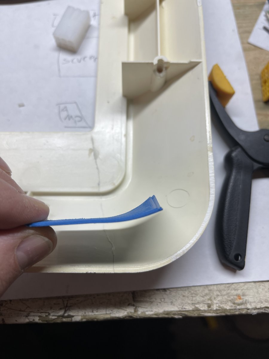

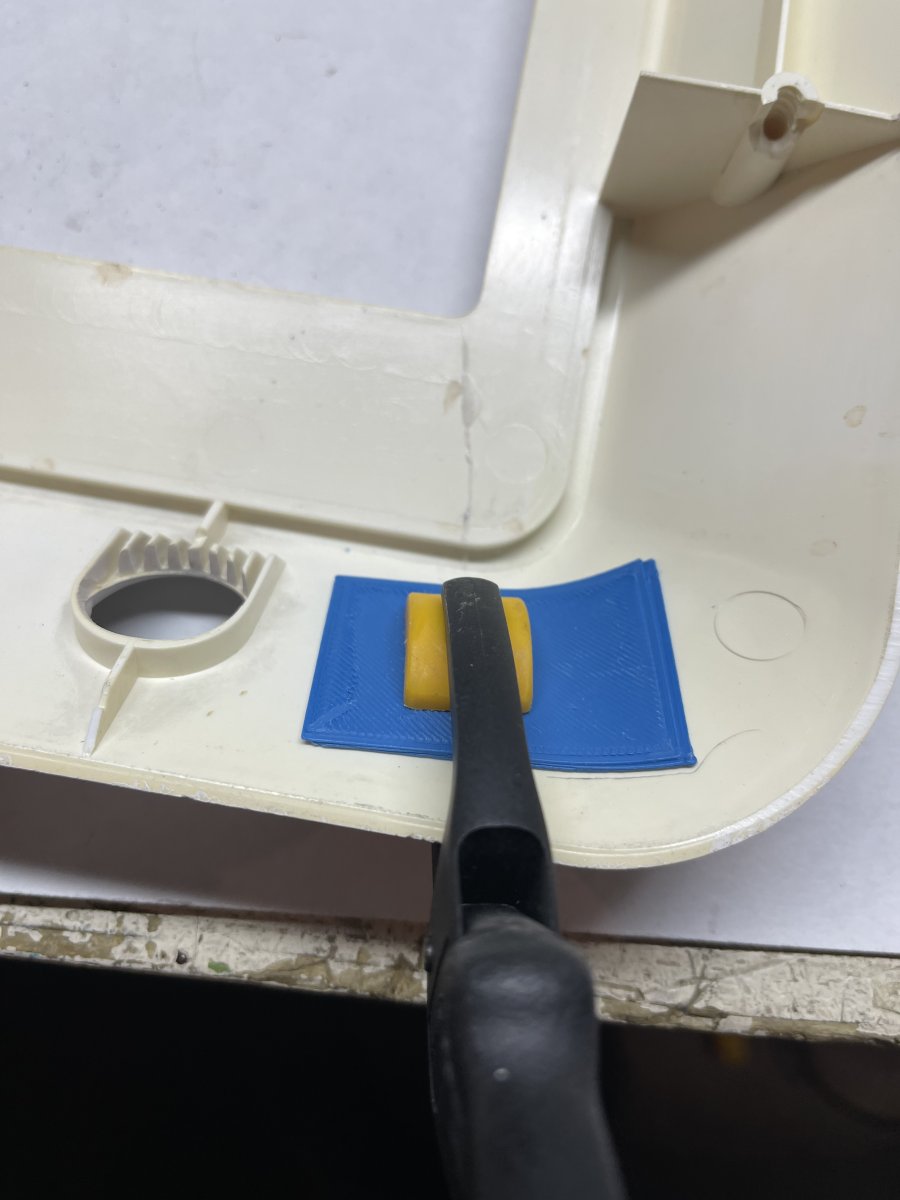

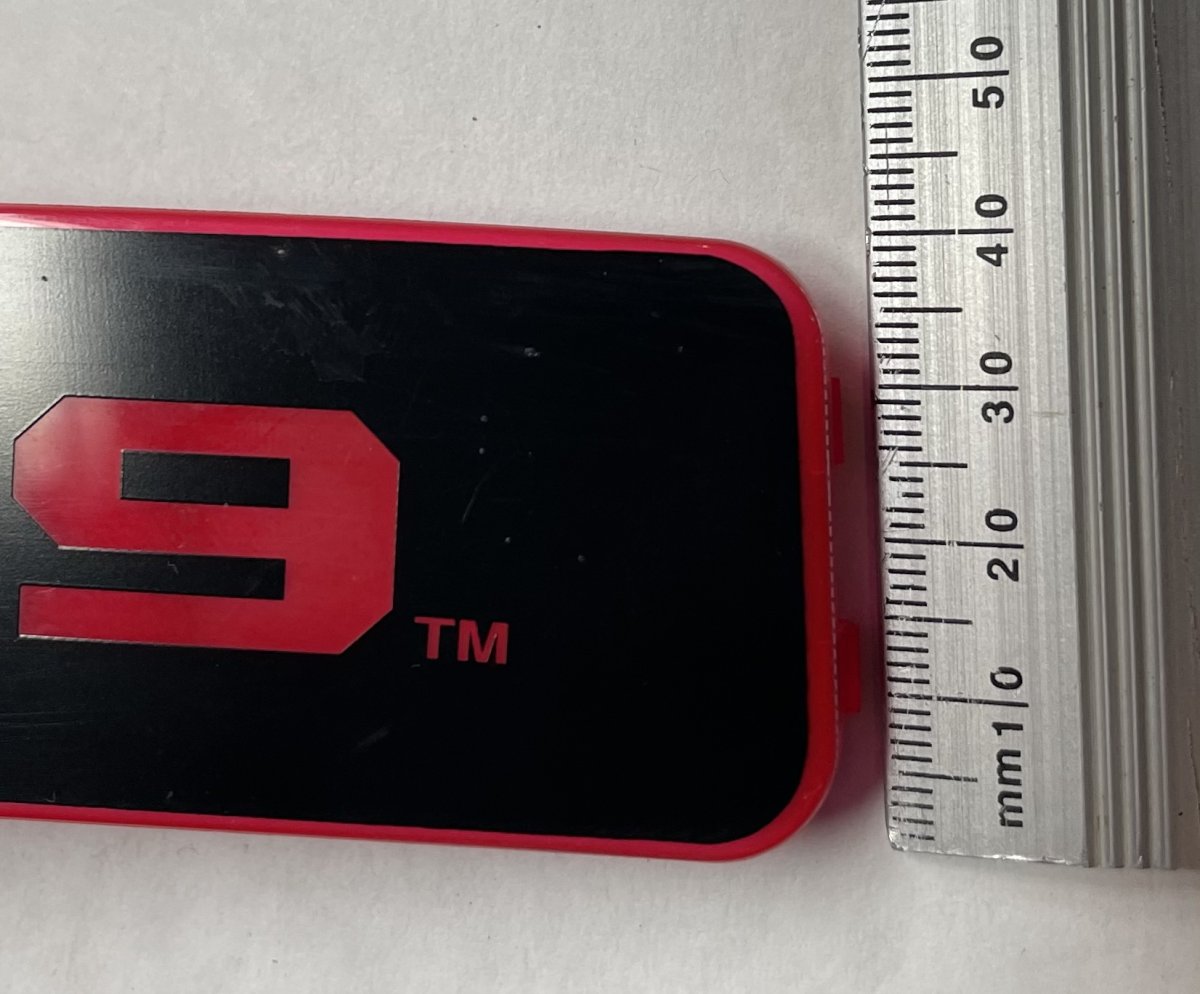

for now though I made a small 3D printed insert for the IR window and placed a button there for adding credits.
Turns out 3d printed PLA, just like cosplay foam, can be molded to a curve when you shoot it with a heatgun and let it cool in the curve.
I am thinking to print it in white, wider, and put the black jb weld underneath ? What do you guys think?

I like Waterweld but requires some keying. Any 2 part epoxy for plastics should work great. They some in white as well.

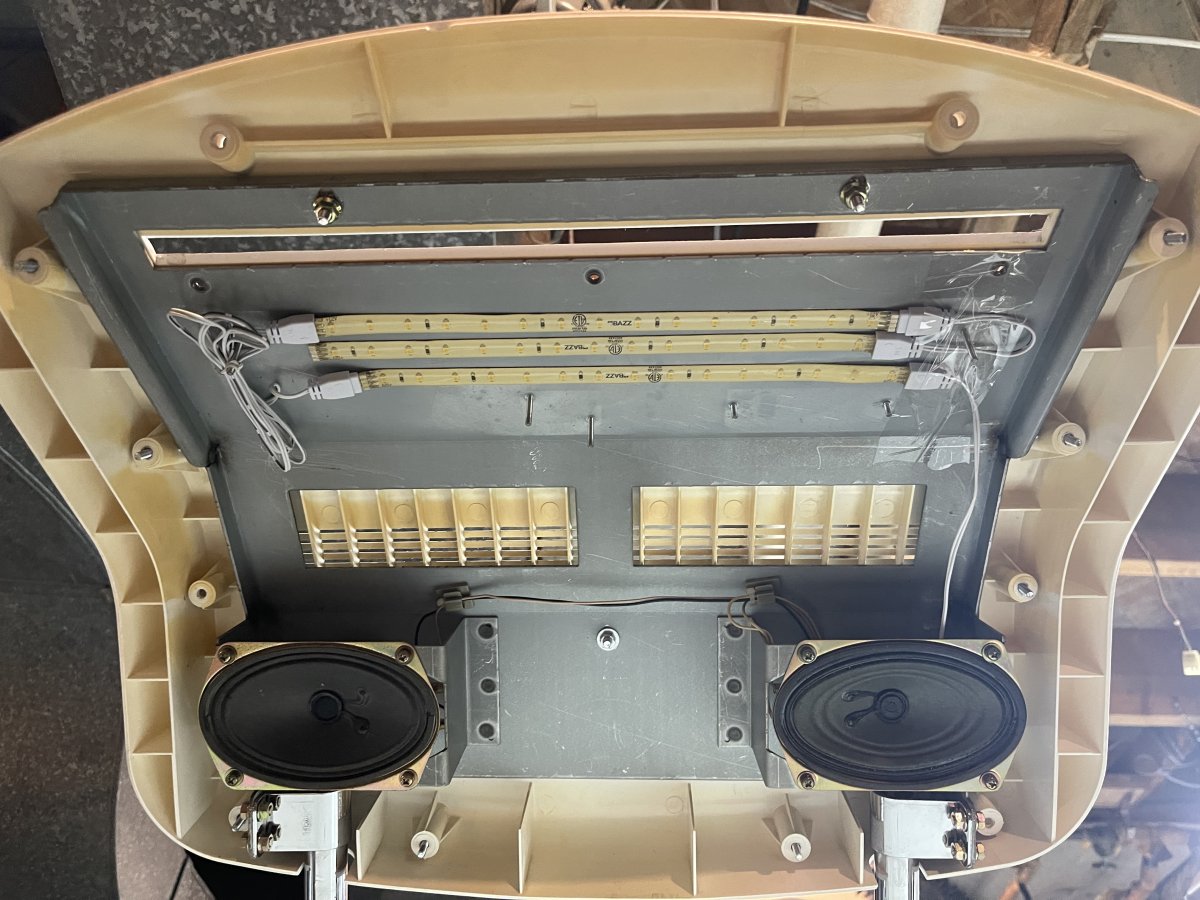

FWIW, those "gel" LED strips tend to turn quite yellow over even a short period of time due to discoloration of the silicone or whatever the rubber is.
