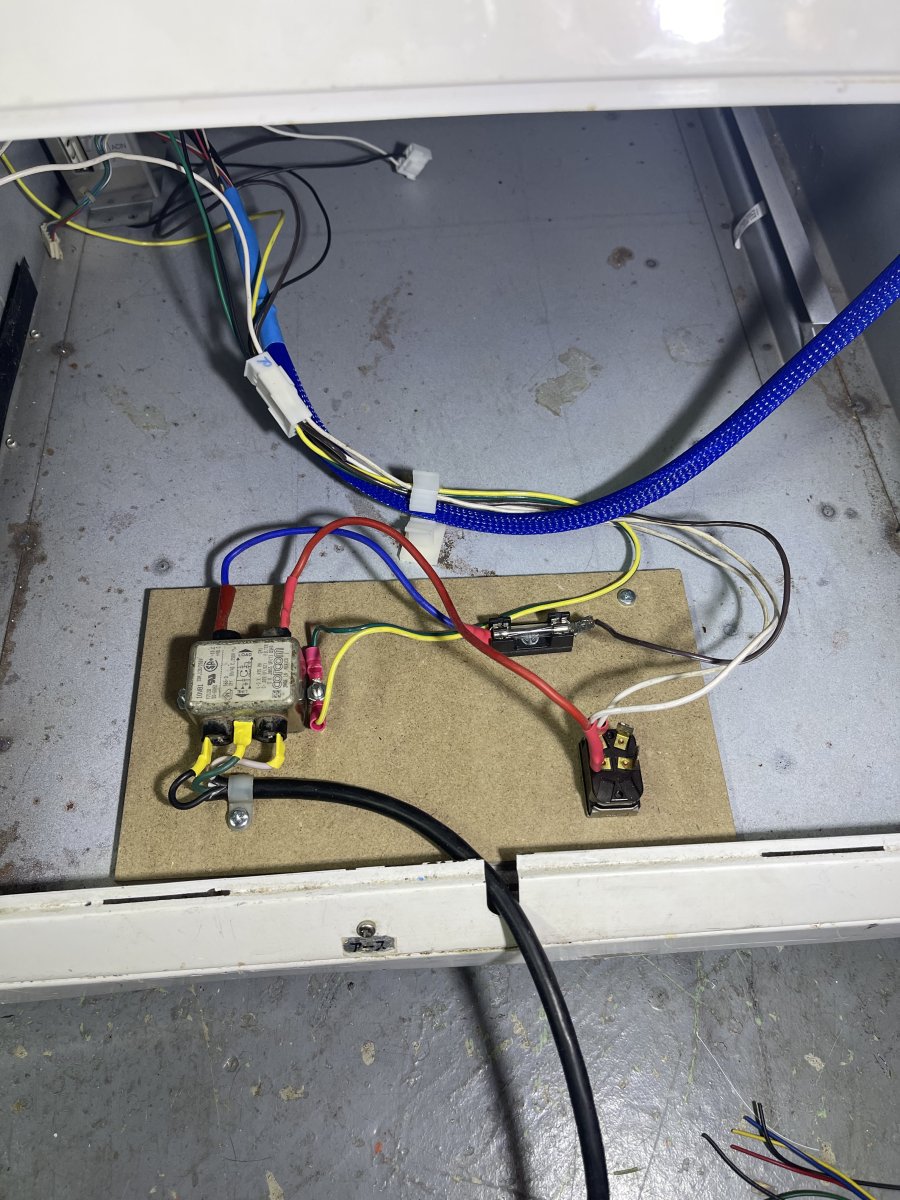

...and I am thinking of repurposing this pinball power box which has the line filter, fuse and service plug all done.
The box is unfortunately meant to be mounted on the side of the pin with the power switch underneath so I might have to be creative.

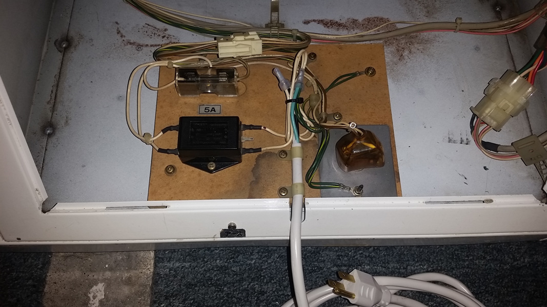

the original AC power panel would be very simple to recreate from scratch, it's basically just a block of MDF with some common off-the-shelf parts.

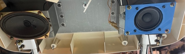

A replacement was needed for one of the speakers which was broken and "repaired and glued"... and sounded like total crap.
The 3x5 paper cone shielded speakers are on sale for 3-5 $ on ebay ... plus 30$ shipping ... or from parts express, it's 80$ shipping. And they are crappy 5W speakers and I wanted something "a little better".
Searched online and "3x5 + shielded" is really hard (aka impossible) to find ! All I could find was these paper cones.
Went to 2 local store, nope. nada. nothing that would fit.
Asked a arcade friend who ... has a tendency to pick up every free tv he finds so maybe he had such a speaker?.. nope.
Desperate, I started to look everywhere until finally, behind me all this time are these old little computer speakers...
just maybe they are shielded and could fit?
well yes with a printed adapter :
(yes I will change both...and have a spare)
Barely fits
and hey, it's a big whole 15W

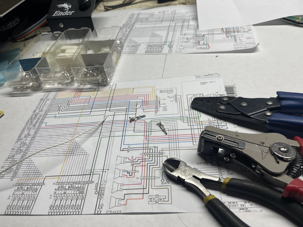

Now with @twistedsymphony colored schematics I am wondering if I should have a "high and low" volume instead of a left and right?
I'll go back to procrastinate on what to do next now.

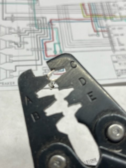

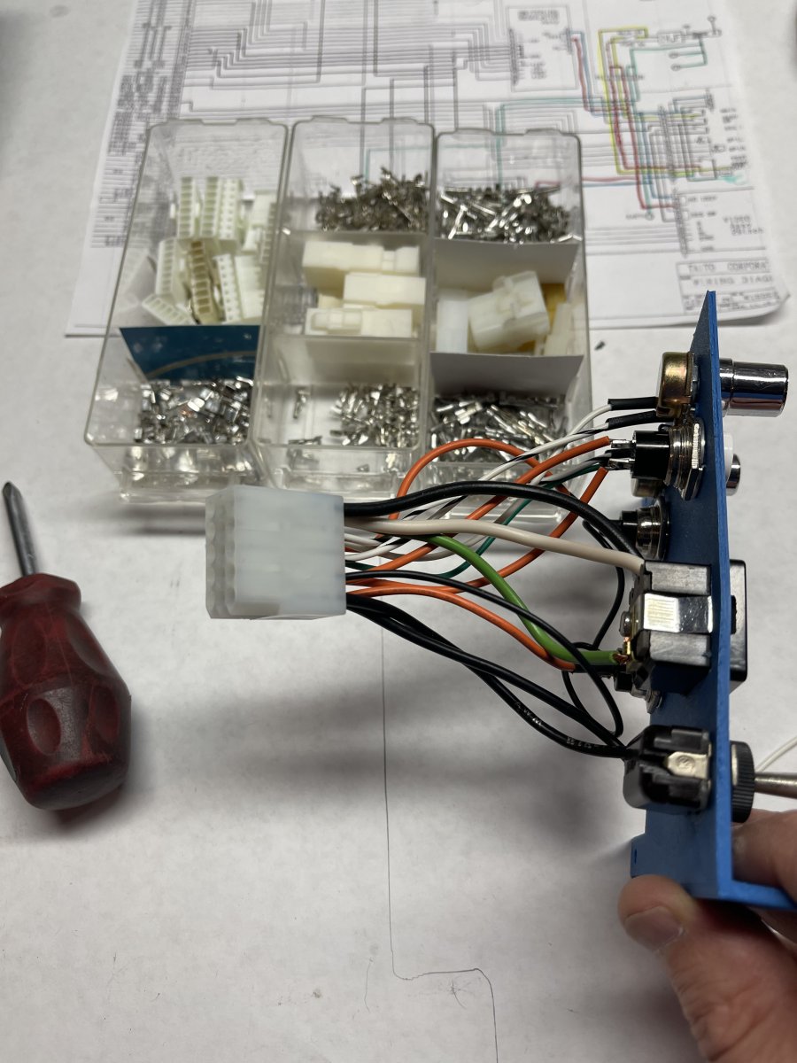

Crimp crimp crimp crimp …
Turn on. Blue switch bye bye! Hello new old switch!
And more crimp crimp crimp left
Thanks @twistedsymphony for that colored schema! 😵‍💫
Nice crimping man!
Do you you mind sharing a photo of the inside grooves of your crimping tool?
A weird request but it will instill confidence when I have to crimp my CP on the Goldfish catcher.
Nice crimping man!
the tool is this one : https://www.sargenttools.com/ToolsByTrade/Open_Barrel_Contact_Five_Cavity_Crimp_Tool/
I use E to do the "non insulated part" and C for the insulated part.
Works for me for pretty much all the connectors I use, which are mostly AMP UP, Molex and JST.

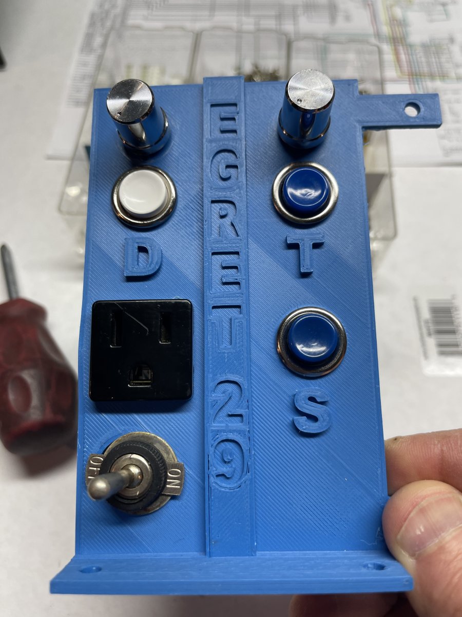

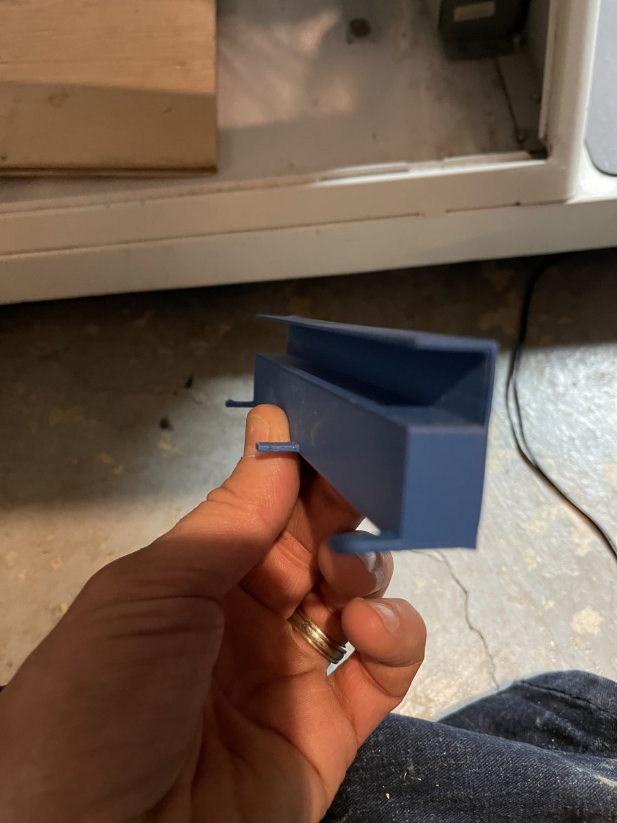

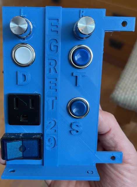

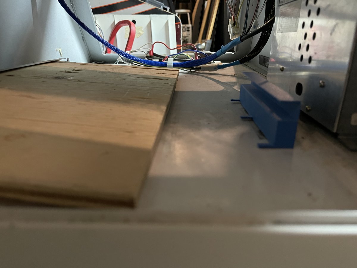

note to idiot self: make sure the buttons you're using are normally open and not normally closed X/
anyway ... remixed and reprinted and moved everything with new buttons...with reinforcements at the bottom (don't ask).
Of course not moving the top hole enough to make that remote board straight. OH WELL.
Ah Nice, I like how you moved the remote board down to there. The stock position was a bad choice, not sure what they were thinking with that.
