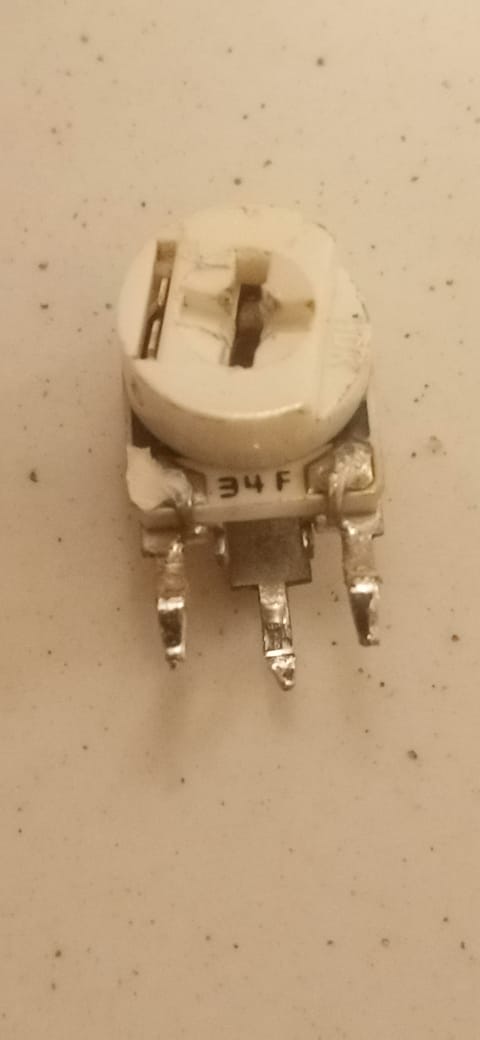

So my technitian said that the H.S.LIM pot is not working and needs to be replaced,
The pot value is 33k (even though it has 34F on it which i have no idea what that means) but couldnt find it anywhere, however found 30k, would that work? And if it does work will it somehow put the chassis or the tube on any kind of risk?
