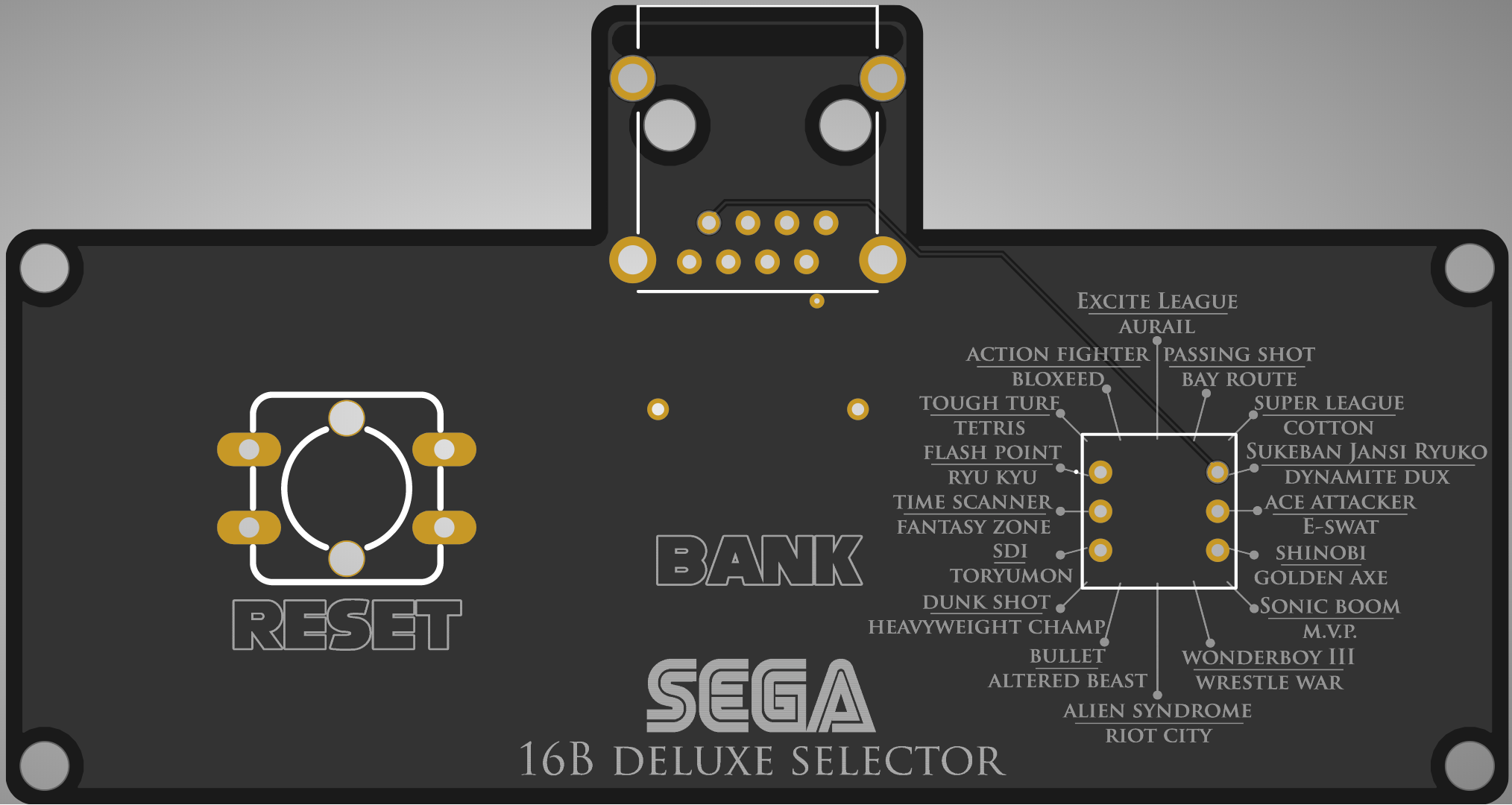

All design work and credit goes to @oneleaf86
Preview of the new and improved deluxe rotary selector.
Features:
  • Printed games list that lines up perfectly with the rotary switch positions.
  • Solderless install, literally plug n play with tidy & easy cable management.
  • Onboard reset.
  • Bank selection switch to cycle all 32 games.
Works absolutely perfectly!
I'll leave further details for @oneleaf86 to outline as this is his project, I'm merely testing as he doesn't yet have the wonderful S16 multi.

I do too. Looks like the game names are printed, which is nice. And Frank is claiming solderless, whereas I think the original version required one wire to be soldered for reset?
Regardless, I'd probably upgrade too because I'm crazy like that.
I’m looking forward to getting mine. The OG rotary selector is already a joy to use due to how quick it is to get to a game. Simply spin and hit reset. 2 banks of 16 games, having them labeled is just perfect!

Can you spin and hit the reset while the system is already on? I know Frank is working on a OLED version of the selector and the nice part of that was being able to change games without having to power cycle.
There's a certain charm keeping it rotary like this with labels though.
Yes, with the rotary there's no need to power cycle.
What I do is, with the system on and running, hold and keep held down the reset button - spin rotary to desired game - release reset button and boom game is loaded.
Have you tried rotating first, and then pushing reset?
I thought that was the idea.
But either way is fine as long as it works!
:D
Either way does work however I prefer to be safe and keep the system suspended (hold down reset) while changing the rotary. You'll notice it interferes with the game if you do it the other way, graphical glitches and lock ups etc.
