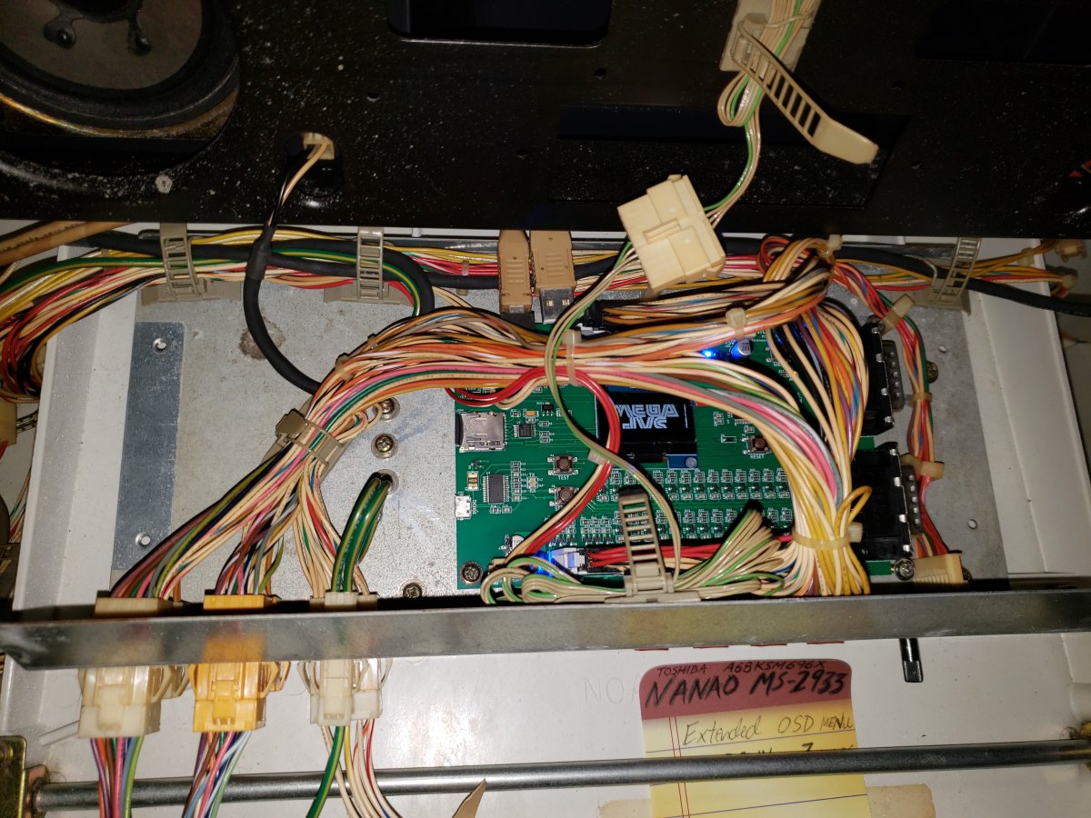

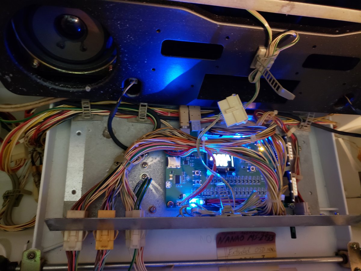

Got my Multi JVS installed into a Sega Net City (so swapped out a SEGA JVS I/O Type 1 for this). Aside from not having that extra USB port like the SEGA I/O boards have (I'm guessing for linking games?) and the two far right screw holes not being in the same spot as the Sega I/O, it's basically a drop in replacement.
Right now, I'm just using it with the default setting profile for the time being, so it reads as a Sega JVS I/O Type 3. Works great with a Naomi 2. Will eventually try it out with a Chihiro, Type X, Namco 256, and RingEge2.
I did tweak the DISPLAY.HEX file to get the little screen to show the correct direction for my cab. Haven't played around with any of the profile settings or anything like that yet.
All in all, definitely a cool piece of tech.
