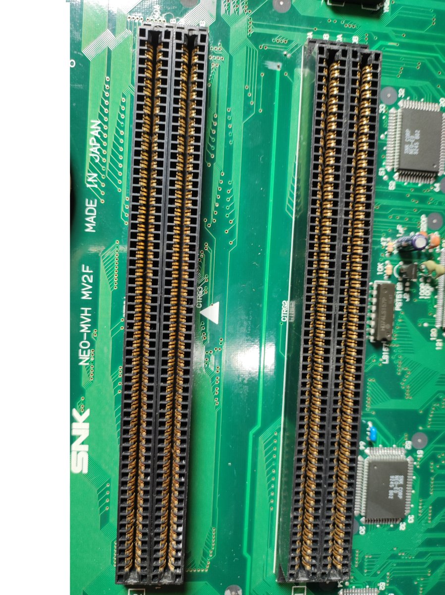

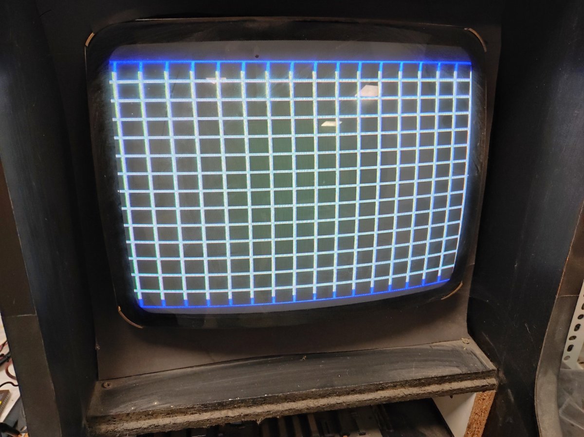

I have a MV2F MVS PCB. I put any game card in it, it just shows a grid image.
I cleaned both slots. I checked the corrosion lines. but I found no signs of damage. I took out the Diagnostic Rom. I see all tests as good.
Does anyone know what I can do after this?
Thanks

maybe you can see something?
it would be a lot of work to change the sockets :((((
which one should I start the exchange with?

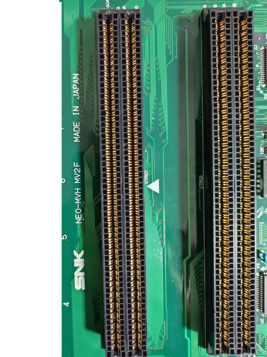

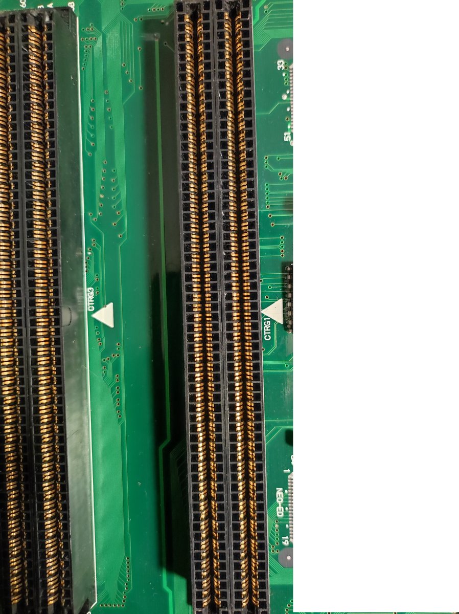

this pcb was put away in a box about 2 years ago together with a 4 slot mvs. both were still working. I just took it out and both were faulty. inserted cards do not start. I don't understand what could have happened.
I cleaned the sockets.
I thought I'd check it out. but all pins are in contact.

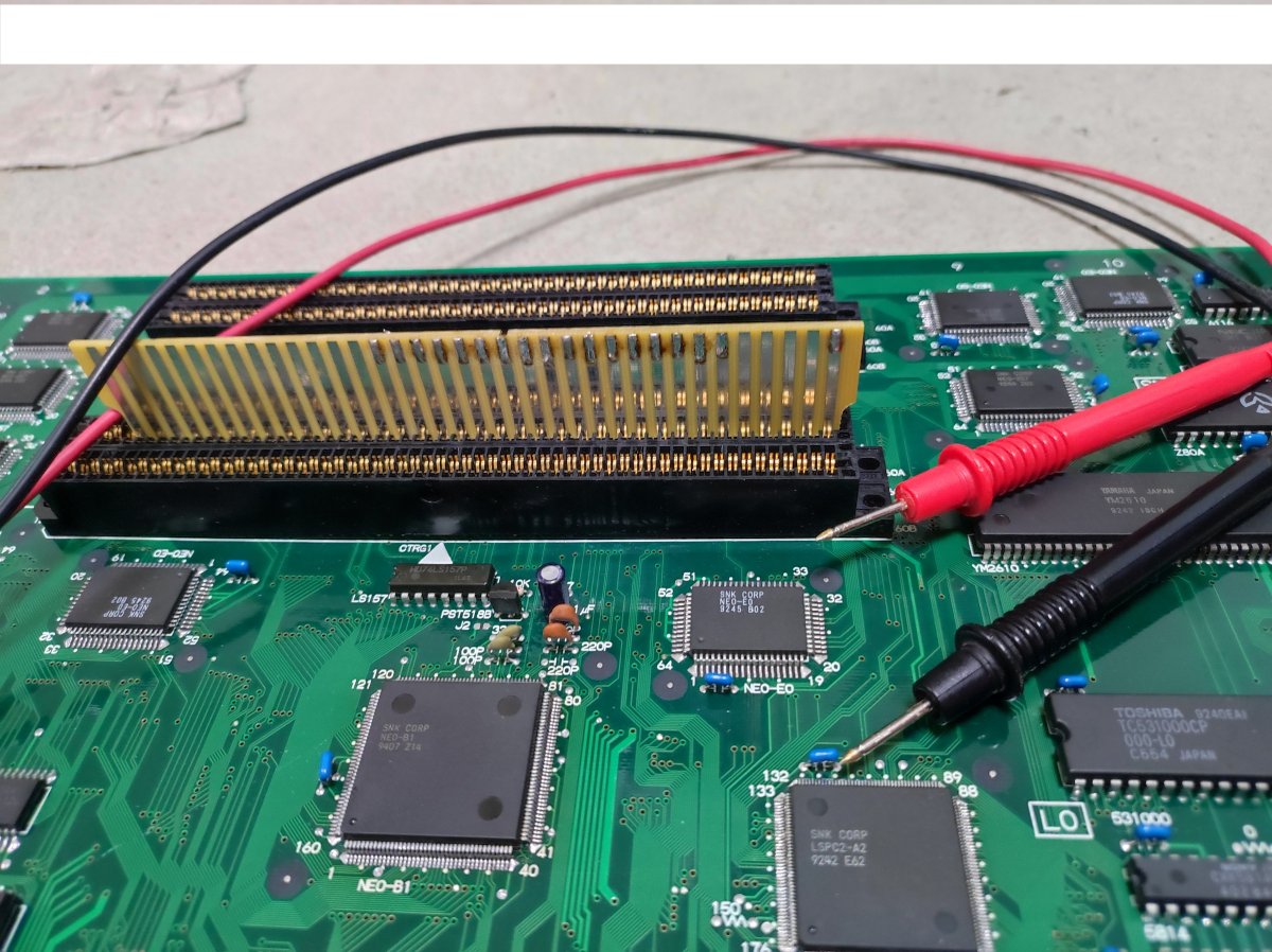

I used the multimeter on both sides of the pcb.
