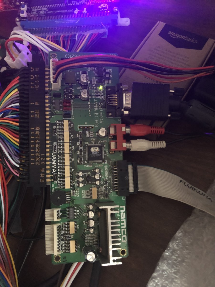

Question, what system are you using to boot Time Crisis 3? Just for reference, here is a boot up video:Using the board I posted
I will try again and leave it longer

The V291 pcb is the same thing as the V185. I’m not sure why Namco rebranded it. It seems to be a common practice for them to rebrand I/O boards. Also, Time crisis 3 will not boot on the Namco system 256. It will only work on the system 246.@Franco23444
That is awesome - I see u are using an 291 board

UPDATE: Time Crisis 3 is a no go here
Well, just about every 246 CD game will not work on the system 256. This includes vampire night and Ridge Racer V:Arcade battleAh that explains it - I am using a 256 right now
Good to know - i will modify the input file to make TC3 not playable on 256
