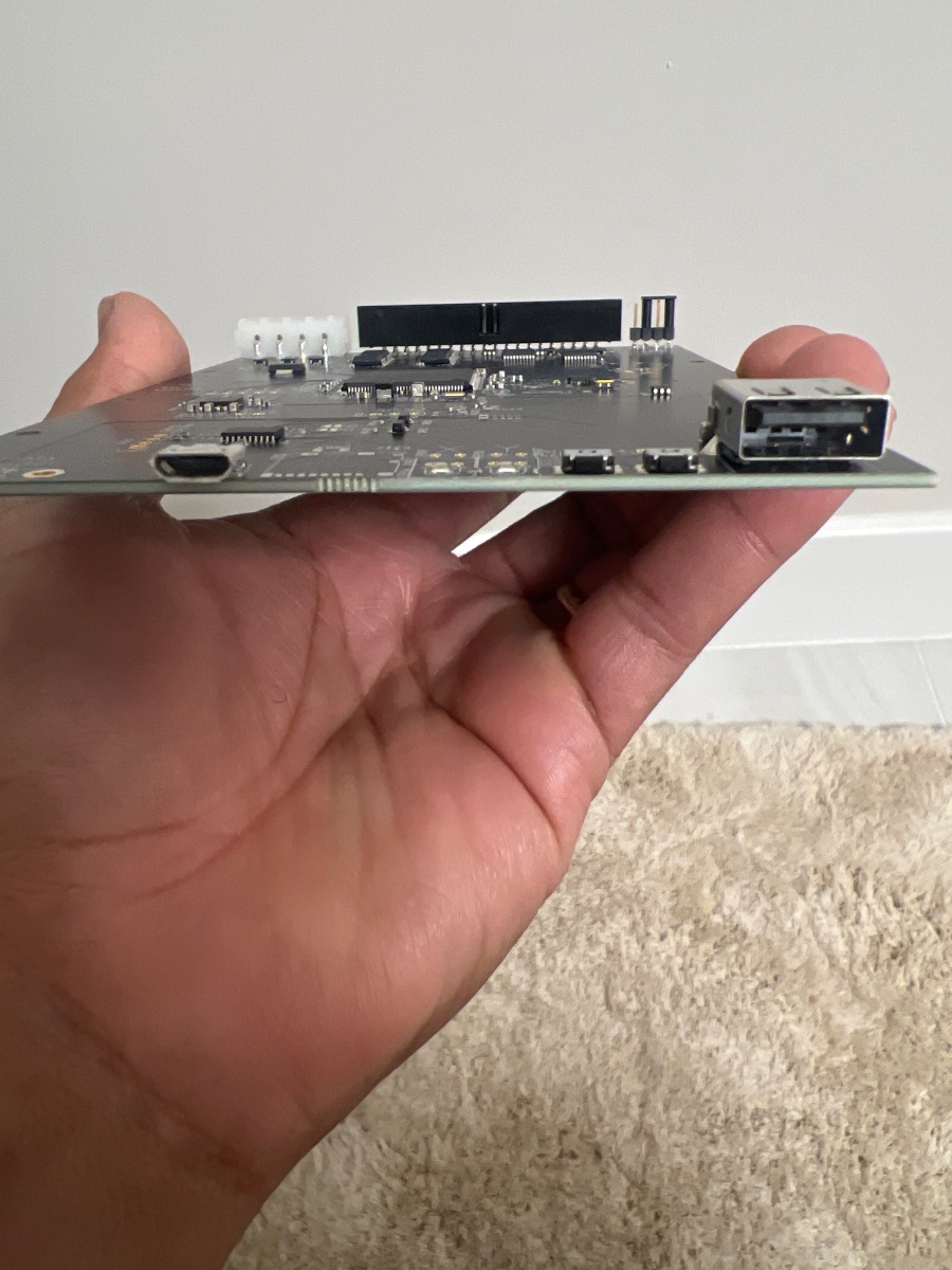

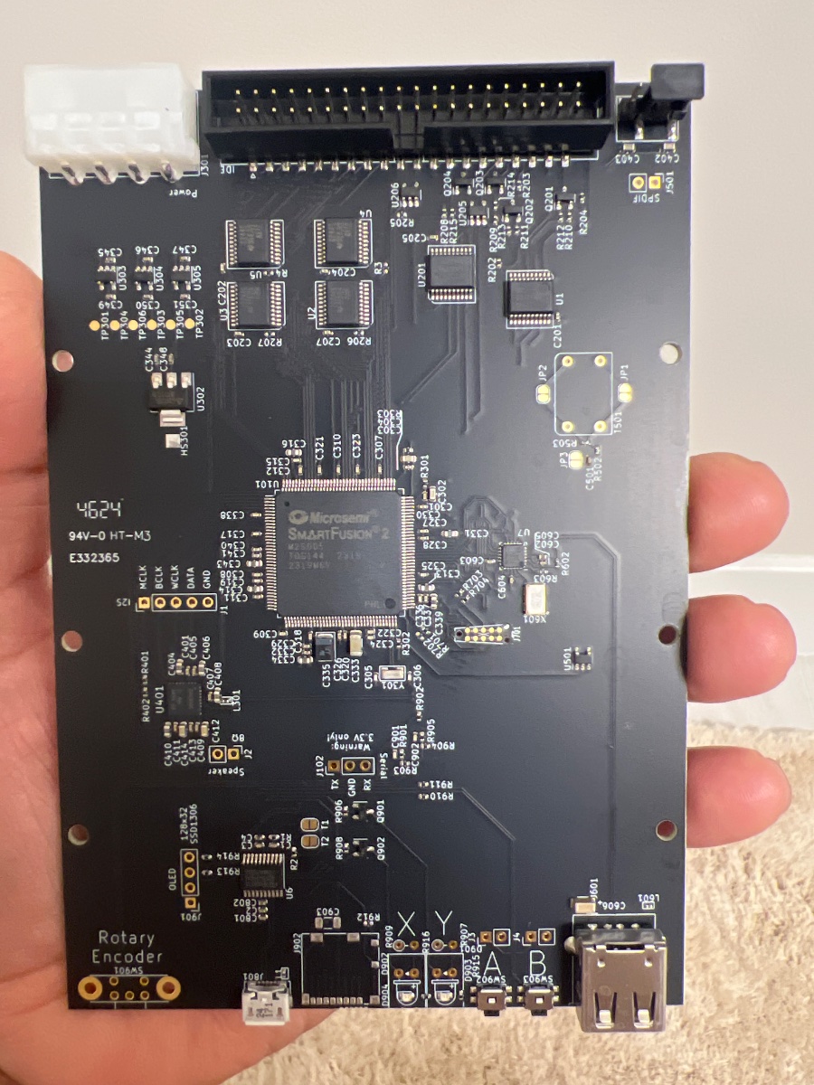

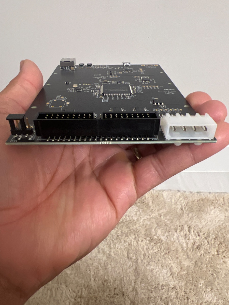

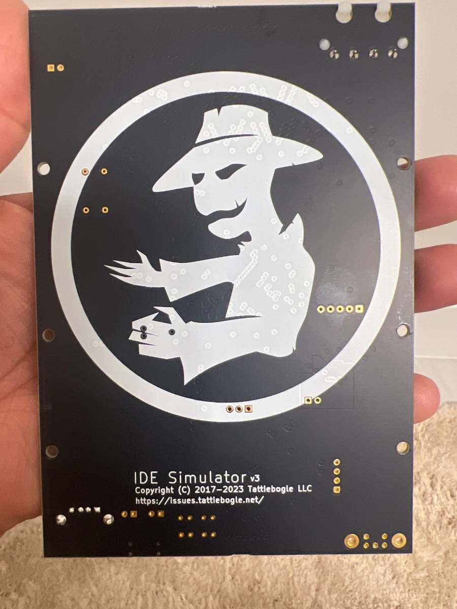

Got my ODE which is the last piece for this build came in yesterday. I am assuming it is a newer version as the ones I am seeing in this thread looks different?
