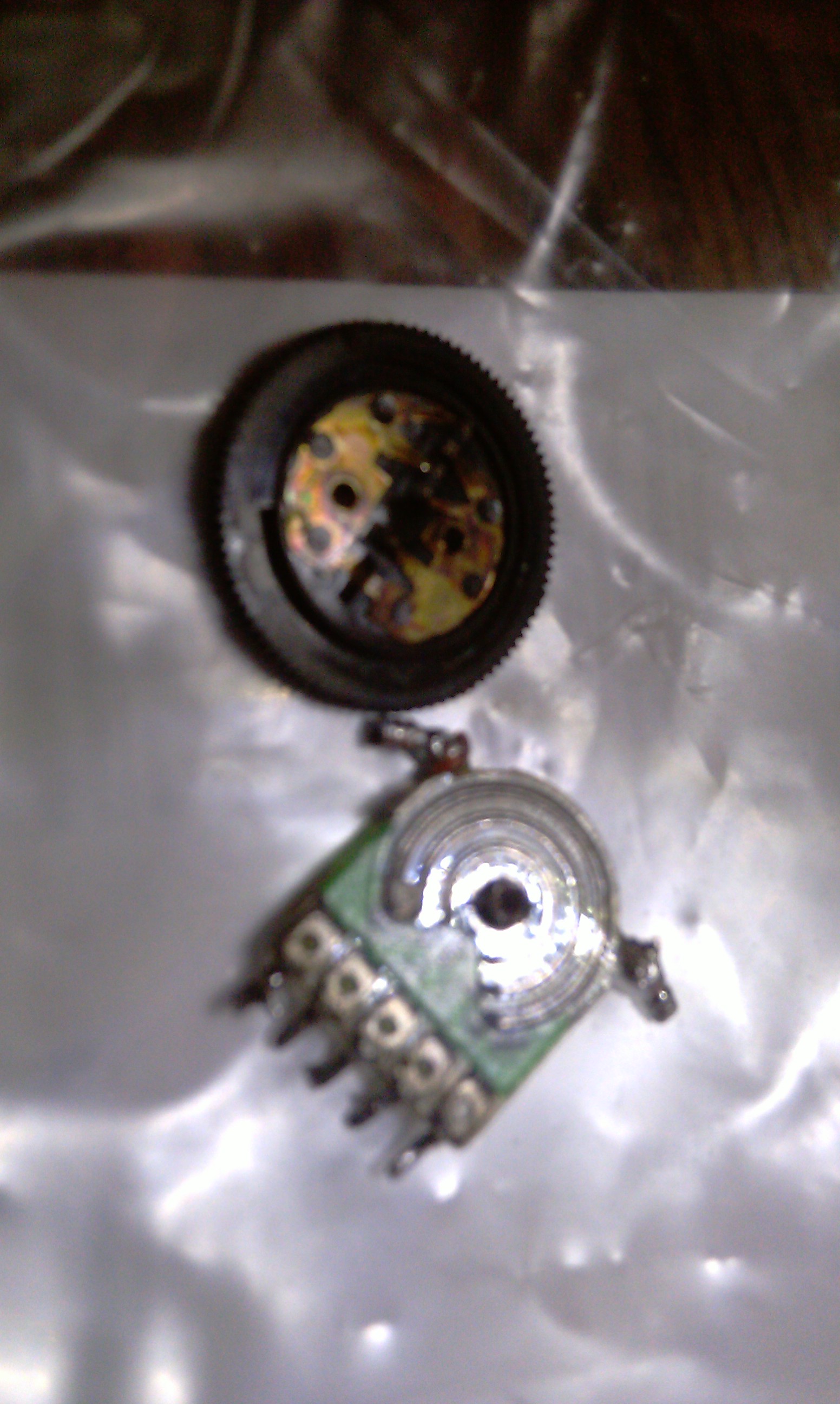

Here's what a average one looks like, notice the conductor is brown / black from all the capacitor damage and the base has missing carbon.
As soon as I recapped the volume increased a lot but the potentiometers are quite noisy when you move them and seeing your photo let me only hope to recive the new ones ASAP :D

And again as @Hammy suggested after recapping the board is highly suggested to change potentiometers as they hide a lot of rust

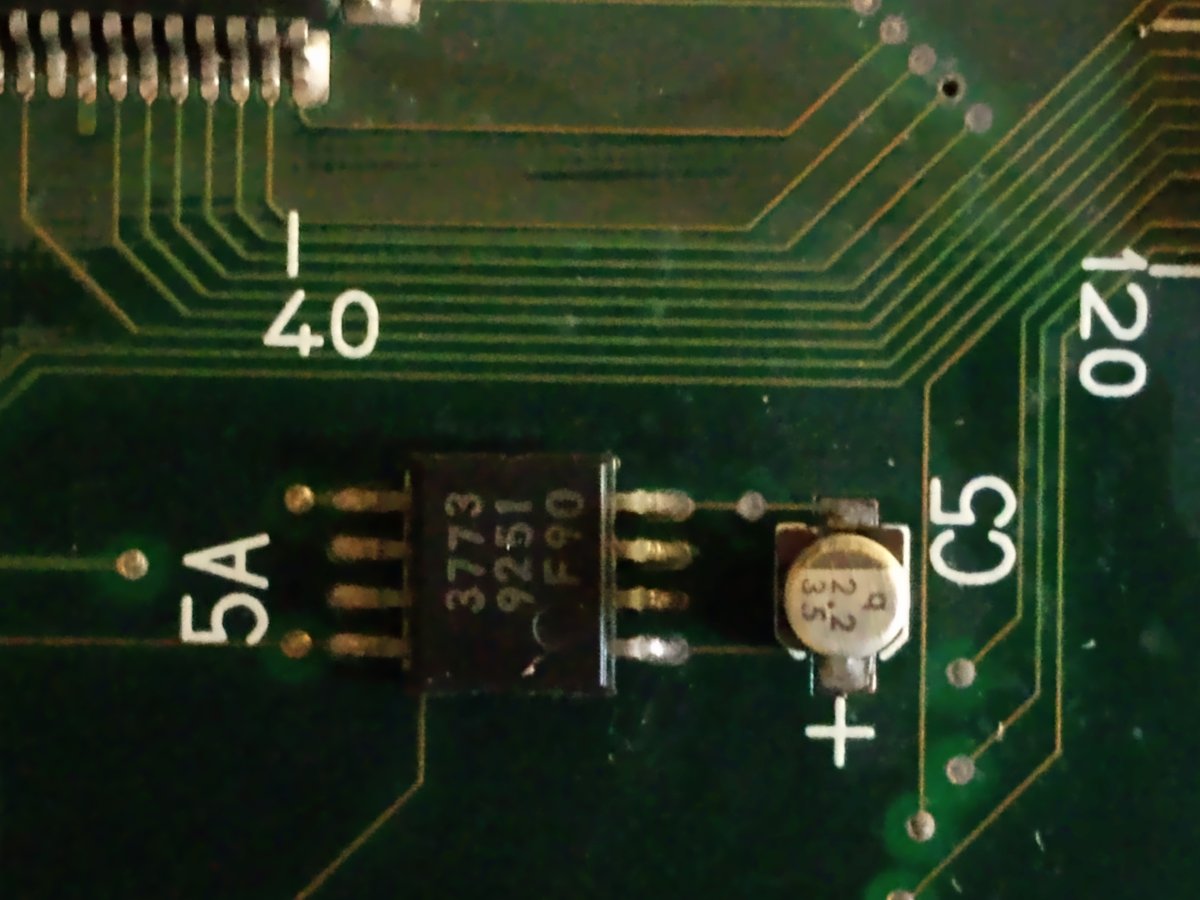

Hi all I'm late to the party.
I got a NA-2 type pcb that is Numan Athletics that I've not used for years when it was working fine.
When i finally got a chance to play it, it did not work at all, does not boot and sometimes i get a full blank green, black, and blue when i fire it on. By research here it seems that the possible problem is the MB3773 "Watch Dog Chip?" or the 2.2 uf 35v capacitor.
I ordered both parts just in case and i really want the game to work again as it did back then. So strange that it was dead even when i take excellent care of my jamma games...
yeah that C5 looks toast.
you should REALLY consider re-capping the whole board. No matter how well you "take care" of these boards the original capacitors WILL LEAK and WILL eventually destroy traces to the point where the board is irreparable. the only way to avoid this is to remove the shitty old caps, clean all the garbage residue off of the board and install good new caps.
I've owned about 15 Namco NA boards and literally literally 100% of them I've had to recap as all of them eventually stopped working and had deteriorated audio. It's way worse than another other system board I've ever had. the good news is that all but ONE of those 15 boards I was able to revive back to like new function. So if you catch it early enough it can be saved.
