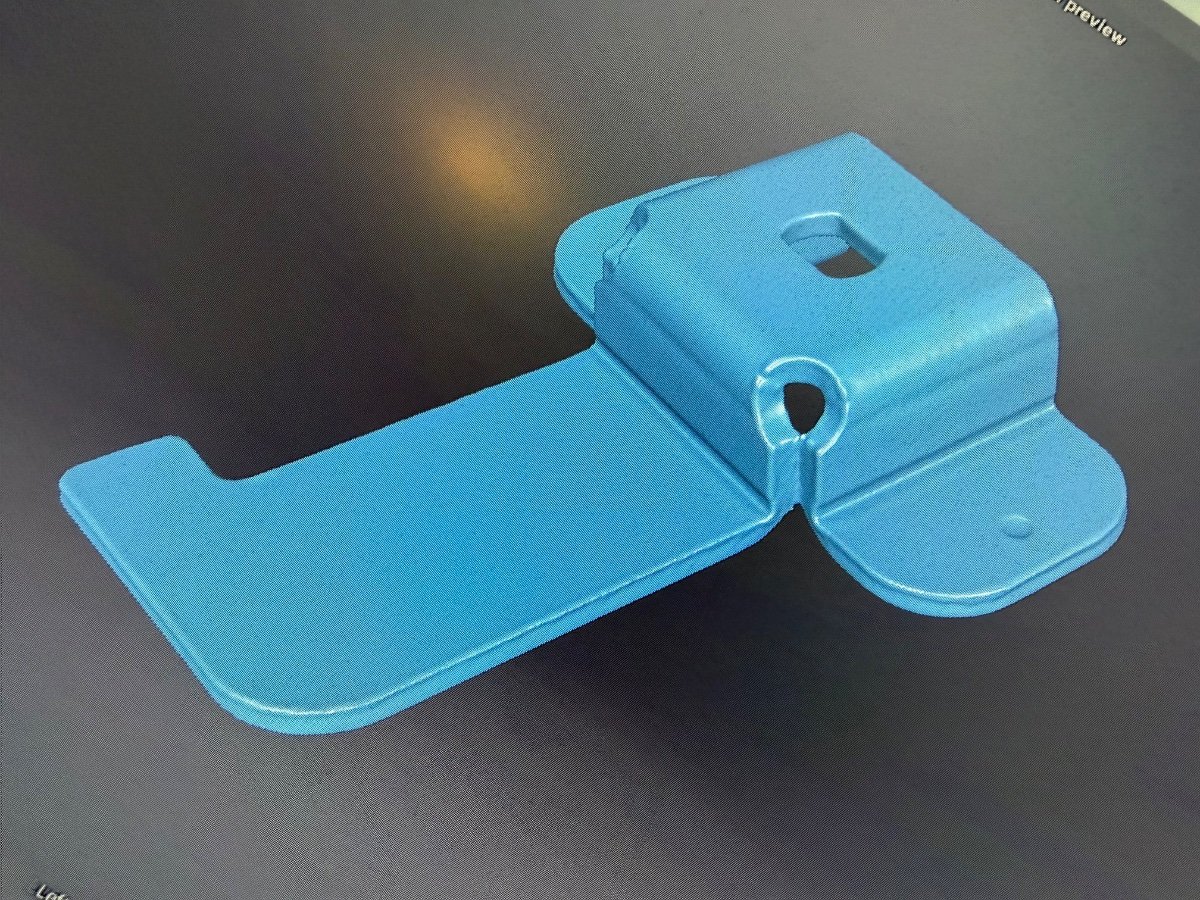

I can make it in fusion 3D if needed so you can print . If made out of abs it should hold perfect in home environment
@AMS - it’s been a while man! Hope you’re doing well.
Sure. I would love that. It’s for personal use only at home, so 3d print would do just fine. I’m assuming it just connects to a standard barrel lock?

Yeah it will just snap on the normal lock then . Give me a few days and I’ll post the file here :-)

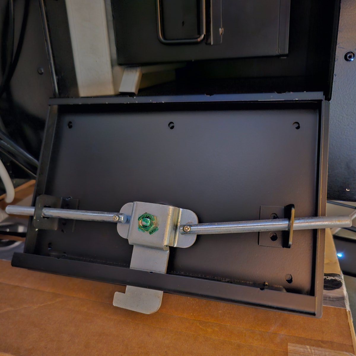

@djsheep exact 1:1
I made punch holes if you ever want to install the rods .
Just print and install and you are all set
Will upload the file to you via PM as it won’t let me upload it here

Really appreciate this! I will get a mate to print it and when installed I report back to this thread. Legend.

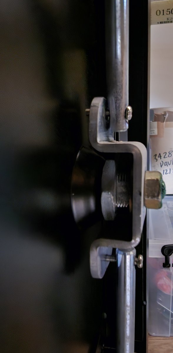

Thank you @jermz1 - I grabbed this. I appreciate you looking out. I had a bit of trouble getting the tang to line up to the locking slot, but a washer in front of the tang piece, just where the end of the lock meets did the trick.
My lock is a MJK branded lock, unsure if it's the original one that came with the machine. Out of curiosity, is there any sort of spacer/washer between your tang piece and the lock? The one I used is a very thin washer but it worked (and reminds me why I keep all these spare screws and crap lying around).
