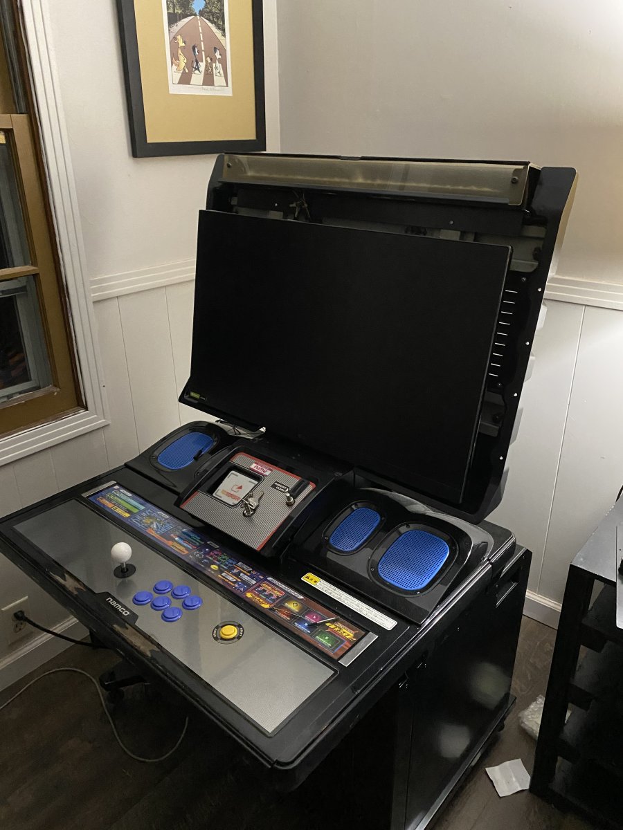

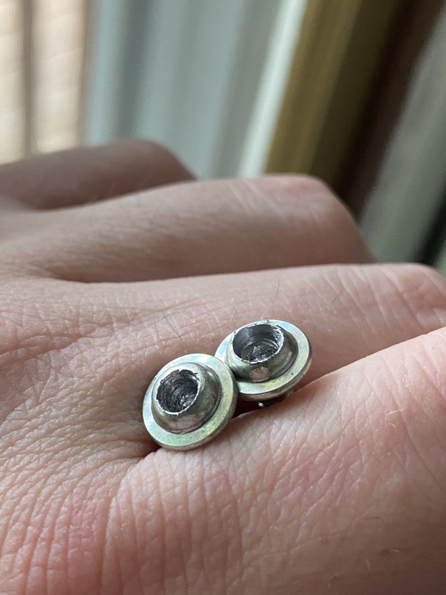

Well, I ordered the screen and it arrived today.. but I have stripped the monitor bolts holding the monitor up top. :thumbdown: I struggled with it for half an hour, ran an extractor through it, then the next size up extractor through it.. no success.
I am surprised how easy it was to get to this point, though. The construction of the monitor as a whole is pretty nice!
I saw in another thread a recommendation of these "vampliers", so I ordered a pair of those and i'm going to give it a shot when they arrive on Wednesday. What a bummer!

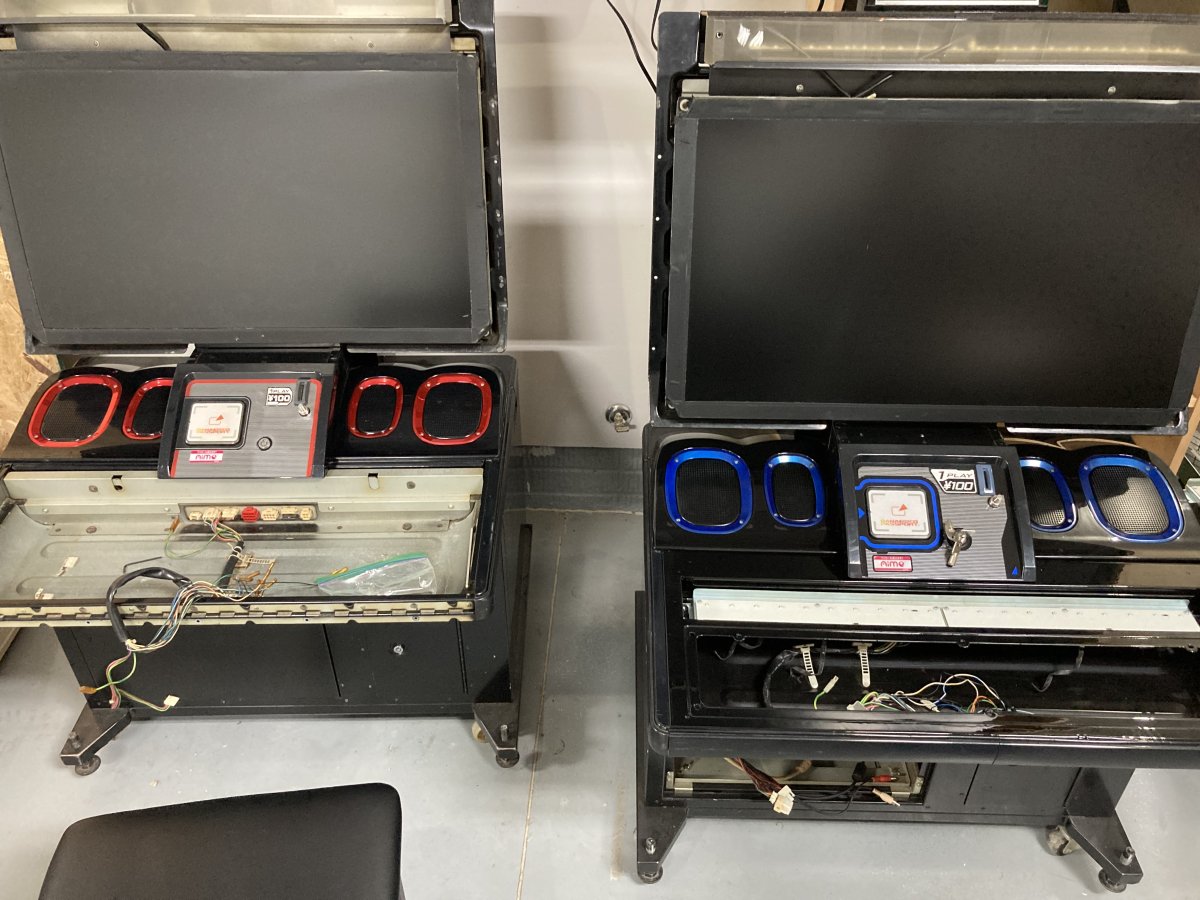

Weird your Noir has red decal on the centre with Blue speakers, my noir has red speakers and blue decal… Is that correct?
In regards to the access panel? I'm not sure actually, I hadn't noticed it.
Now that i'm looking in google though, good catch! Someone must have swapped my panel out at some point.

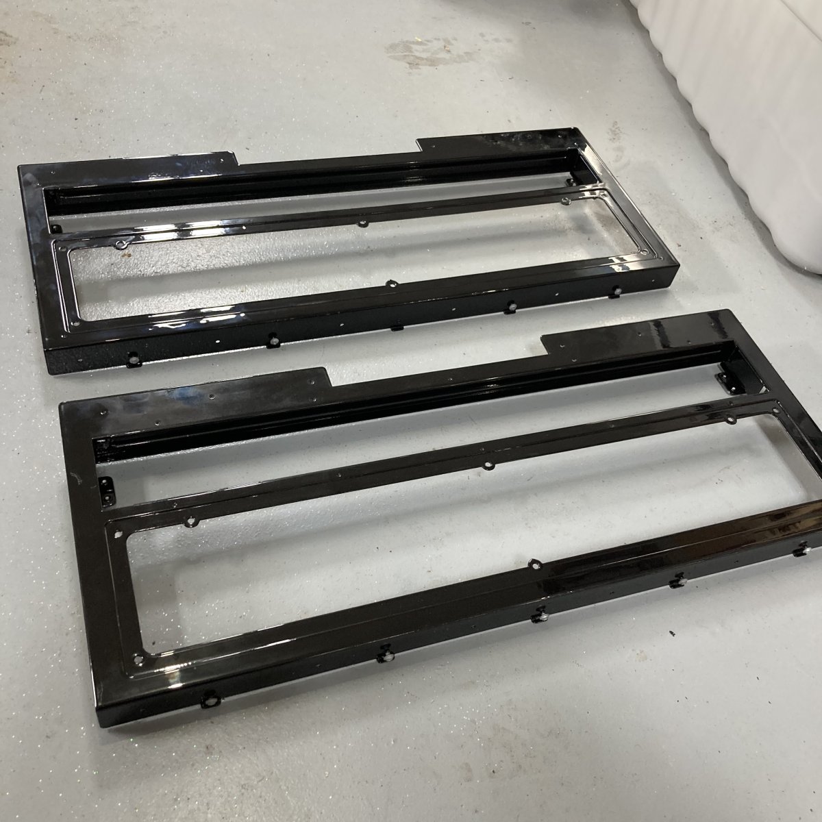

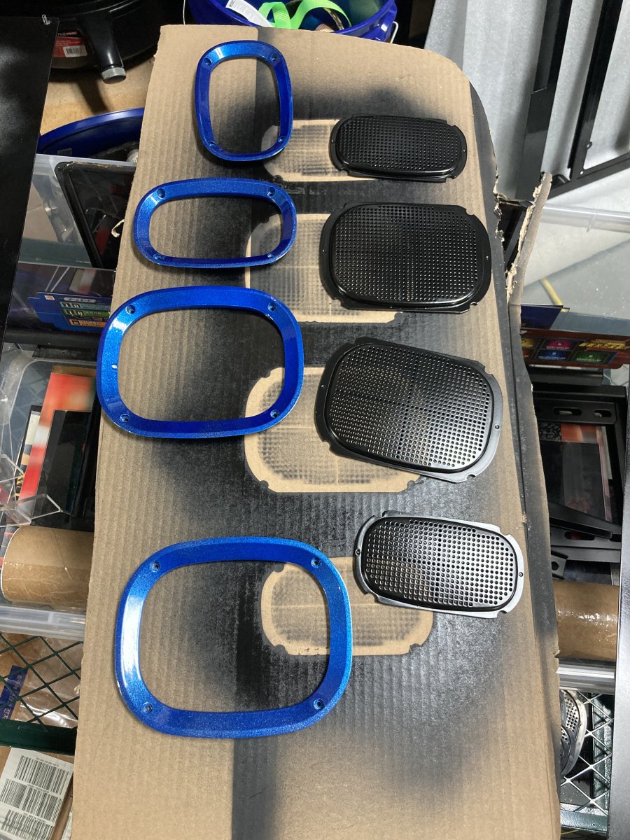

Nice - Here are my results from restoring the panels and getting rid of that ugly color scheme.
Funny you say that - i've been thinking the whole time.. why the heck did they go with light blue!?
I think the center grille being blue actually works, still, but a dark blue like what you used would be so much better.
The grille is screaming for a faint blue backlighting too, imo.

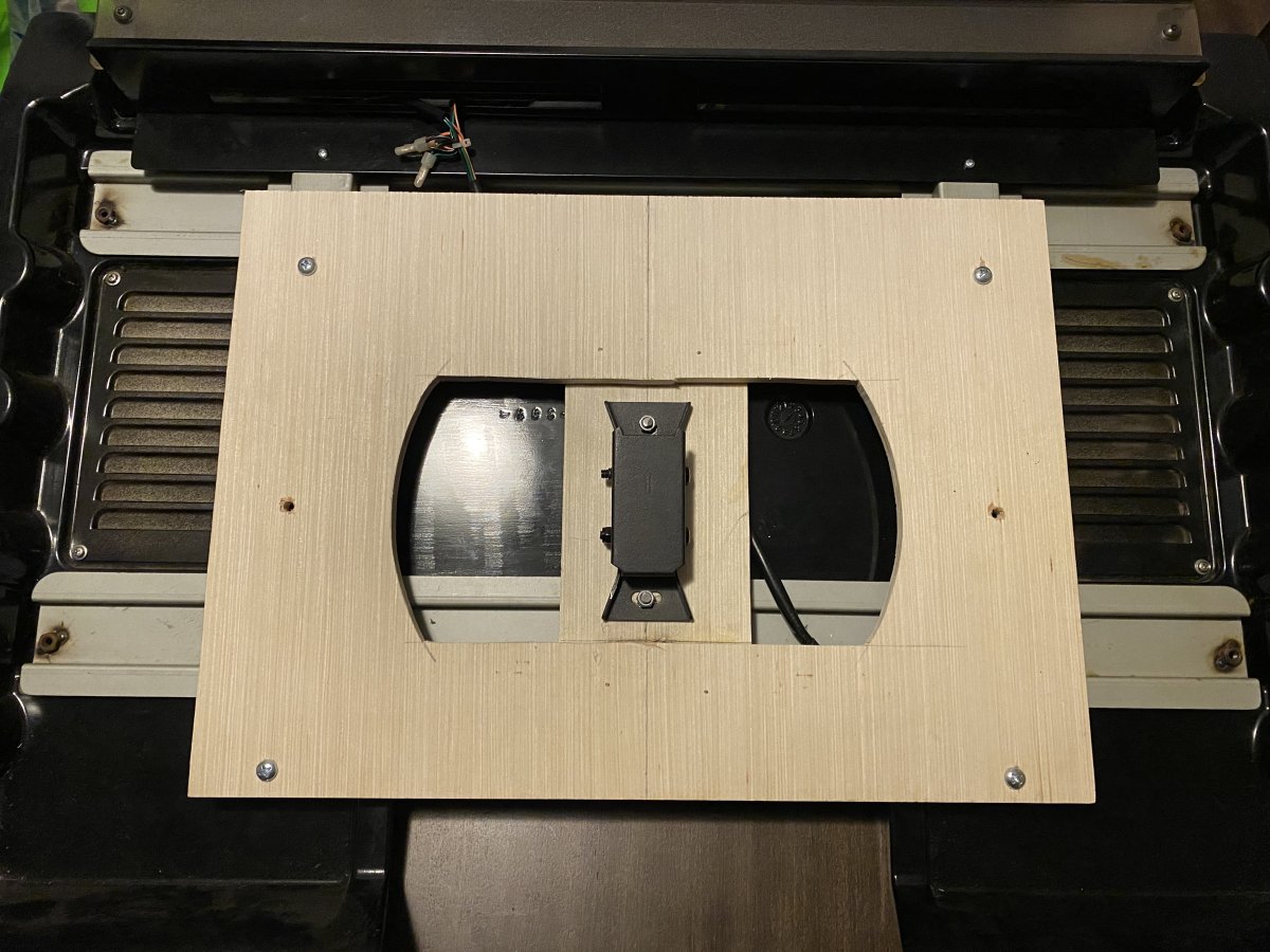

I managed to get the two bolts out that hold the light bar strip up top and run through the monitor railing. Man what a pain that was, but I didn't reach the drill and tap it stage yet, so i'll call that a success.

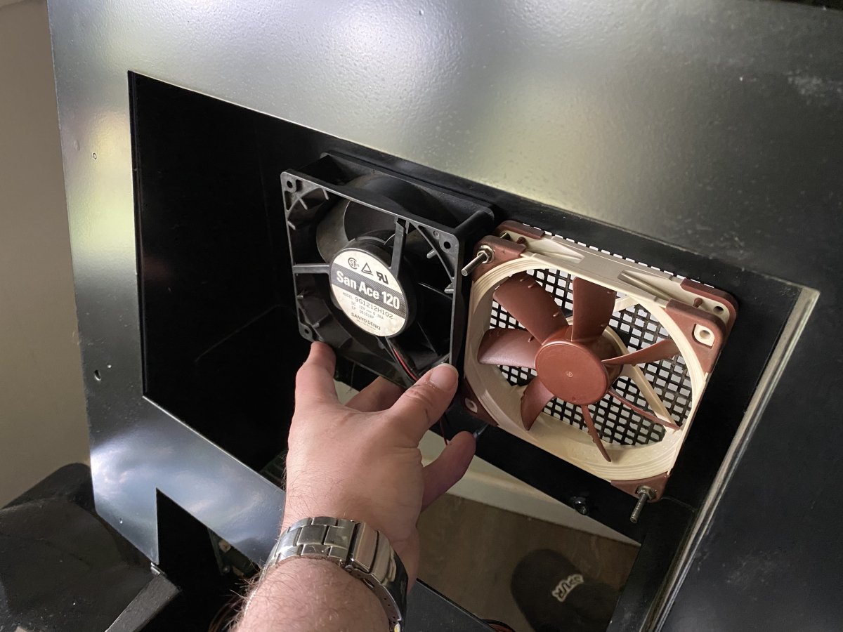

Ordered a 120mm noctua to swap in the rear while i've got the machine totally apart. Going to swap that in when it arrives tomorrow.

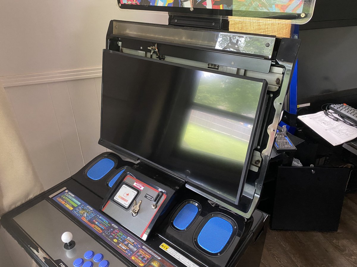

Going today after work to my dads shop to make a bracket to hold the monitor, i've got a cheap amazon wall vesa mount showing up today and i'm just going to mount a board and then mount the wall mount. I think there should be more than enough clearance and it'll be a really solid setup. Only wish I ordered that fan a little sooner to get it all back together quicker!

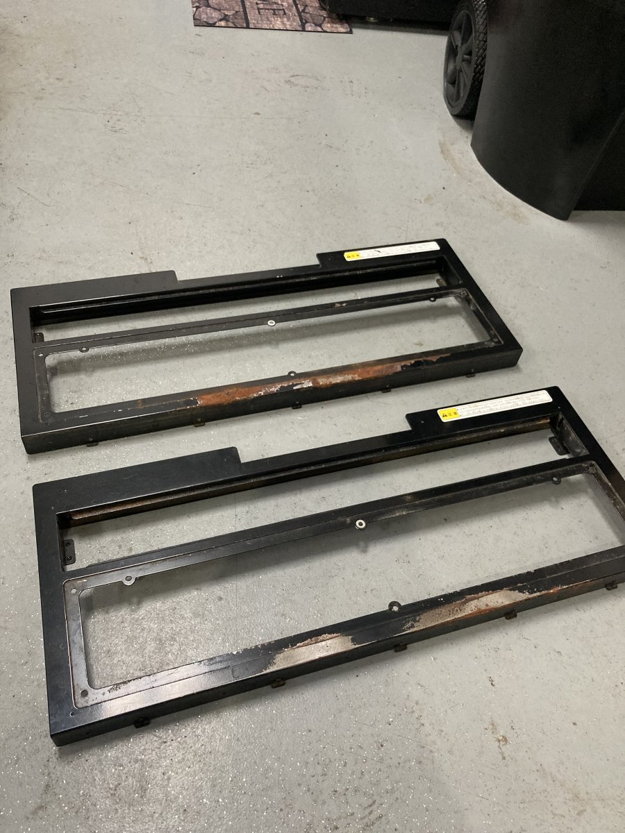

I meant to ask - your control panel metal overlay, did you do this refurb with paint or did you have the powdercoat redone? There's a powdercoat shop at the end of my street.. I haven't inquired with him about prices yet, but that seems like I should definitely go that route.
Proper powder coat. I think I only paid $20/panel? They were so rusted they were badly pitted and they had to grind them a bit to make it smooth again. Pretty big manufacturing flaw IMO.
Whaaaat. Okay. I expected a tremendously higher cost, maybe $100 a pop. It sounds like I need to definitely seek that out!
Yeah, the person I bought my cabs from was telling me that the rust by the wrist was super common as well.
Wow, that sounds a bargain, was that also to remove the old coating?
Mine could do with being recoated as a previous owner has sprayed with black paint those areas which wear.

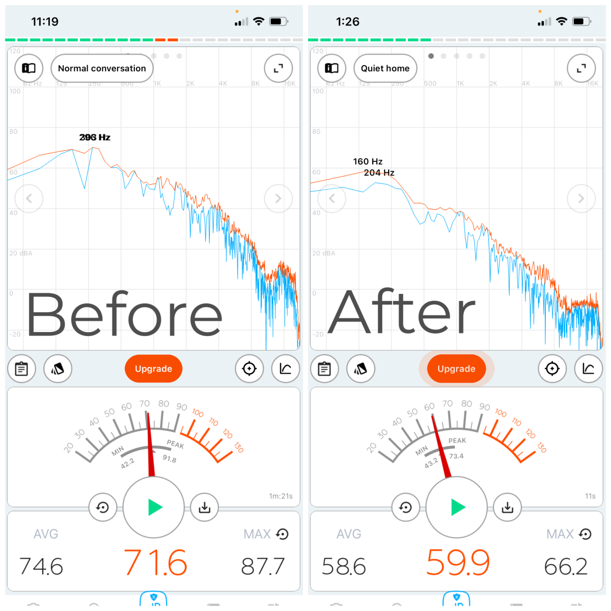

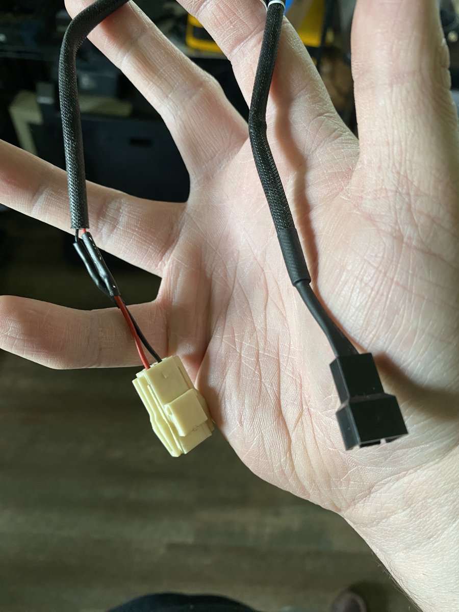

I snipped off the stock fan harness end and soldered in a 3 pin extension so I could use a modern fan. Swapped out the stock for a Noctua 120mm and I can now sit in complete silence. What an upgrade!
Tonight I should have it all back together with a sparkly new monitor and newfound silence.
