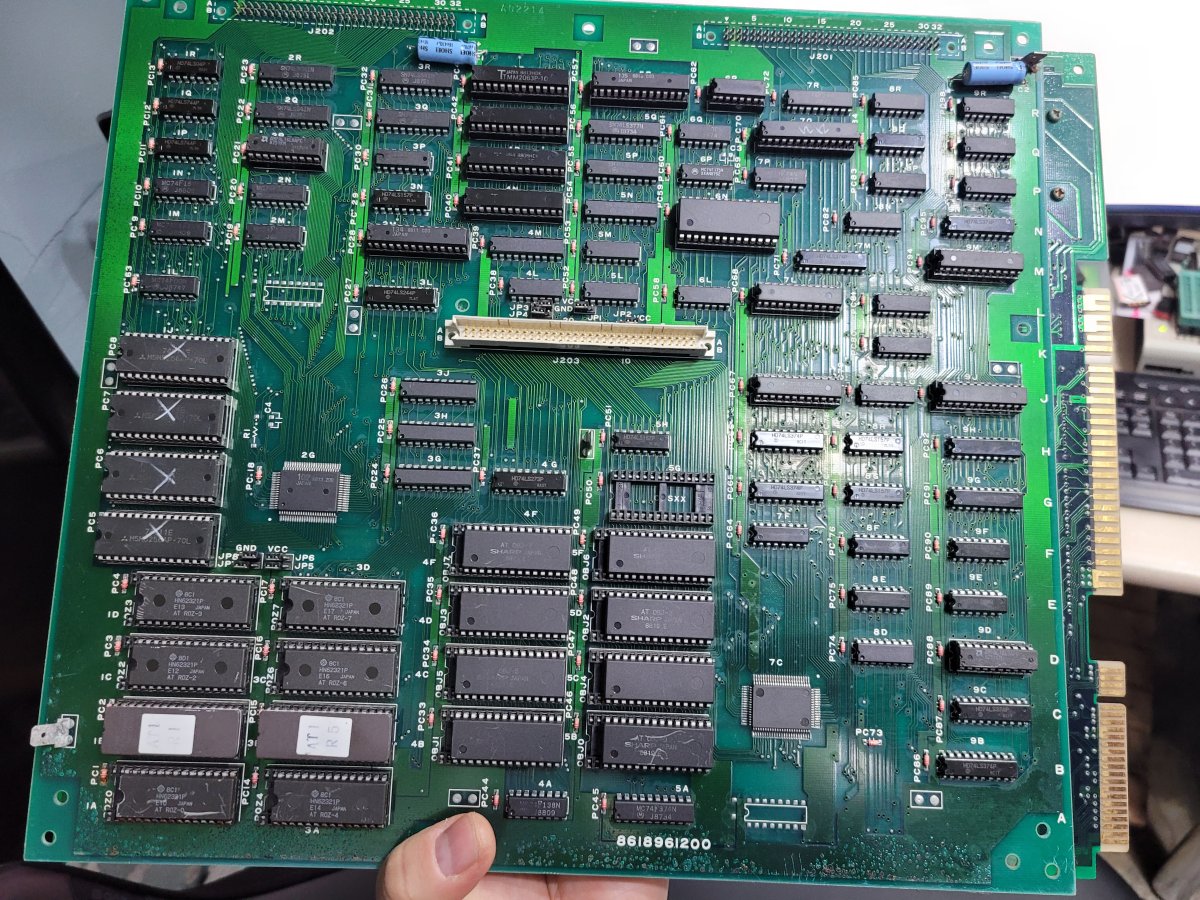

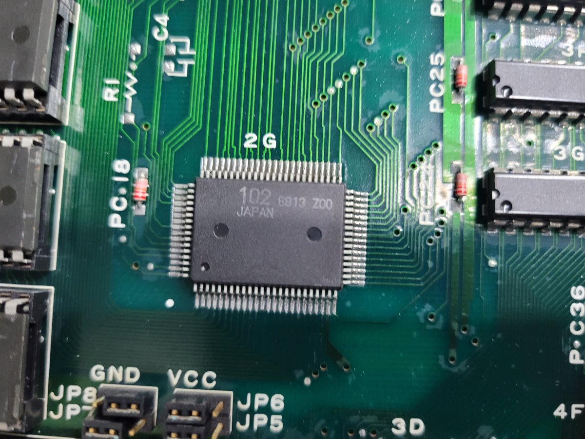

for everybody who will look for donors …
try to avoid Super World Stadium 92 . Why ? because this set , even have CUS102 , isnt used by this game and if this is faulty , you will dont know .
Super World Stadium 93 is good donor too, beside rest of the titles ✌🏻
Or if you want to risk , get one set (super world stadium 92) , try to convert in a game title that multi will support it and you will see from there if everything is good or not .
Namco system 2 rom board.
102 chip

@AlxUnderBase I was under the impression the Darksoft list above were the suitable donors. I'm guessing that's just a list of desirable games on the multi, and all the sports titles are also suitable donors?

  • Assault
  • Assault Plus
  • Bubble Trouble: Golly! Ghost! 2
  • Burning Force
  • Cosmo Gang - The Video
  • Dirt Fox
  • Dragon Saber
  • Gholly Ghost
  • Finest Hour
  • Kyuukai Douchuuki
  • Marvel Land
  • Mirai Ninja
  • Ordyne
  • Phelios
  • Rolling Thunder 2
  • Legend of the Valkyrie
  • Super World Stadium
  • Super World Stadium 92 (but here i wrote in previous message what is needed to do to be sure you have a good donor)
  • Super World Stadium 93
Rest of Namco System 2 games arent good donors and the games from multi will be same as donors ones mentioned ✌🏻 :happy:

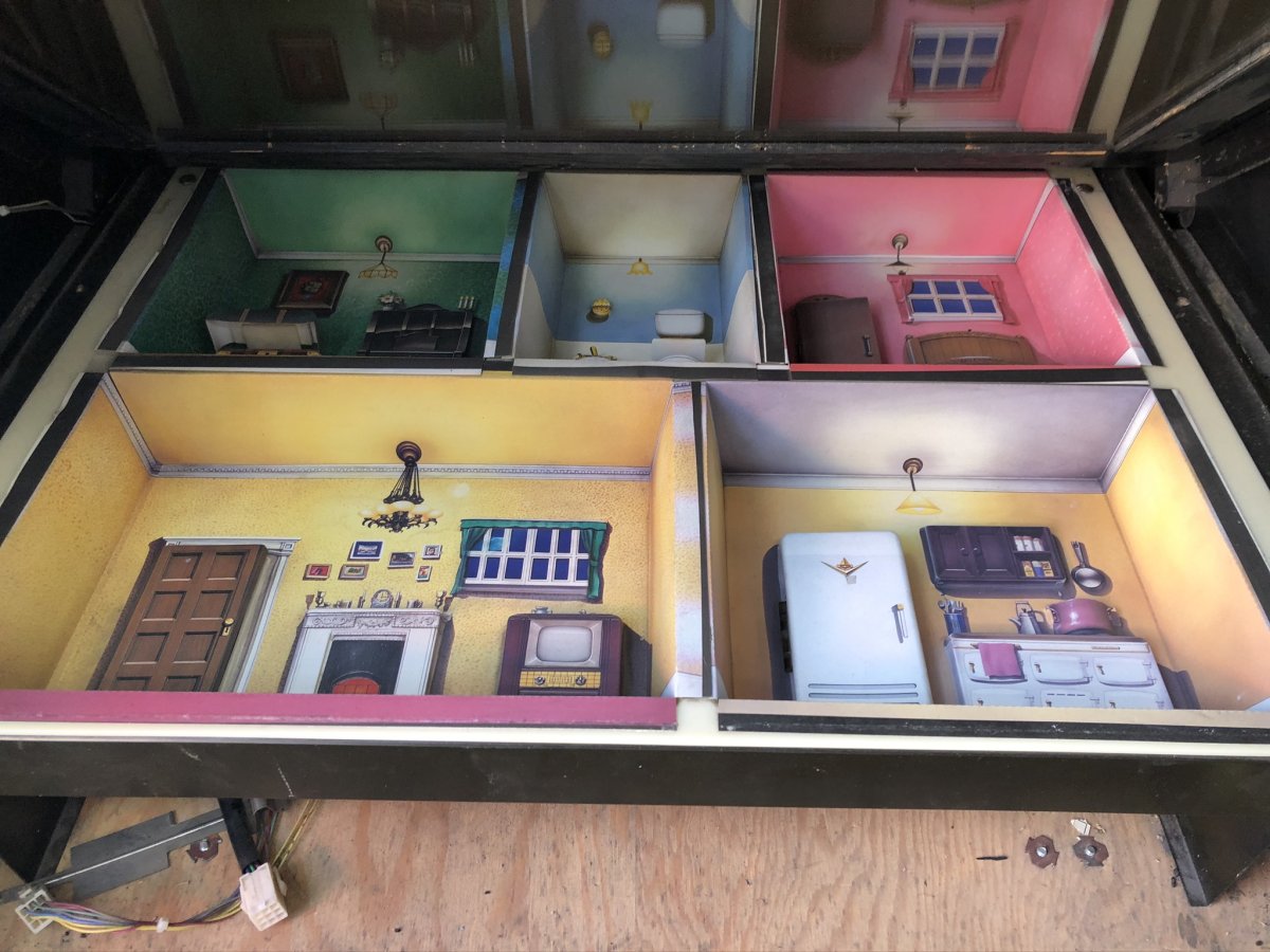

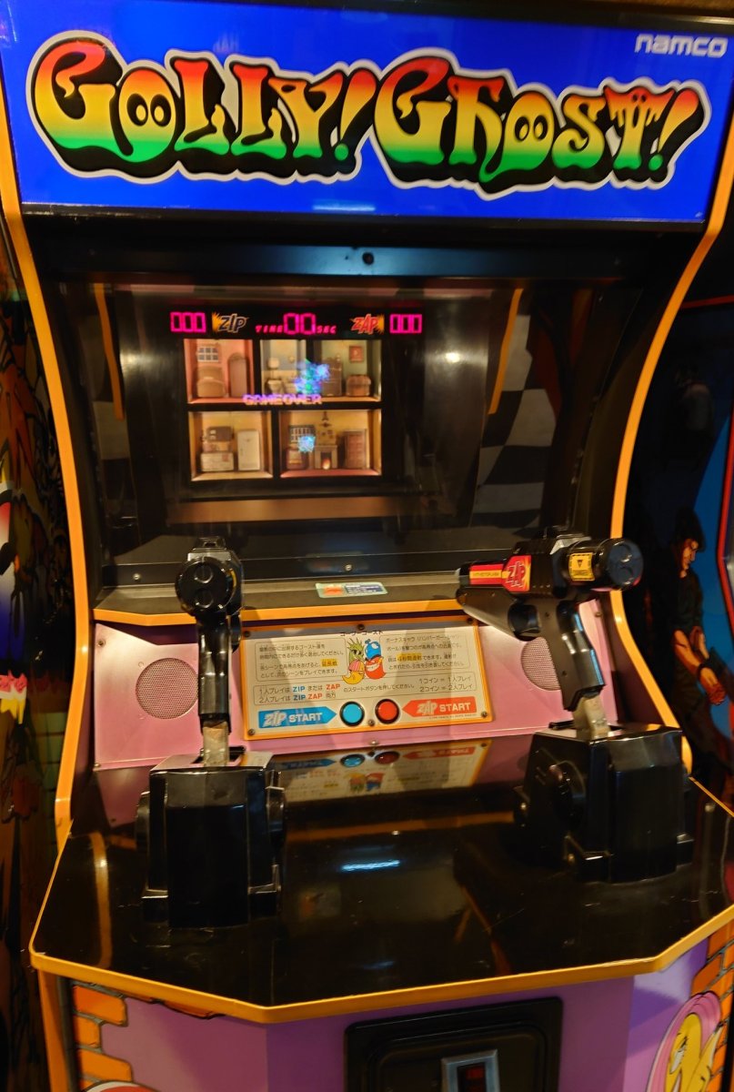

Golly Ghost
Golly Ghost uses an electro-mechanical underlay on the screen it looks like this:
there is a split mirror in front of it and the CRT overlays the ghosts, and the game actually controls movement on this underlay. not to mention I think this game also uses a separate display for the score.
The game will "play" but without all of the original supporting hardware it's not going to be worth playing at all.
Bubble Trouble works the exact same way, so that game is also out.
