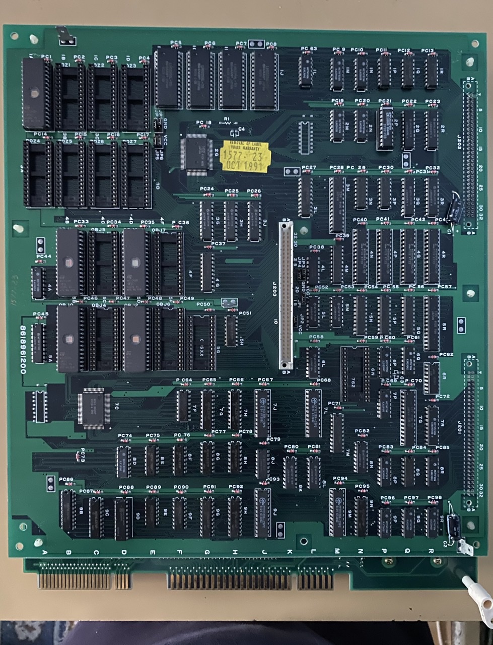

This is the Video PCB
The PCB is relatively simple, it consists of mostly TTL logic, some RAM, and two Namco Customs. The customs are the hurdle here. There's the 102 that controls ROZ ROMs memory access control and the 146 which controls the OBJ ROMs (line buf steering according to MAME)
If Darksoft can successfully reverse engineer these two customs and reproduce the entire video board then I think a Namco System 2 multi would be a great product. Imagine buying out all the useless Final Laps, Suzuka and Four Trax PCBs and making something useful out of them. The downside here is that the multi would probably be very expensive to produce. You still have to come up with multi ROMs that go on the CPU board as well. The upside is not having to hunt down and sacrifice the extremely rare and expensive original video PCBs.
