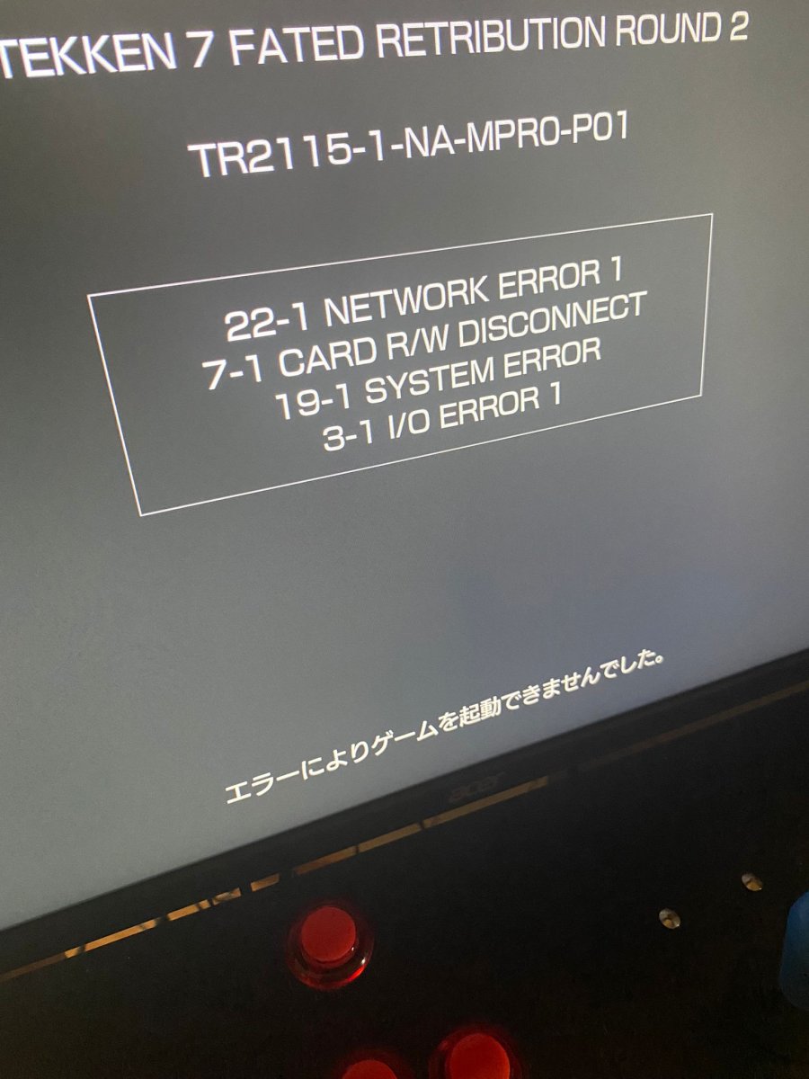

Hi, what 19-1 SYSTEM ERROR is referring to ?
Any will fix that or do I need specific one? Or is any way to bypass that?
You need the original dongle from Namco. I think you know very well that we don't allow talks about bypassing security on newer systems, right?
What I meant is the dongle assigned to the unit or if I will get other namco dongle for that game will it be good?
