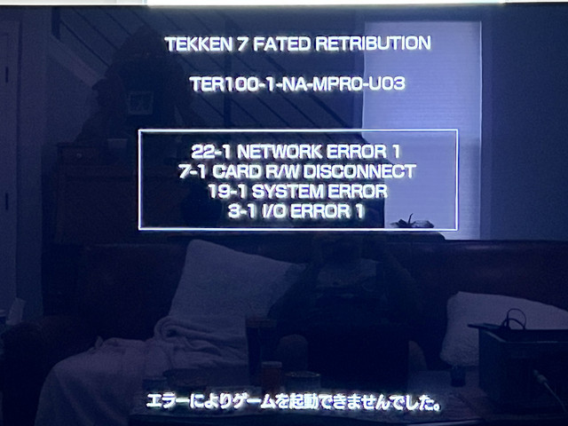

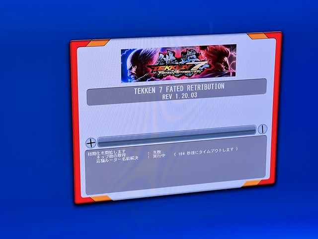

Here is the REV number and then it stops on this black screen. Anyway to progress forward with a keyboard or USB controllers? The USB security stick was also not in for this test.
Sorry, I did move the RAM, but no luck, so I blew out the dust and cleaned the RAM edges and what do you know... it works!
You need to connect a JVS I/O to the JVS port and plug in the dongle. 19-1 SYSTEM ERROR is dongle related ;)

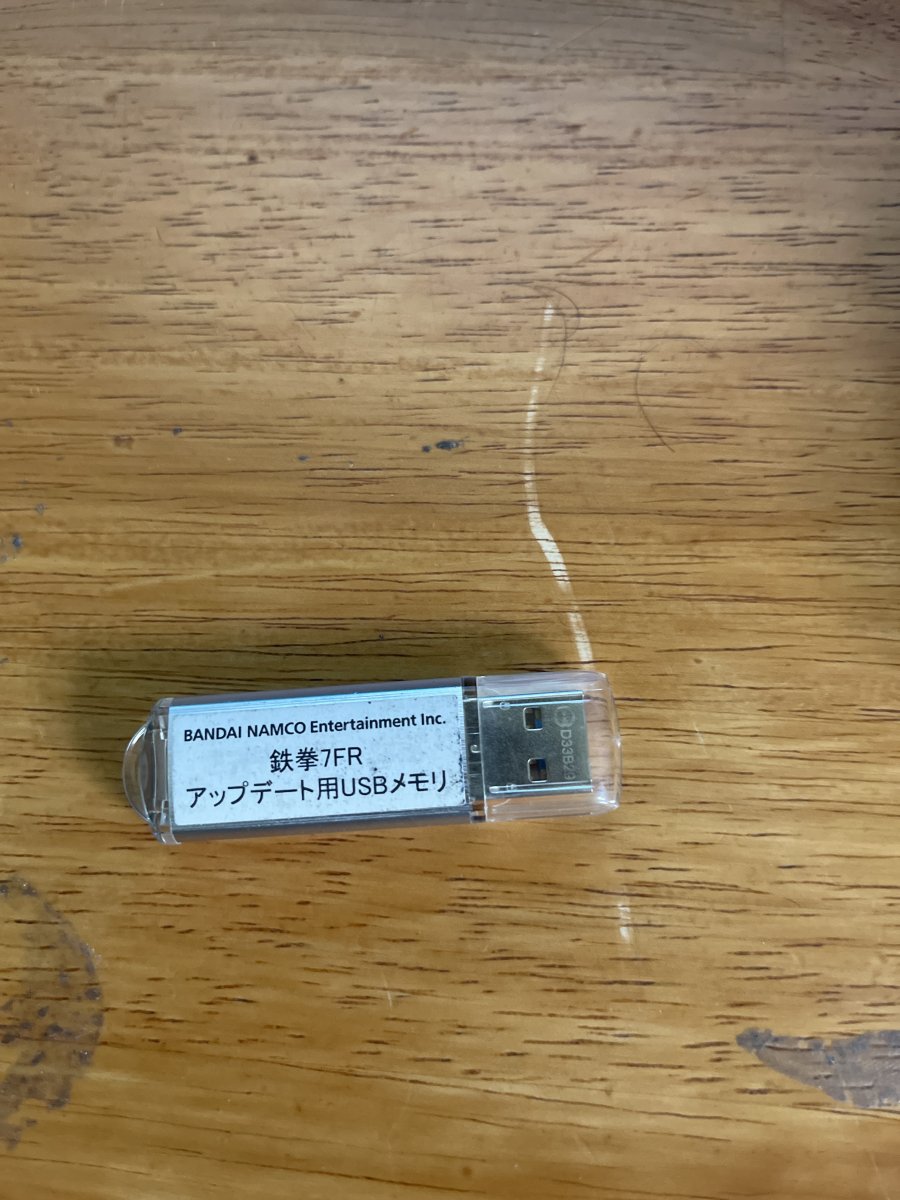

By the way, any idea what the second dongle does? The one with the cap on it in this picture:
https://www.arcade-projects.com/thr...an-you-take-pictures-for-me.26505/post-388670
The second dongle is an update dongle, I actually have one likes yours and it’s a Tekken 7 FR update dongle. You technically don’t need it as it probably contains an older version of the game VHD inside.
