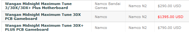

arcade spare parts has these listed: ... yikes hopefully you didn't pay that and if you did, I also would want it working!

Yep I payed the 790 cause I was desperate to get it working, was pretty frustrated to see it still not working. you can see why I don't wanna mess with it now lol. I have a Triforce I'm thinking of throwing in there if I can't get this working, everyone loves Mario Kart.
