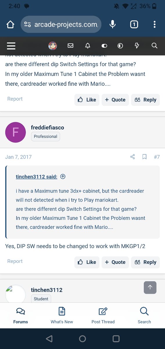

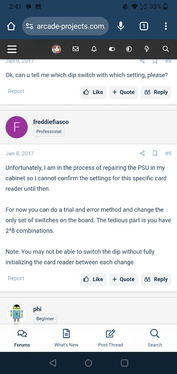

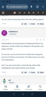

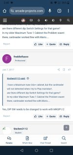

Found this old thread and this guy claims that it's possible but doesn't remember the configuration.
