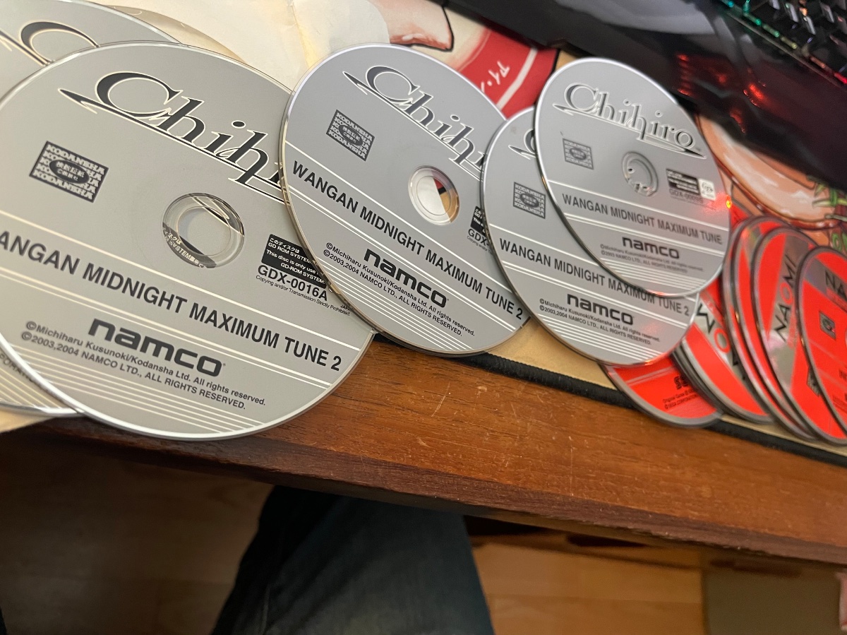

Collecting dust:
No cases for those? 😭 It seems like everyone sells a Chihiro these days with a game already loaded onto it. Even arcade spare parts has the Japanese version of WMMT2 loaded into it. I do have a netboot already with my Triforce with the raspberry Pi and everything, can I take out that same chip in the netdimm board and use it in the Chihiro?

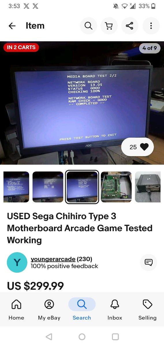

Nvm managed to find one without a game, for some reason it's not being shipped to Canada by default, gonna ask for a quote. This one is saying Japan region, but to my understanding it's pretty easy to switch the region in these things.

No cases for those?
yeah I do have some
yes, here's the info
