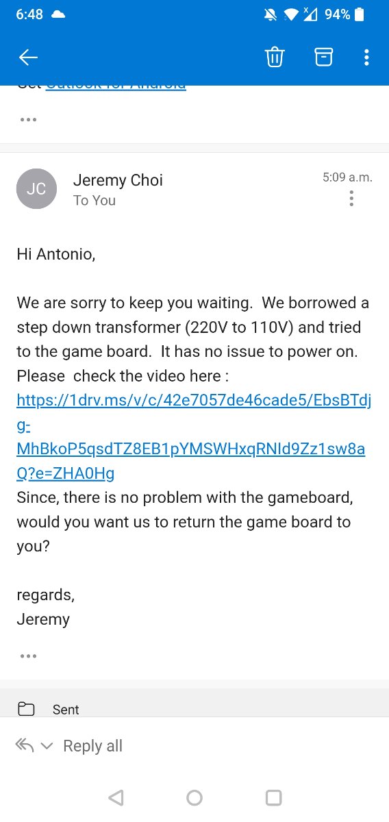

Update on the Namco N2 that I returned that wasn't working for me in the beginning of the thread, so when they received it they claimed it was working for them just fine without changing anything, so I asked that maybe his method of powering it on gave it some extra juice or something that got it to work, but even with them stepping down the power they seem to not be able to get this thing to not work. Which is a bit frustrating since I spent days and couldn't get it to boot up once, I think I'm just gonna ask them to send a different unit back and I'll try my luck on that one.

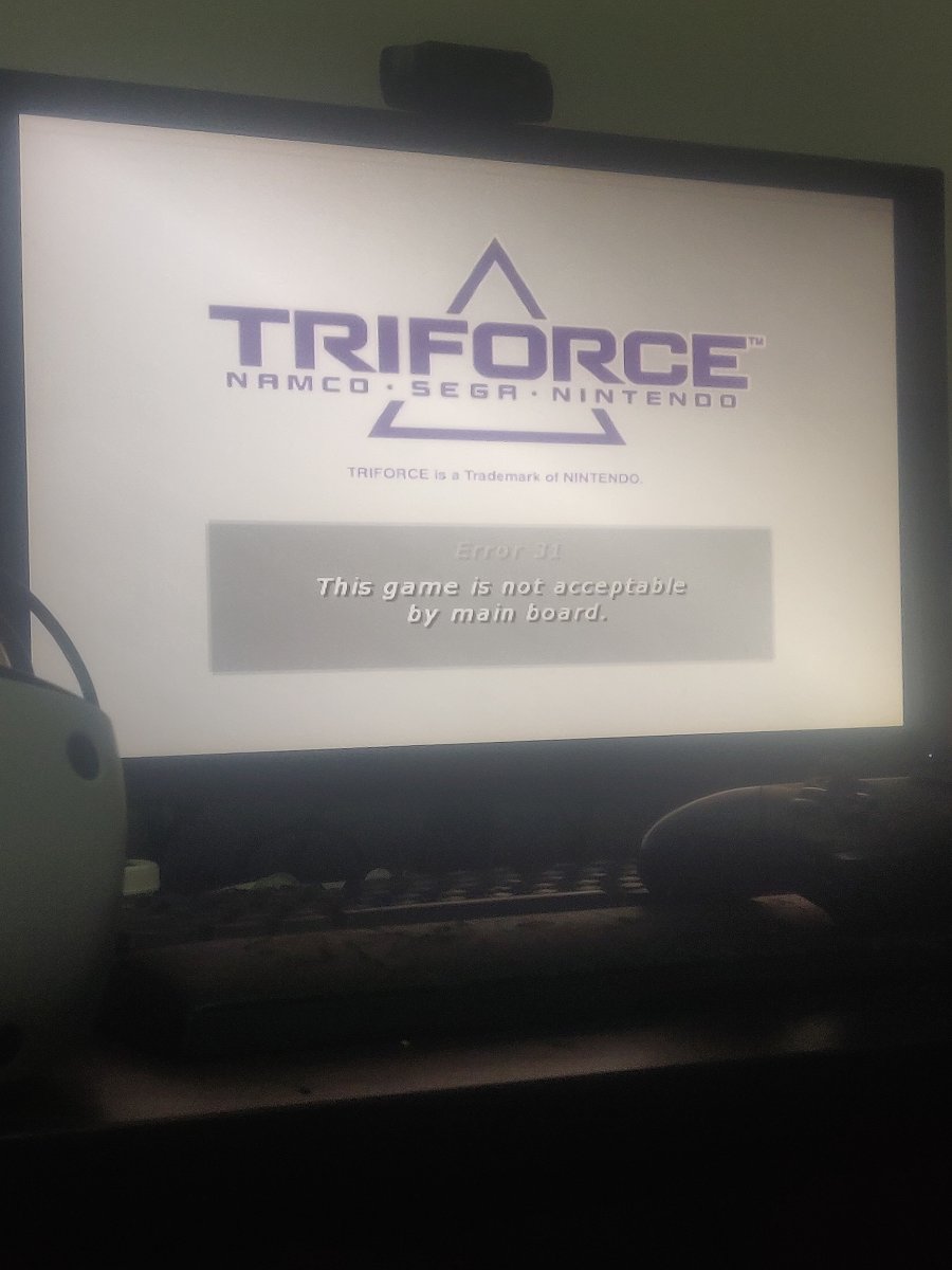

Trying to get the Triforce going and getting an error 31, I'm assuming cause no game is loaded in, so tried using the Piforce I had a guy make for me and it's doing this, isn't it supposed to be showing all the games listed? I never used one of these things before so not sure if I'm supposed to press something or maybe don't have something plugged in properly.

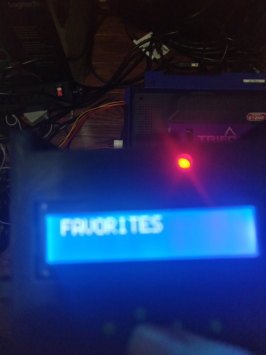

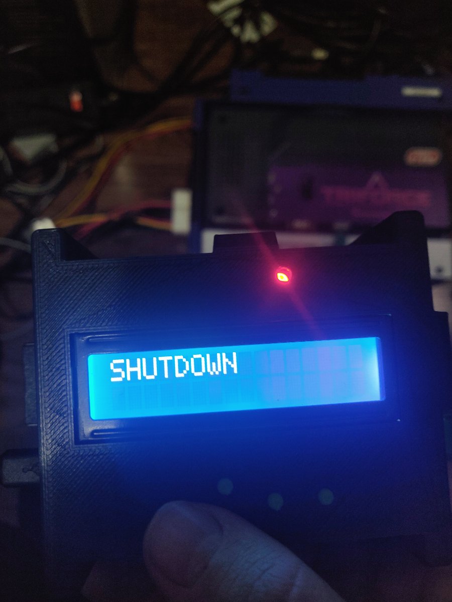

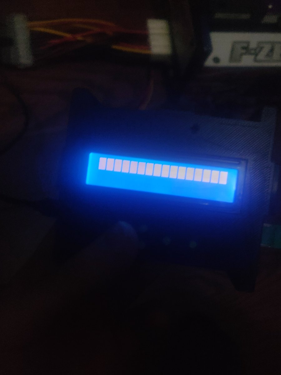

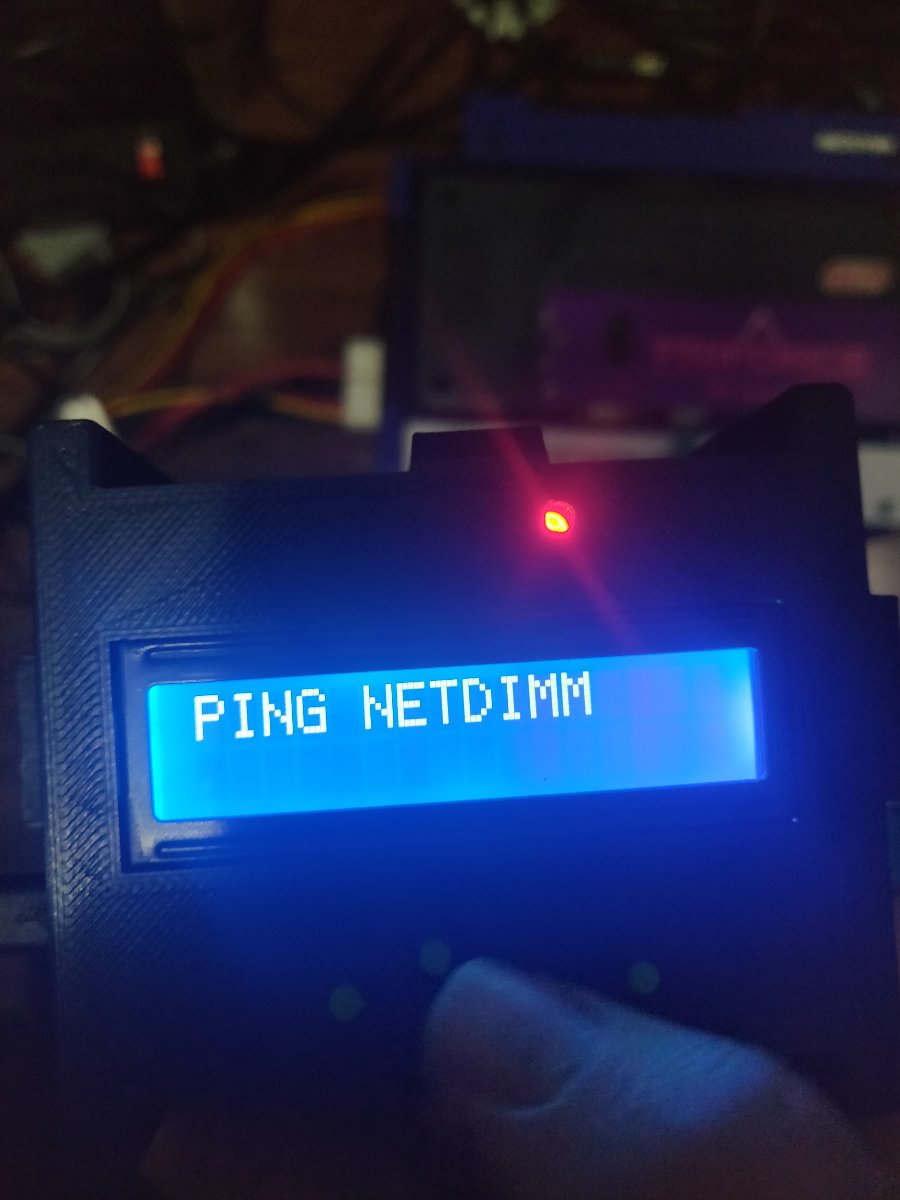

I'm trying to get the Piforce thing working, I flashed the SD card and managed to get it to boot but for some reason I can't get the games or show up on it, just Ping Netdimm, favourites and shutdown. I even tried creating a roms folder in the root of the Boot drive and it still doesn't show any of the games after throwing them in there.
