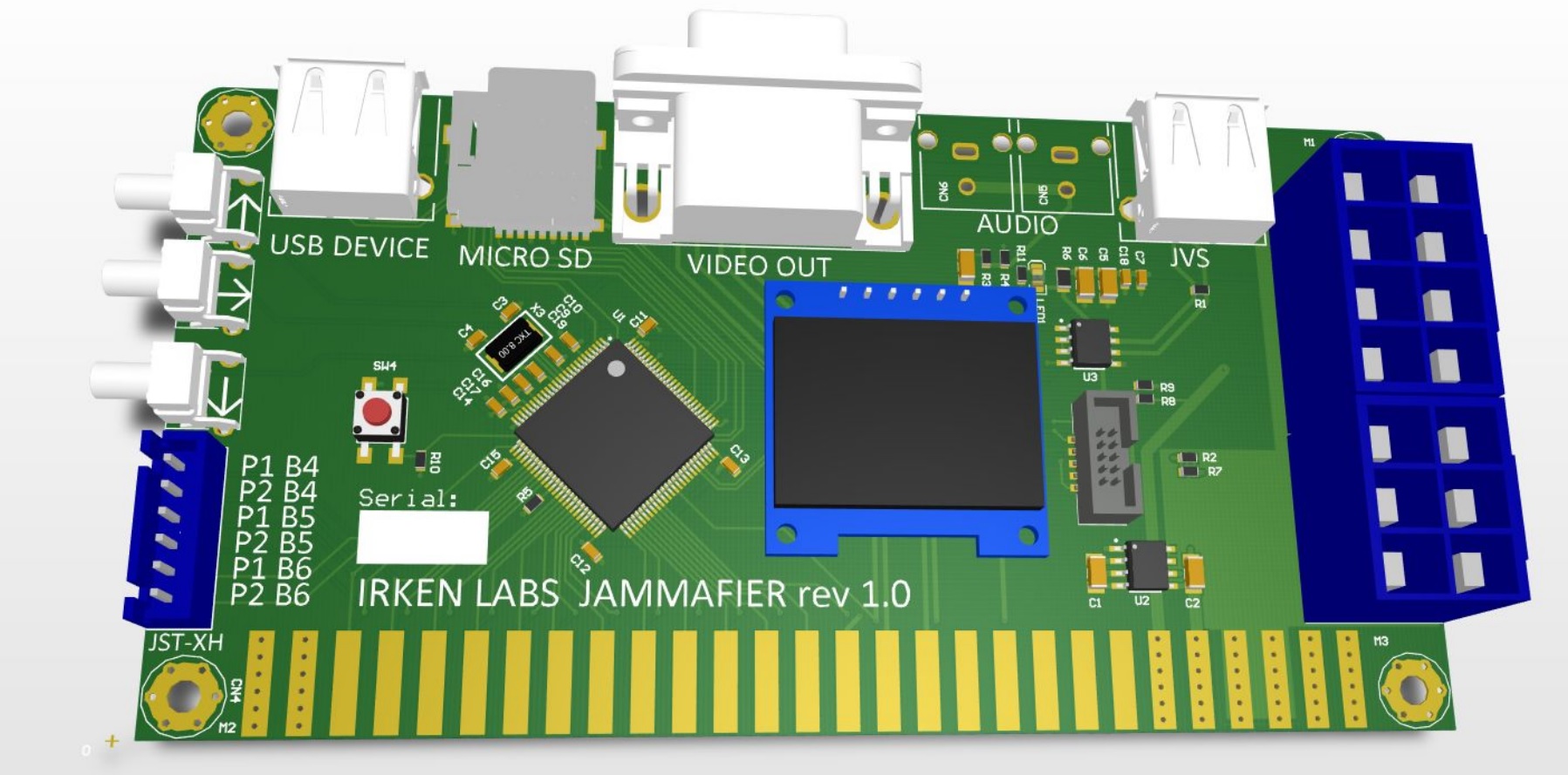

Cool idea. Wondering though what the SDcard slot does there?
Firmware updates + potential for options and config files for oddball setups.

Not sure if/when this will be available, a big hurdle is the cost/feasibility of having if manufactured - the edge connector has to be done by hand, and it as a bunch of through-hole parts. Time will tell, but personally I'm really looking forward to completing this as the available alternatives are not great imho.
Maybe a kit option that leaves the through-hole stuff up to the buyer could work?

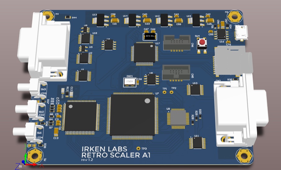

Do you have more info on this please.. what max resolution does it scale to? Is it something like the xrgb2 performance wise but easier to use? what max resolution does it support? Maybe send both units to a member here with time and knowledge to do a proper review?

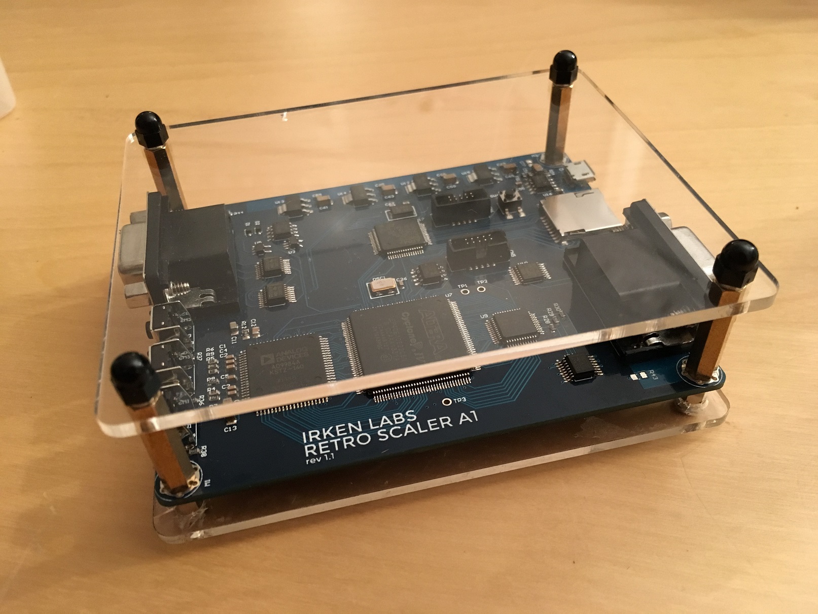

It's very much a work-in-progress, and there have been a few revisions so far. It was started before the OSSC was released, but in nature it's similar in that it's a line-doubler. Making an upscaler is not for the easily discouraged :)
Main difference from the OSSC is:
- Dedicated sync processing input stage to deal with weird sync scenarios (no touch automagic)
- High impedance& Level RGB input / low impedance&level rgb input - selectable
- TTL sync / 0.7V sync - selectable
- 30 Bit analog input
- 30 bit analog output
- Different ADC than the OSSC
- Analog pass-thru, so if sync is e.g. 31k - it will pass it through without alteration
- on-screen display (WIP, haven't actually written the code for this yet)

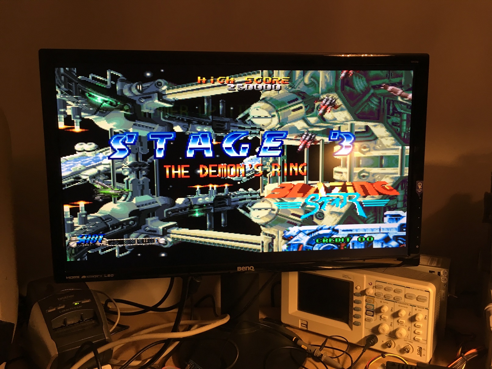

It's really made for CRT's, as an alternative to XRGB2 and the like for 31k CRT's, but with special focus on arcade pcb's. Comparing to XRGB2, this one has a sharper image and is more stable - it CAN look a bit like mame on an LCD, but of course there will be scanlines and whatnot.
I'll probably make a thread once the new revision is assembled and development continues.

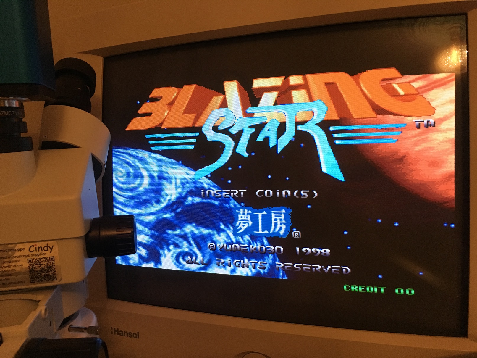

Edit: couple of CRT shots, harder to get a good photo:
